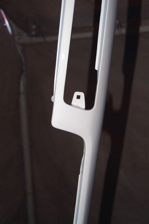

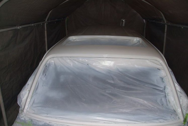

2nd wet coat of clear as the sun set.:clap: I shouldn't have sprayed the basecoat yesterday because the clear had to be applied a maximum of 24hrs later. The clear tonight extended the timer by 3 days. Wetsanding tomorrow. Thank you UB for the tip on the gun. I emptied the tank, cleaned all the filters and as I sprayed the last ounce of clear, water had just started to find it's way to the 2nd filter of 4. The clear went on sooooooooooo smoooooooth.

Looks sweet!
How do you get enough light in that tent to paint?
The full time job takes up most of my daylight. LED headlamps work well and are not an ignition source. You have to hold your head just right to see the pattern though.

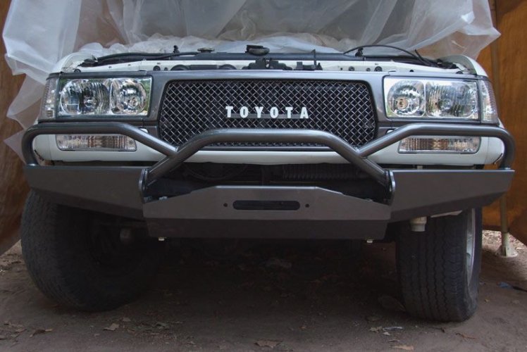

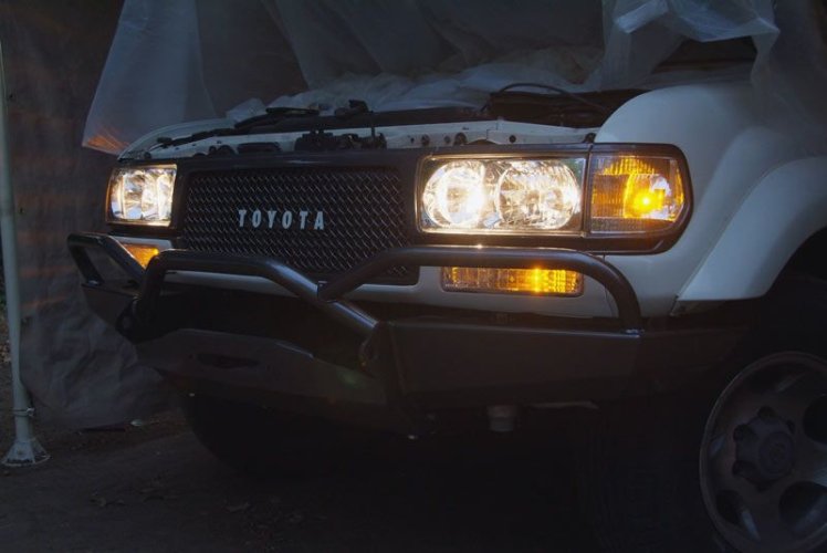

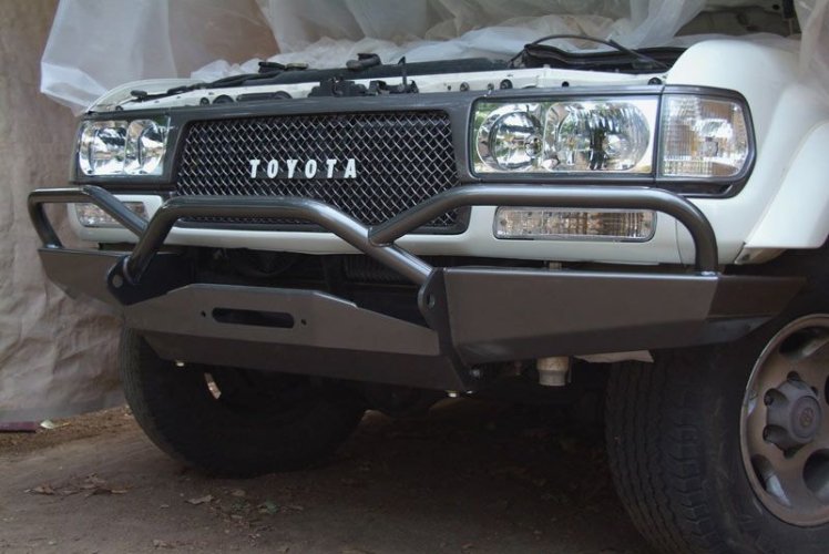

:bowdown:I want to have Christo's children:bowdown: That bumper is sweet!

The Grill and grey bumber look GREAT together....
Too pretty to scratch up in the woods....

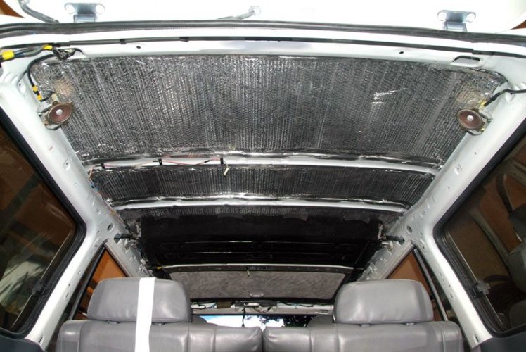

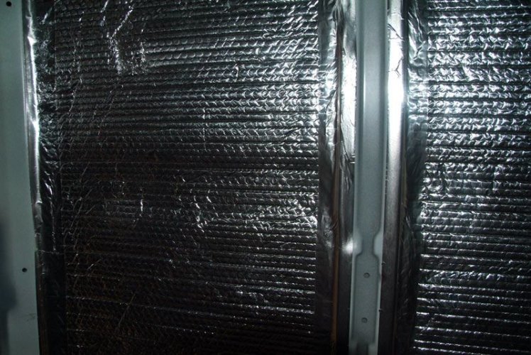

Insulated the roof with some of the reflective bubble wrap looking stuff.

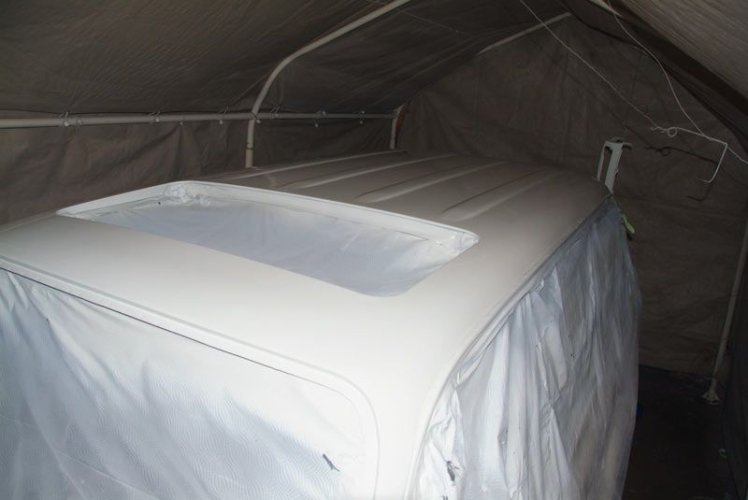

Roof is done

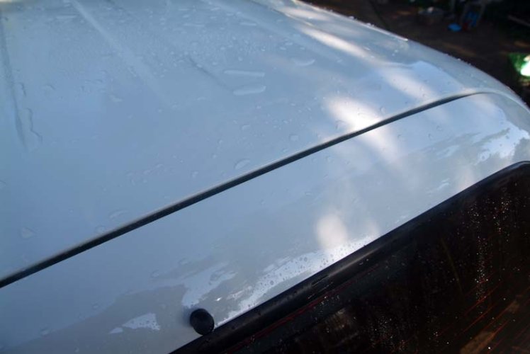

WOW! That sucker is so shiny it looks wet! ;) Awesome job Mike! Wanna do mine?
I would but I am having the darndest time getting these gullwing doors to line up right :mad: :hill:
