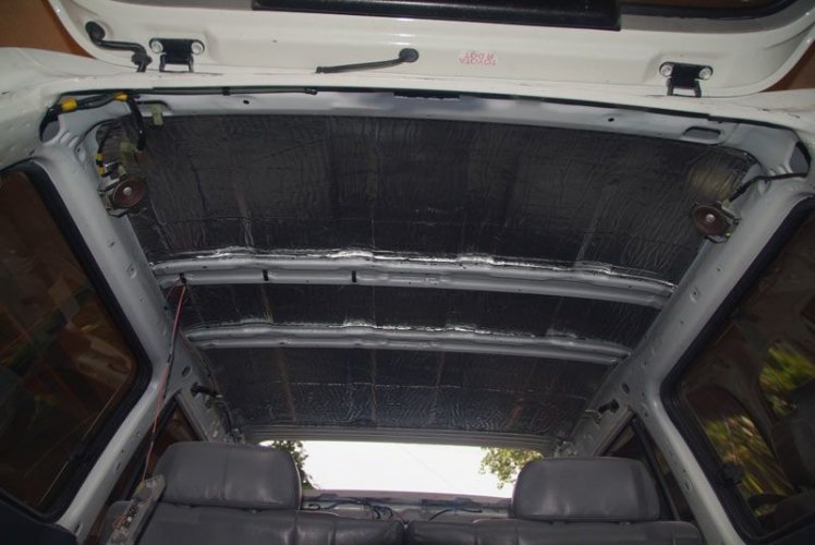

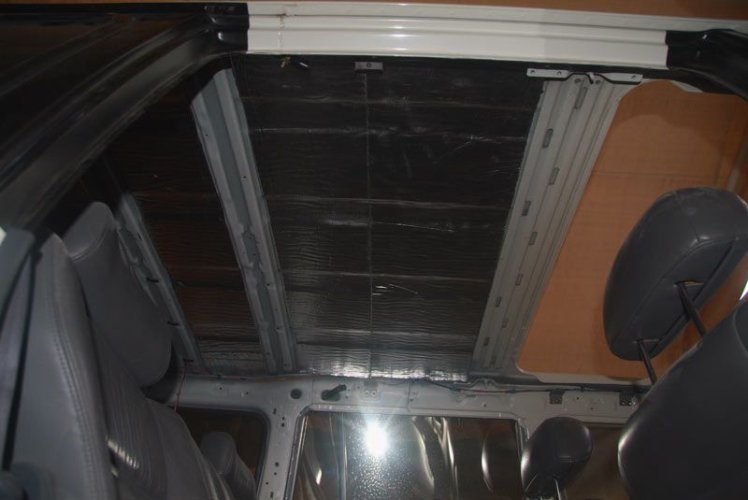

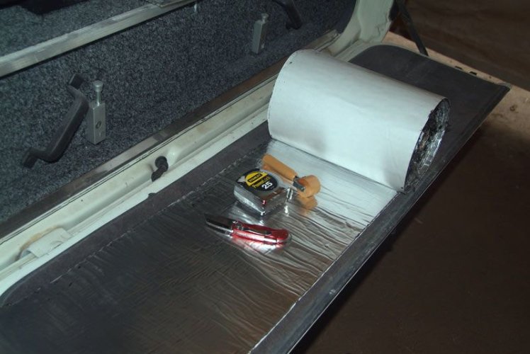

looks cool Mike. How pricey is that stuff, and what kind of quantity did you have to buy?
treerootCO
5,424
B-Quiet Ultimate
50 sq. ft.
1 $129.99 each

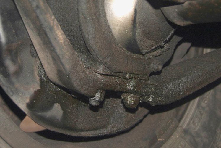

Remember when I jumped the 80? I thought it landed a little hard and has had a bit of a wobble ever since. Well.................:bawl:
Rock Dog
Oct 1, 2005
1,153
in a house
Man you are hard on stuff... Jumping a 6000 lb vehicle is obviosly not done without a bit of suffering....

I went to the B-quiet site and it indicates:
"with suspended mineral particles it has been proven to be extremely efficient at the conversion of vibration to thermal energy."
The more vibration, the hotter it gets?

The B Quiet is great stuff similar to dynomat for a fraction of the cost, I have seen lots of high end stereo installs use that stuff with great results.

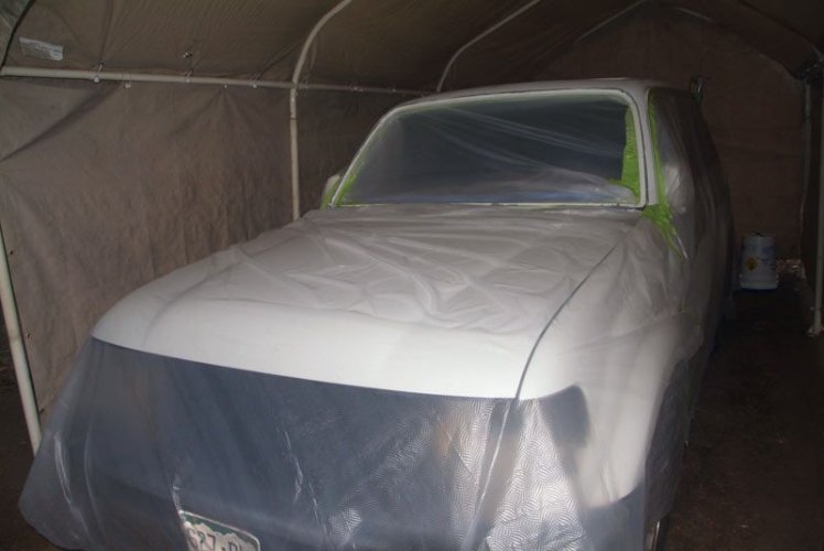

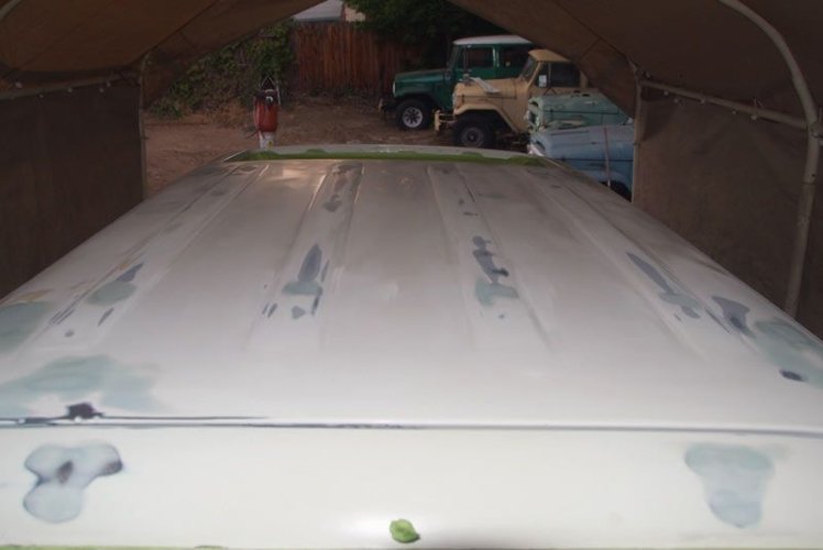

Aside from the torrential rain that hit seconds after I mixed the first pot of primer, I would say it went well. The roof is in primer now. When I pulled the windshield the bottom section had a lot of rust pitting. That got sandblasted out and is now primed. My dad came by today and helped out ton! I am glad we built the rest of the tent now. I would post a pic of the primer but I am soaked...

The color appears to be a lot lighter but actually matches the clean spots.

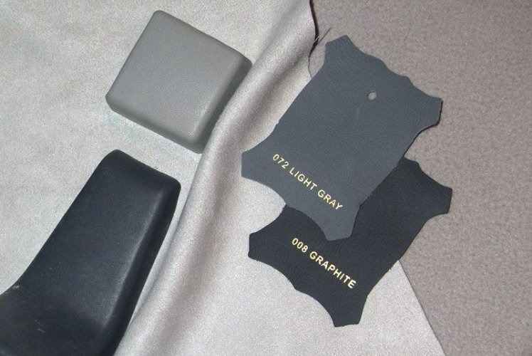

Interior design colors:

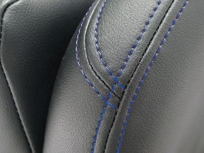

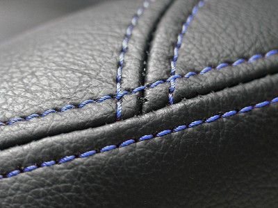

I need a go, no go for launch on the blue stitching
8,589
i don't see where it fits in with anything. don't remember what your leds are, but are they all blue? otherwise, i'd say no.
how about a neon pink? :p:
Beater
Dec 7, 2005
2,786
denver
do it pimp-dog
8,739
in da house
Do it.. the pimp leds will set it off.
