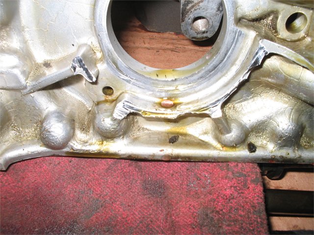

14,292
Just the timing chain kit is about $160. If I wanted to upgrade to dual row timing chain and metal chain guides that will never need repair,
Converting to metal backed guide and never needing attention again is bull. My conversion only lasted 50k.
Stick with the way Toyota did it and most important is to use OEM parts. Only accept OSK aftermarket. Especially the tensioner. Only hand finished by a Japanese artisanal machinist using Sakichi Toyoda's personal tools straight from Toyota or OSK.
I will say that if you tear into it and find the chain has been rubbing railroad tracks into the timing chain cover then all bets are off. That's probably why the shop told you what they did. If the chain has jumped a tooth then your tensioner and/or guides are probably broken and it doesn't take long for the chain to wear through the cover.
If that's happened then oil and coolant have been mixing. Bad, bad, bad.
Should that be the case and you can salvage it (e.g. you haven't ruined the bottom end with coolant diluted oil) then converting to the 79-83 two-row 20R timing chain, guides and cover is an option. I'd consider that. You'll also have to convert stuff on the front of the crank, balancer, etc. I think.
But only if it can be saved and you need a new cover. If your timing cover now is still good then stick with a single row chain and use the factory nylon guides. They're fine, mostly Internet hype about being unreliable. It's the aftermarket junk guides that break and cheap tensioners with soft surfaces (it's supposed to be a hard chrome) on the piston shaft that fail early.

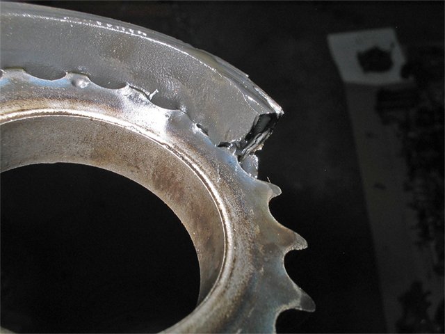

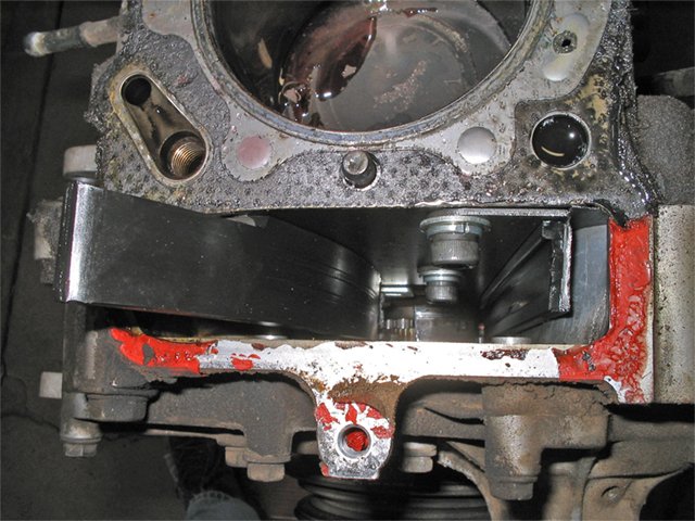

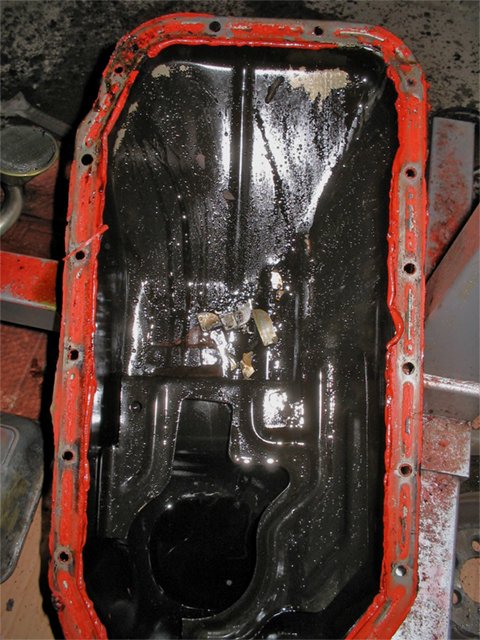

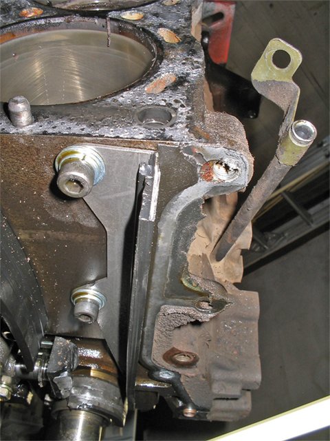

14,292
That's pretty gnarly, Dave! What did you do to those poor guides?! 😂
It was literally a "I was just driving along" situation. Stopped at a red light, loud clunk, engine died and dash board lit up. It was mid winter and I'd just pulled off the highway after driving back home from skiing solo.
My suspicion is with the warm engine and idle oil pressure the chain pressure wiggled and finally broke off the guide. It was obviously fatigued for a while and thinking back on it there's a lot of unsupported length above that top guide bolt that was just flexing.
These particular guides were double row guides that had been milled down to be single row wide. So it was a compromised design. Toyota originally spec'd the guide material thickness expecting them to be twice as wide. That's why I suggest sticking with the way they did it for single row. The guides are designed to be that width.
So my truck held it together long enough to get me within two blocks of home rather than stranding me. Drove it home to the garage using the starter.
One thing I also determined with certainty is that no matter what the Interwebz say a 1991 22R-E is definitely an interference engine.
My mistake seems mostly using a poor quality tensioner and probably making the drivers side guide too tight (you can see the wear in it). I had no idea, live and learn.
BTW, if you can reasonably do so pulling off the pan is better. I originally just removed the front bolts and bent the lip enough to get out the cover. It always had a slight weep from the corner where the new FIPG met the original pan seal. I eventually just bit the bullet and dropped the pan to reseal it. Ironically that was only about a year before the chain broke and everything seemed OK then.
