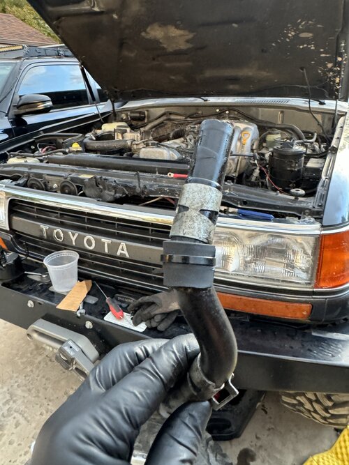

Just replaced my low pressure lines with Napa (I believe it’s manufactured by Edelmann brand) at 207k miles after one of the lines blew up.
Curious if the low pressure lines are giving out, is that a sign that the high pressure needs to be replaced soon as well?

After some digging I’m going to give the Rein a go, seems like the reviews are positive. Would rather get everything done now for the peace of mind.
On a side note, glue tread tire patches proved to work well to repair the hose and limp the 80 from a trail in Wyoming back to Colorado.
