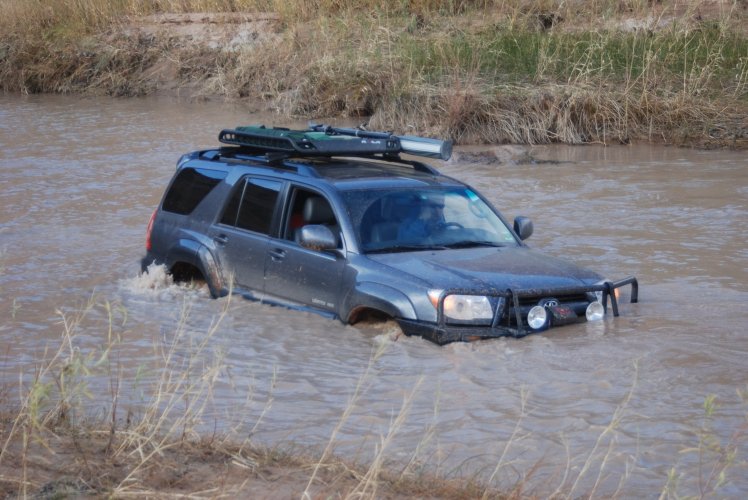

This one ended up being hung up on a river that sometimes is dry. This wasn't a direct crossing as the truck forded the river a bit before geting hung up. The truck flooded and the electronics were all shot. It ended up being totaled.
I also know of a 200 series that sucked in water in a water crossing and hydrolocked his engine.
If you are on your own, the wadders are a good idea unless it is obvious.
As stated earlier, Diff breathers are always a great idea. The snorkel is dependednt on how deep the water is. If you get a hung up a bit and suck in water, that would be bad for the engine.
I have had snorkels on my rigs, but that is personal preference and for thee dust on the road as well as the water.
