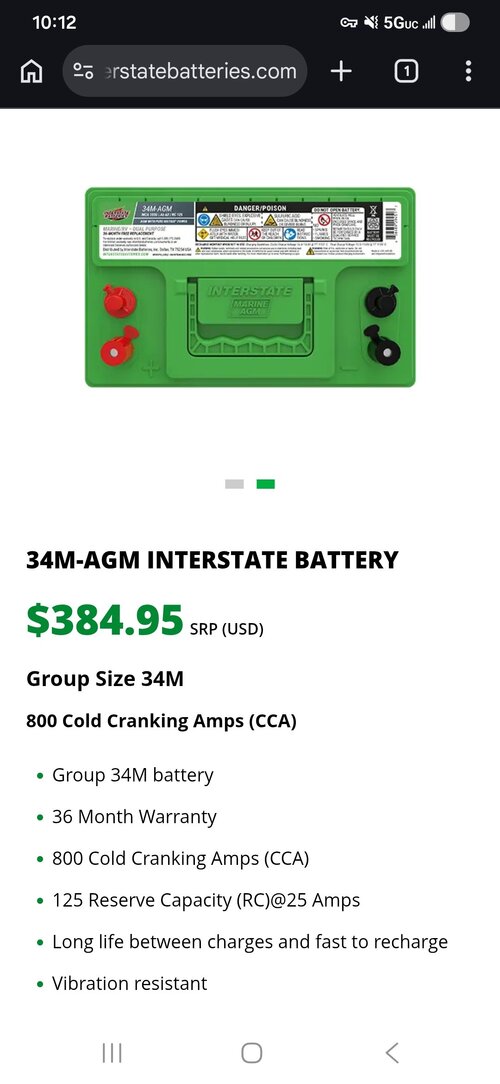

I've been rocking an interstate 34M dual purpose starting/deep cycle battery from interstate.
A little pricey but have been rock solid.
