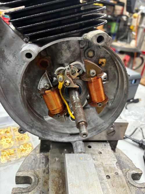

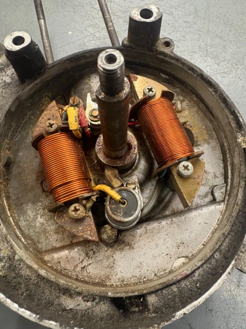

So the magneto output is or isn't already rectified?
That thing you got from Bezosmart is probably not helpful and might work against you. With such a wide range of inputs I'm thinking that the LED lamp may have it's own PWM inside. It should not need the DC-DC in that case and might work against you feeding a switcher with another switcher.
If the magneto is unrectified AC all you need is a couple of diodes and a cap, even a bridge like they put to allow AC into that DC-DC is kind of overkill and doubling your drop unnecessarily (you'll drop 2 x diodes per cycle, so ~1.4V less than Vpeak).
If you can tell the part number on the bridge you might find a datasheet but cheap rectifiers often have appallingly slow recovery so you might get reasonably DC as idle but at speed it'll be barely DC. They are intended for 60 Hz and might extend performance out to perhaps 400 Hz. By 1 KHz they often aren't doing much anymore.
It’s not rectified. I think the front LED will be ok, but the tail light is what is causing me to try the circuit. It’s tough to find a bulb that will accept a wide range of AC inputs. So I found a circuit that could handle the power of both lamps. However I may try to just run the rear lamp with it.

I mean, like, you know they make magneto rectifiers just for this problem already, right? These are not going to be well filtered so that's why I suggest throwing a nice, big cap across it.
If this is too rich I have bins full of diodes and caps that would cost nuthin. I'd wire in a small battery into the circuit to smooth things out and prevent the lamps dimming at all, too. But that's just 'cause I'm stupid like that.

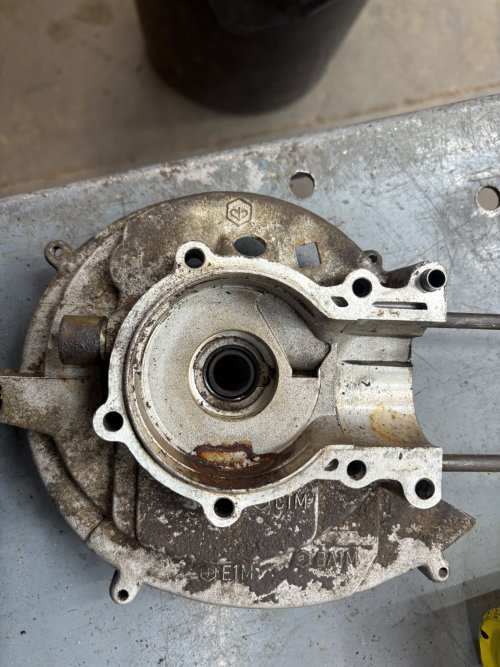

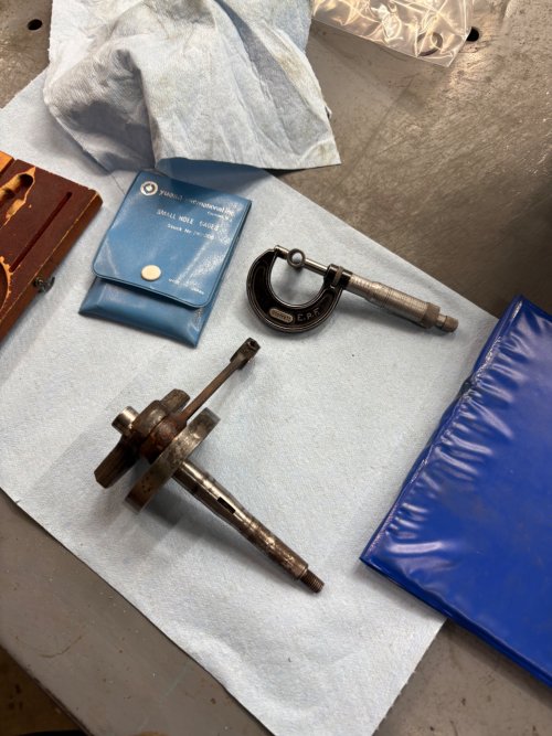

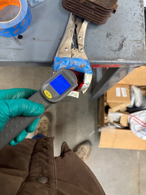

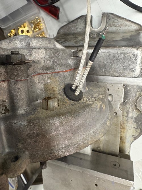

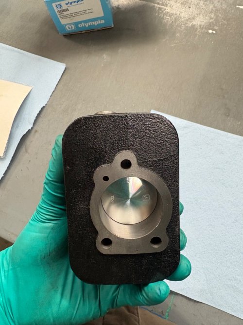

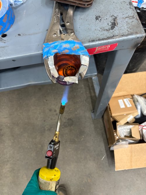

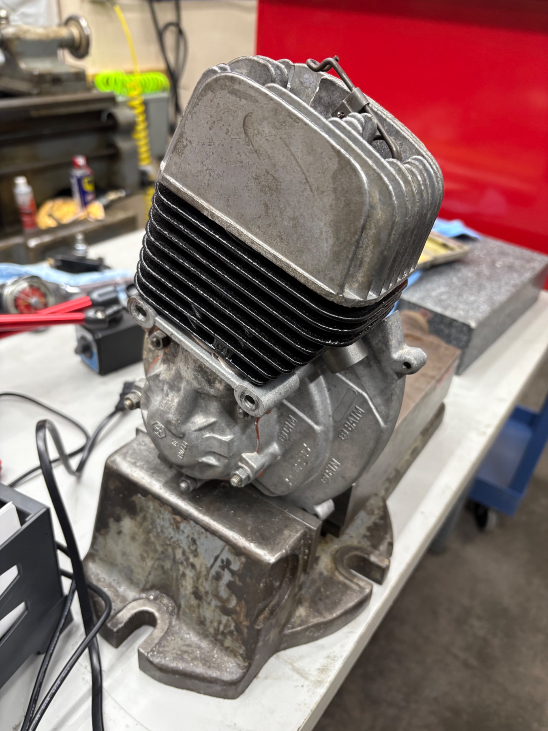

Made some progress today. Got the engine parts cleaned up and put together.
I put new crank bearings on, probably should have replaced the wrist pin bushing but decided to roll with what was there…. She was rocking .0034 of ‘erl clearance 😬. But in a 2stroke, the force is always down right??
I made a real “Whiskey Tango” oil bath to heat the bearings up to 250 F to make them glide on. A few light taps and they went on. The old bearing was the perfect width to support the crank counter weights.

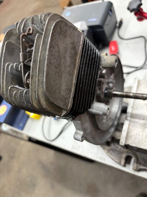

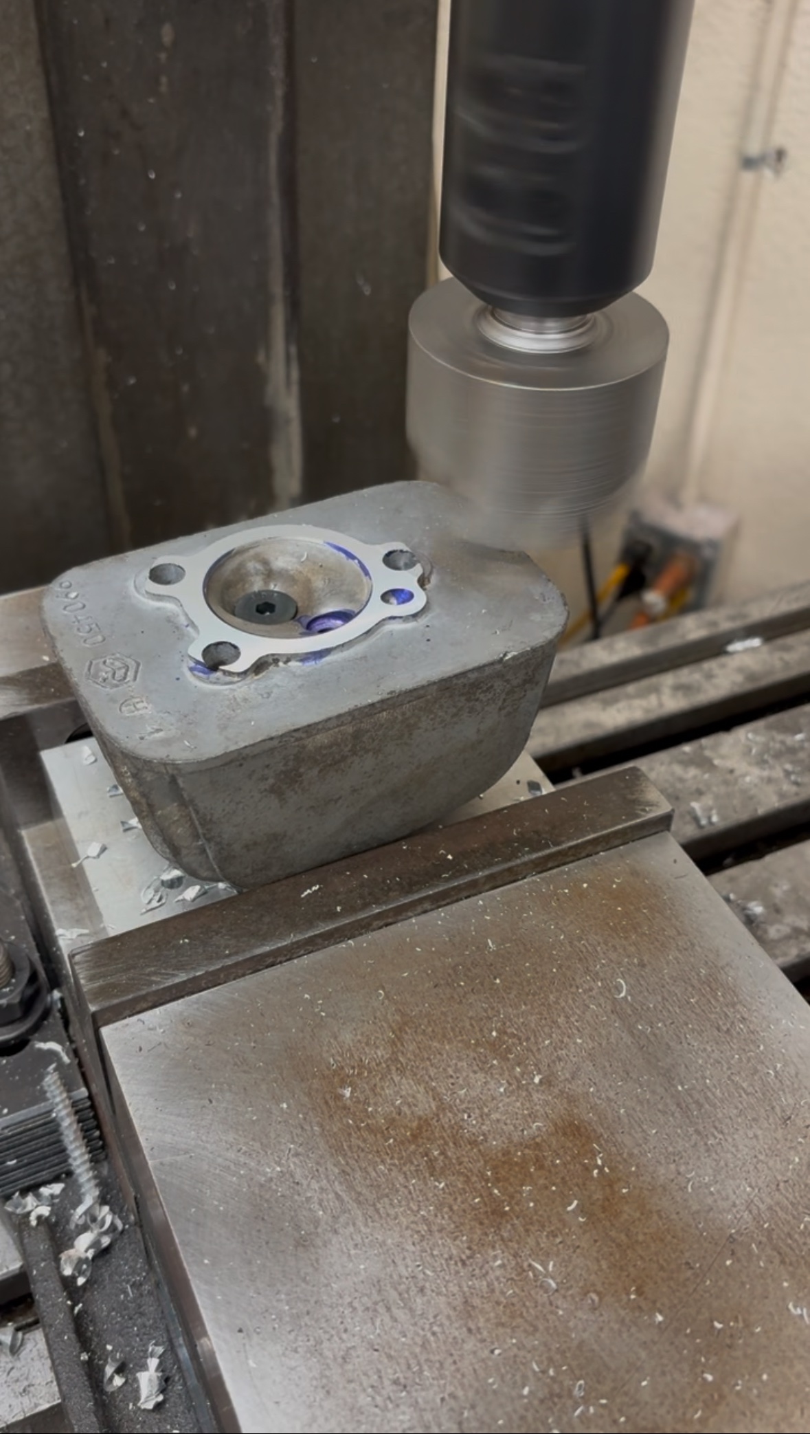

These things don’t run head gaskets (typically). My head was quite warped. I CNC’d a little fixture that used the spot faces for the head stud nuts to locate everything. I sent a flat head screw down through the spark plug hole to secure it and took about .010 with a fly cutter.
