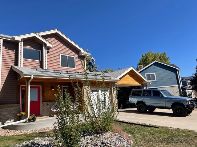

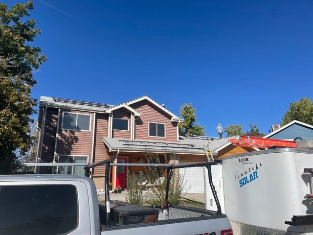

Ok we have some progress... they got all the metal screwed down, and about 75% of the panels installed, and all the boxes wired up. I'm told this is as far as they can go until the inspection happens on Friday.

Not much of an update but it's all on, and I passed the inspection last week... that little box is now switched to "on" after the inspector/installer have left, which kinda surprised me as it would appear I'm now feeding the grid, albeit unmetered? It's sorta puzzling how I could simultaneously put power into and suck power out of the same bus bar inside my breaker box, but there it is...
My electrician neighbor came over earlier this week and measured about 30 amps coming off the panels and into my box, two hot leads from the panels one at 16 the other at about 14, which felt pretty good but it's hard to say with out some other data if this is the amount of juice I signed up for. I have the Enlighten app installed and an account created, but they won't activate my account until I first get the new bidirectional meter installed and the final permission to operate from Xcel energy. Was told today it could be another 21 days... until them I'm pretty oblivious to what my system is doing.
