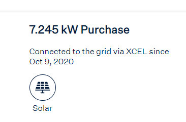

Here is our project estimate showing the size of the system and annual production. Kool thing is when they did the satellite rendering you can see my 80 and my camper in the photo.
15,654
@RayRay27 yes you're totally right Ray, and that's all in the thread here. I had to push back for more as their first quote was 102% of past consumption, now I'm at an estimated 122%. And I'm able to add to this system in the future fairly easily, which once the grid tie is complete ought to be fairly easy to do myself, just need to buy more panels and inverters.
