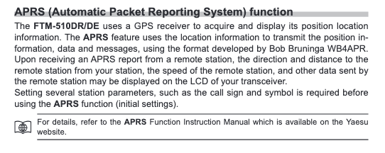

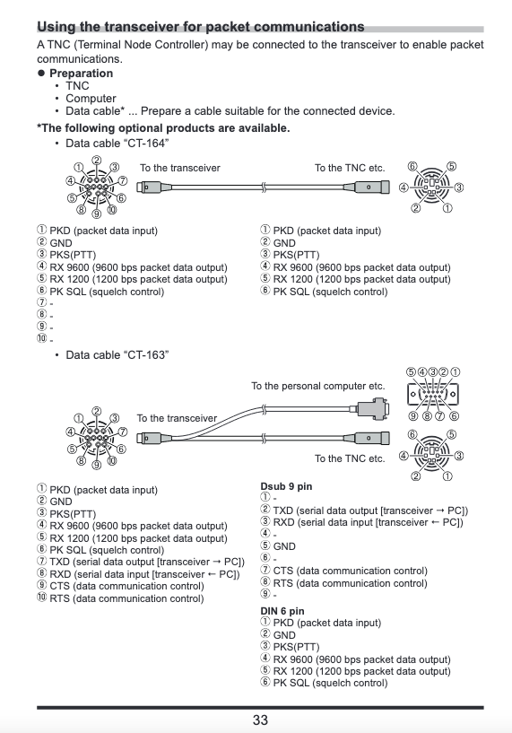

Dave, looking at the Yaesu website under files for the FTM-510 there is a separate instruction manual for APRS. The general manual lists APRS in the contents, but defers to the stand alone manual for details. I know nothing about APRS so this may not be meaningful, but I did find those four letters listed in a row in two manuals for that new radio. As usual Yaesu hasn’t done a good job in the description of any of the four new radios. Vague at best.
It seems you are on target.
I was looking at the DX Engineering page. The FTM-500 used to mention 1200/9600 APRS but didn't see anything on the FTM-510 listing.
But in the manual it is in fact mentioned. Looks basically the same set up (using the CT-163 or CT-164 interface cables) as the previous radio.

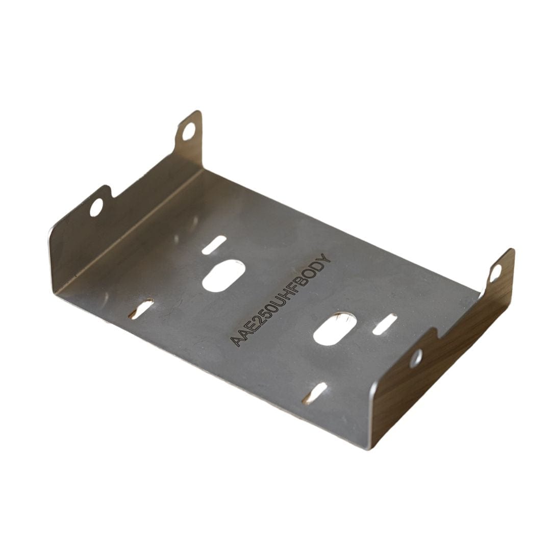

This is the radio.
I’m guessing the power supply might be a little short for a 50watt radio. Not sure I could shoehorn a HAM in the same spot but maybe. Guess I should open it up and look. I can order just the mounting bracket. Wonder if my TM-D71A from my 80 would fit in there and I could just upgrade the 80’s radio to the new Kenwood.

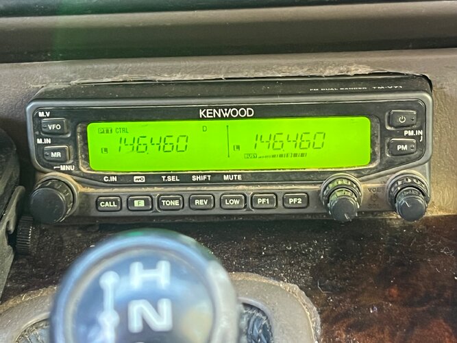

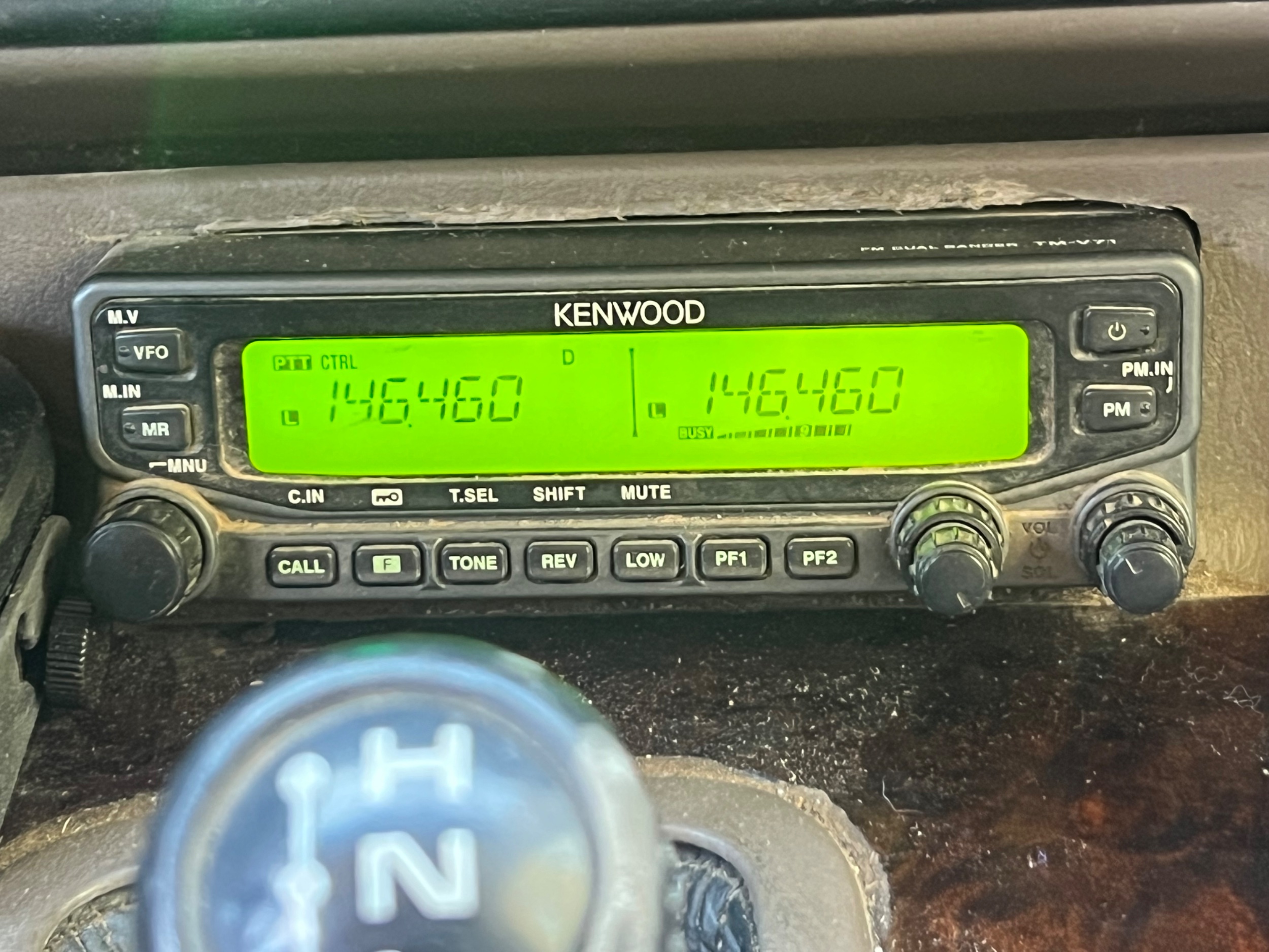

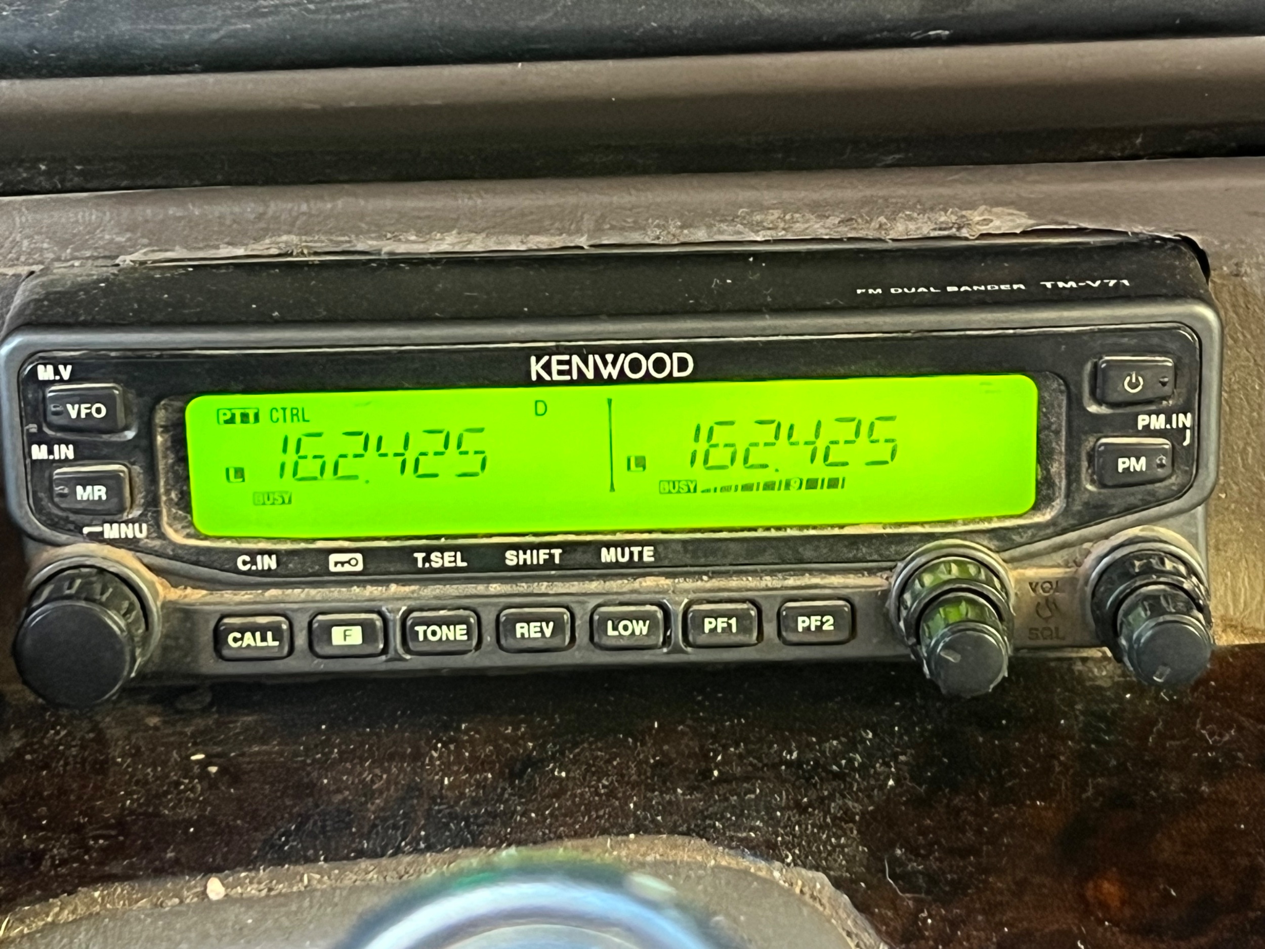

I’m going to post this here instead of starting a new thread. Last weekend I was having some issues with my old Kenwood TM-v71a
Doing some trouble shooting today, I’m no expert here but it appears the band A, left side radio on my dual band is having issues. With them both set to the same frequency only band B (right) side shows a transmission being received when I key my handheld. You can see the signal bar on right display.
So googling shows a common issue with an internal ceramic filter. Looks like it’s not a terrible repair, but probably one I wouldn’t do myself as I don’t have the tools or experience working on circuits boards. Looking for any other opinion and by that I’m really talking to @DaveInDenver but anyone else is welcome to chime in.
10,592
Tuning into the weather broadcast I can hear it on both bands but the A band has static in the background. B band is crystal clear. And again we have the signal bar on band B. There is also a pretty significant difference in overall available volume between both bands.

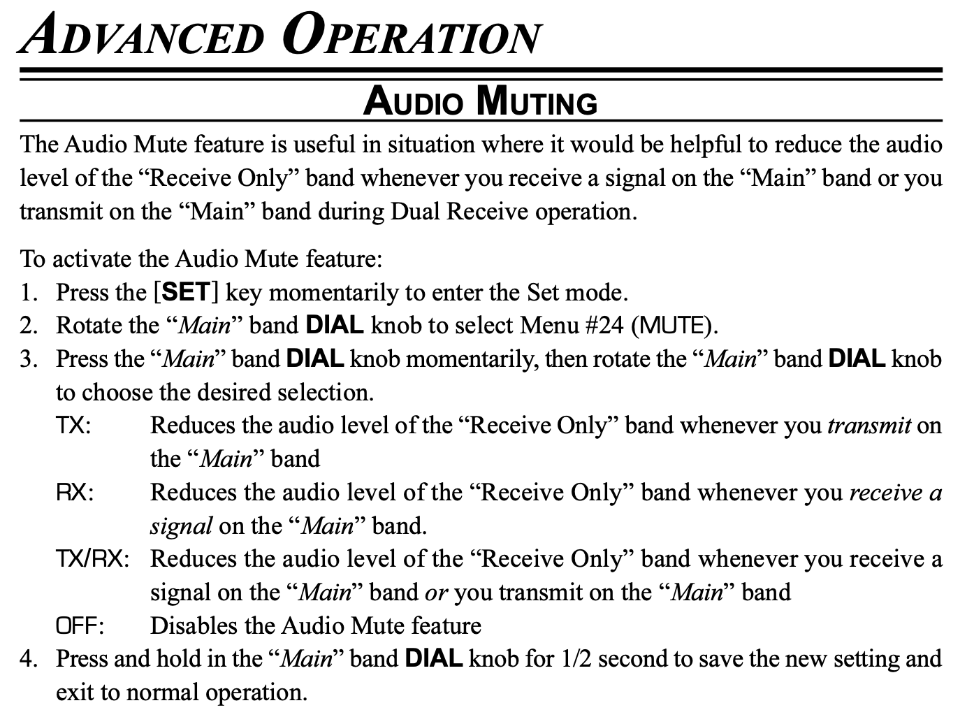

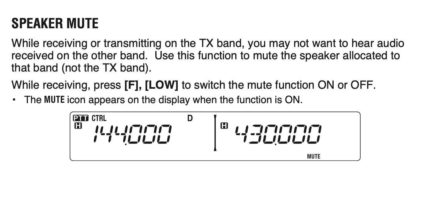

You already ruled out a separate squelch setting, or mute setting? I wanna say I experienced something similar with the Yaesu FT-8800 then realized there was another squelch in there messing with me. I just scrolled through all the settings on both sides to compare settings...
14,375
I think what you're talking about is the audio mute functions. These dual VFO radios usually have a way to quiet the secondary channel audio if there's activity on the side you have selected as main.
The FT-8800
The similar function in the TM-V71
It's a good thought but I don't think it's @Corbet's issue. I base that only on the S-meter on the left side shows no received signal. With both VFOs set to the same station I'd expect the signal strength bars to show the same thing. Additionally the "PTT" is on the left side, which indicates that's the side selected as main so should be the right side showing "MUTE". Worth a try messing with the settings though.
Another thing I notice is the left band is selected as the data side (indicated by the 'D' on the screen). This can make the TM-V71/TM-D710 do odd things like hold off or mute itself when it thinks the main or non-data band is active with open squelch.
When you designate one of the sides of the TM-V71/TM-D710 as data it doesn't need that side to be selected for it to get the transmitter key when the TNC asks for it (through the data port, for example). It's smart enough not to override your mic PTT key, though.
I'd move the B side to a different frequency with no signal on it and see if the A side comes back.
It could be the filter issue. The TM-V71 has two distinct RF paths after the antenna switch. It's certainly possible for one side to work and the other not.
If tweaking settings doesn't get you there my next step would be to clone the memory to a PC and do a hard factory reset to flush out everything and see what happens before thinking about service. Never know if flipping one setting is biting you. If it starts working then you know it's a setting or corrupted memory slot and not the hardware.
Starting the betting line at 3/5 on whether it needs filter component work. My bench is of course your bench.

I'm not aware of a 2nd squelch adjustment other than the two independant knobs with the volumes. The A band squelch can't get rid of the static like it will on B. I'm pretty sure my problem is the common filter issue.
10,592
@DaveInDenver
I'll try a hard reset, I don't have anything in the memory to save to a PC so that's an easy task. One could argue I'm not the best canidate for HAM but better for GMRS. I don't really have any strong drive to tinker and dive deep into all the aspects of HAM. More of a connect power and start talking kind of guy. Part of my problem is my preference in computers is MAC and this radio, probably like most, need a PC interface to program.
I did mess around with many of the other scenarios you described above to see if I could get the A band to function normally. I just did not take photos of the display under each condition. The data setting is one I did not move to the B side to test. So I need to try that.

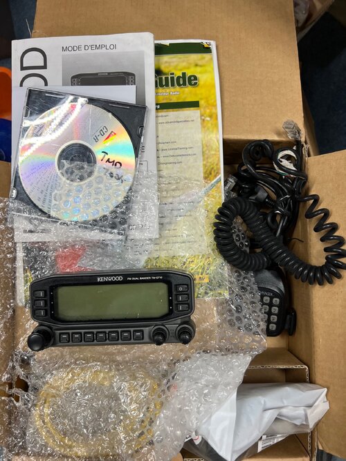

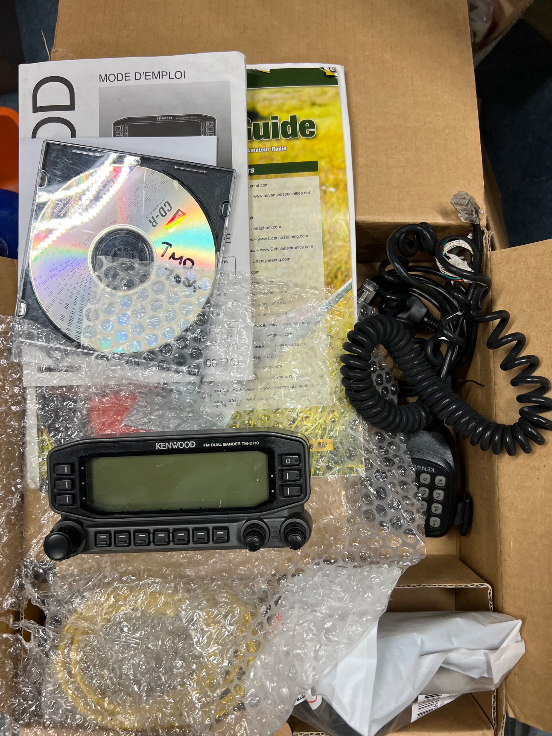

See if I can carve out some time this weekend to trouble shoot again. Otherwise the man in brown delivered a box yesterday with a different solution.
