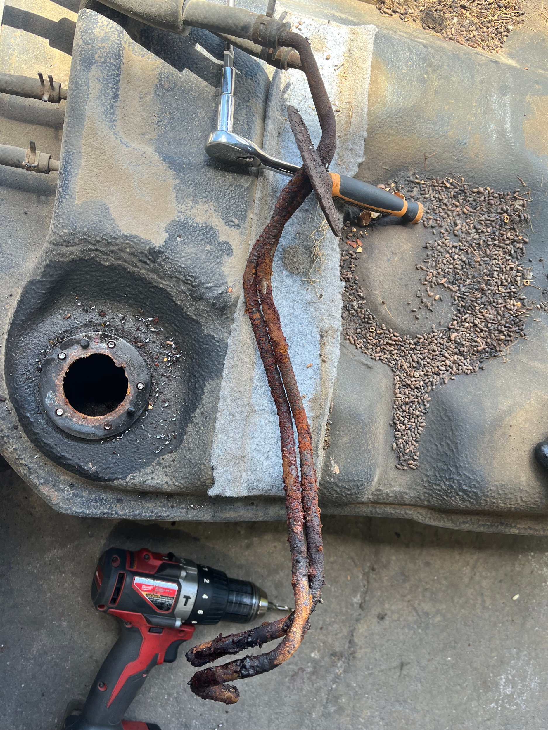

Note to self: Don't over fill the gas tank. The old hose leading to the filler neck through the body starts dribbling fuel. (Curse you thermal expansion.) Might be time to refresh some of those old lines. My understanding is the OEM hoses are NLA, so Gates replacement it will be.

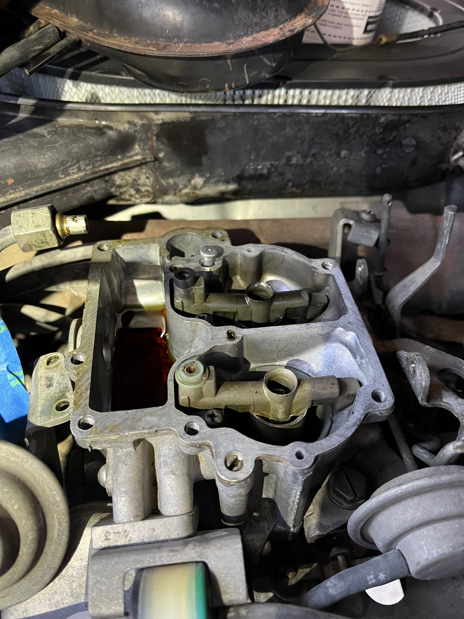

Thanks for chiming in Bruce, if I'm getting low vacuum at that spot carbon build up could be an issue. Or it's another issue.
Sounds like HAI is gonna have to go. (I haven't jumped into it yet. There's a chance it's already plumbed out. I'm not worried about keeping it functioning, just want that fresh, cold air coming through.)
Sounds like my heat control valve is gonna keep doing what ever it's doing until I need to pull the whole exhaust/intake manifold. C'est la vie.
The FSM calls for 114-149 (Emissions manual) 114 is considered a dead hole, and the FSM calls for greater than 149 psi. No more than 14 psi difference between cylinders. I haven't done compression on this motor yet.
