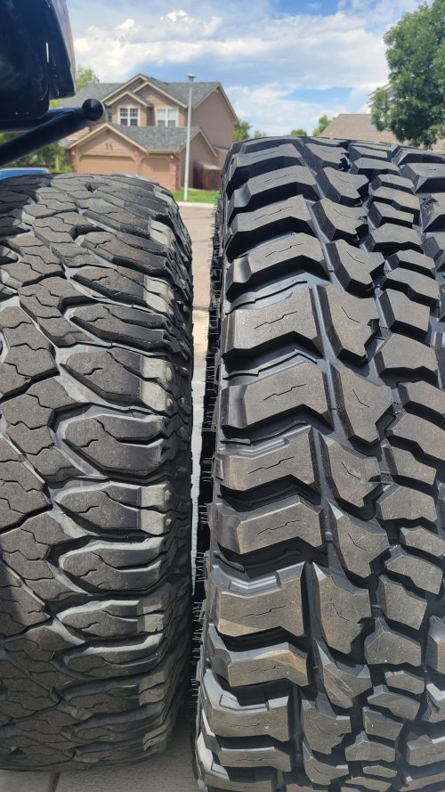

And sorry yes I'm running PANTYgonia black label. Total trash. When I do the rear, I'll be going 40" sticky BFGs or Trepadors. And agreed JKimmel, Atlas will come with the very-far-down-the-road V8 swap but getting that rear linked is more palatable (and more aligned with my current motivation to continue to build) for now 😀

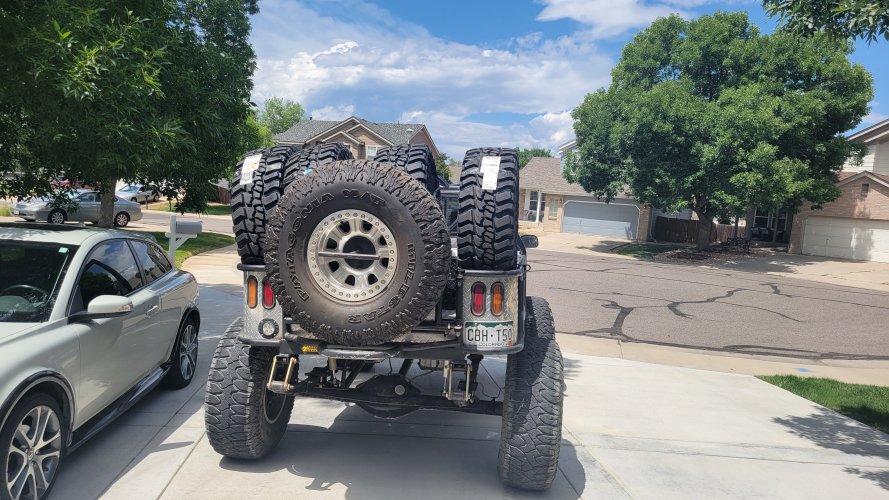

Yo. Obviously haven't posted in a while and figured I'd provide a small update for those interested. The truck is performing amazingly still. Zero issues to report after Moab except for a few corrections that I did, notably the rear axle seals, correcting the rear driveshaft angle, steering shaft/column correction, and a few other things. I still need to install the Wilwood master cylinder - that'll come this fall/winter. I've also taken the leap and purchased some 40" sticky Mickey Thompson Baja Boss X tires so I'm looking forward to getting those installed before the season is over! I'm either going to sell my 38" Patagonias or I'm going to buy some cheap steel wheels and mount them on those for drivability, simpler trails, and save wear on the stickies. I would also consider trading them for a set of decent 37" tires - let me know if you're interested in a sale or trade. But the 40's are in my possession and I'll be installing them in the next 1-2 weeks.
Also went with a few members of the club (Andy, Justin, Daniel) to Penrose in early June and stretched my comfort level a bit. Went down Liberty trail, up and down Independence, and up Patriot after reaching out to a guy named Loren Krey (check out Kreyzfab on YouTube or IG; amazing driver, great fabricator located in Pueblo). Great trip. Loren is going to be re-caging and boat-siding my truck this fall/winter but I want to get these 40's on and run Carnage Canyon before that and before the season ends (along with Wheeler Lake and another undecided trail or two). If anyone is interested in the existing cage, bed, and sliders on my truck currently, let me know since I plan to salvage it to be used on another vehicle (I hate to scrap it). I'm also probably going to do a cheap paint job on the truck as well as get a stock Toyota bed where I cut off the bedsides and bolt them/nut-sert them to the new cage for a cleaner look on the rear half of the truck (let me know if any of you know of a truck bed (preferably 1995 or older) that is for sale).
Here's a few links to pics and vids from Moab and Penrose, as well as some pics attached to this post of the 40's.:
