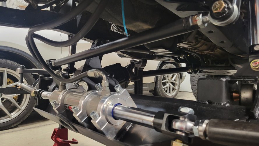

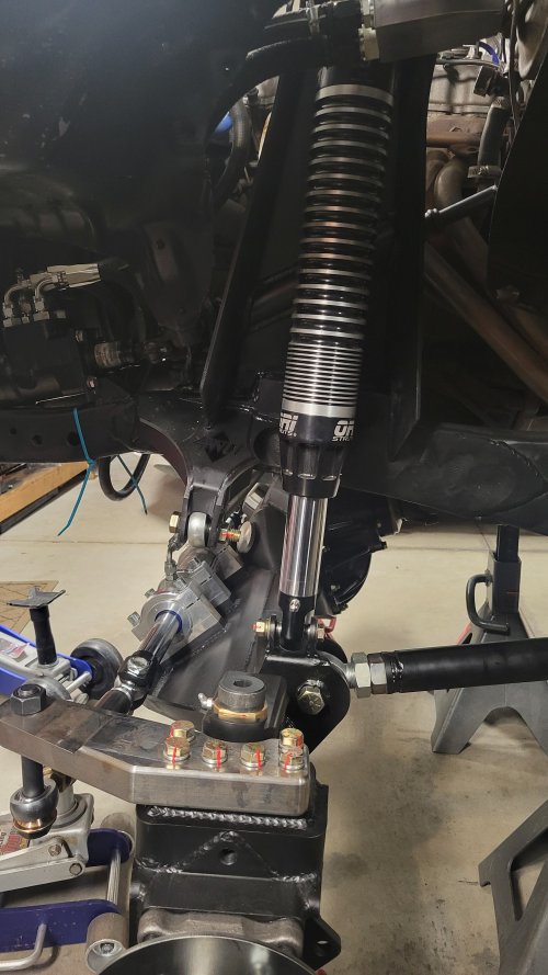

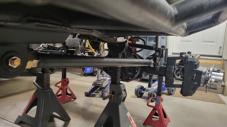

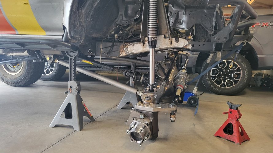

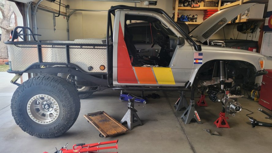

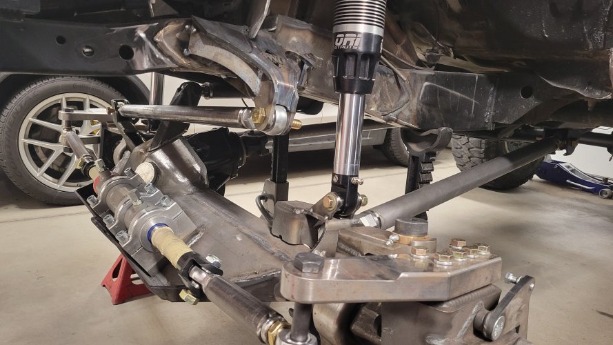

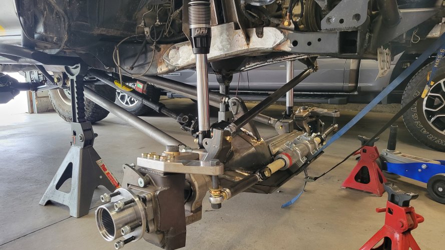

Another hugely productive weekend. Got the rear axle completed aside from hooking up brake lines and upper shock mounts, and sitting on tires now. Got the gas tank and skid plate/trans mount done (finally). Front links are in and tacked, and axle cycled. Crazy how much shock these 14" ORIs are. Shit ton of down travel. The full droop pic attached still has another 2" to go (axle basically laying on the floor).
Also got my front inner shafts from Currie.
Will get front and rear drive shafts ordered tomorrow and steering lines plumbed this week. Then next weekend is a whole bunch of welding and hopefully paint as well. Other than that, just need to bleed brakes and steering, get the orbital mounted, and about a dozen smaller things remaining. Knock on wood I'm on track for Moab.
Feel much better after the push this weekend. The first pic is near ride height. Gonna be sitting a little raked up front; more than I want but doable and I can adjust ride height with nitrogen.

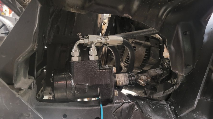

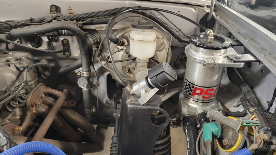

Quick update - another good weekend (though I didn't take any pics). Hopefully the next pics you see will be the truck outside bathing in the sun! Got the front axle back under the truck, fully welded, fully painted. Steering fully plumbed, started the engine up and let it all run for a half hour after bleeding the steering and had zero leaks. Steering column shaft rubs on my shock tower that I did a half-sleeve for but it'll clearance over time (just sounds like hell with metal rubbing metal). Links are in, axle shafts are in, panhard mount and towers fully welded, third member is in, knuckles are on, ram is in, struts are in, and I'm half done torquing and torque marking. Here's the remaining primary to-dos:

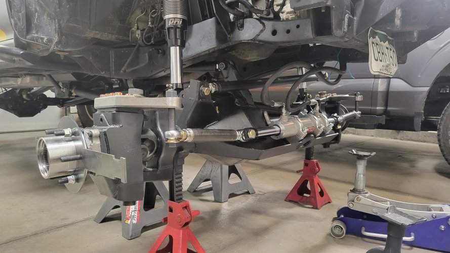

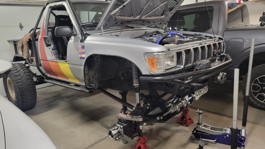

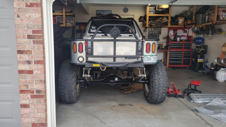

Alright here you go. I just charged the struts with nitrogen and while it's hard to see, the jackstands at the frame are not under load - the vehicle is sitting on its own weight on the struts now that they're charged. Gonna monitor over the next few days and make sure they're holding pressure. But this is how this pig looks now. Still need to mount the PSC reservoir catch can and a few hose clamps i was shoeted, so never mind that.

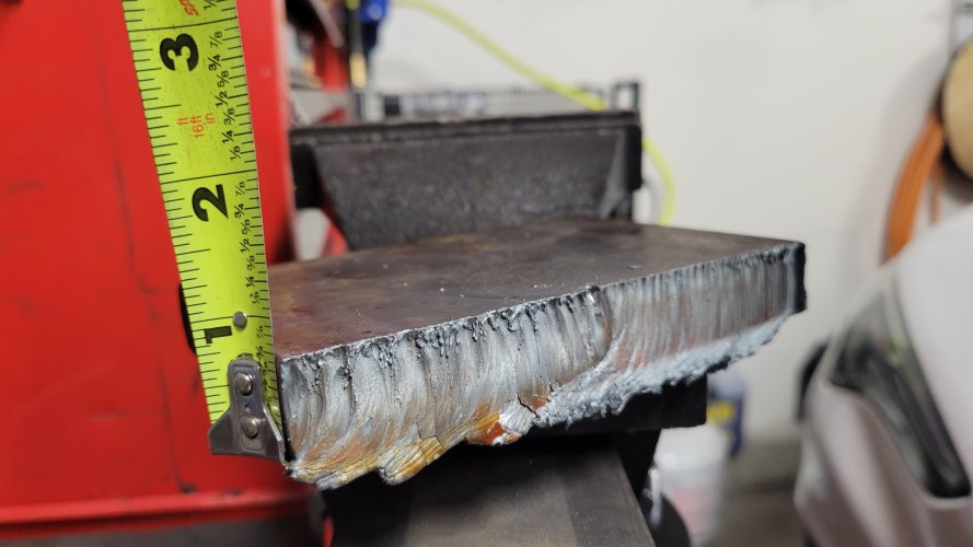

Not really a progress update but I had to show this because it blew my mind. I bought some 3/4" steel plate from a scrap yard to fabricate the lower knuckle mounts to make double shear steering. Had no idea how I was gonna cut the plate and just figured I'd try plasma cutting before I went the the grinder. I turned it all the way up, let it eat, and this Amazon special Chinese made POS plasma cutter actually made it through 3/4" steel. Just wow. It was slow, but I can't believe it did it.
Just thought I'd share.

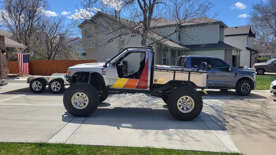

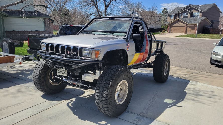

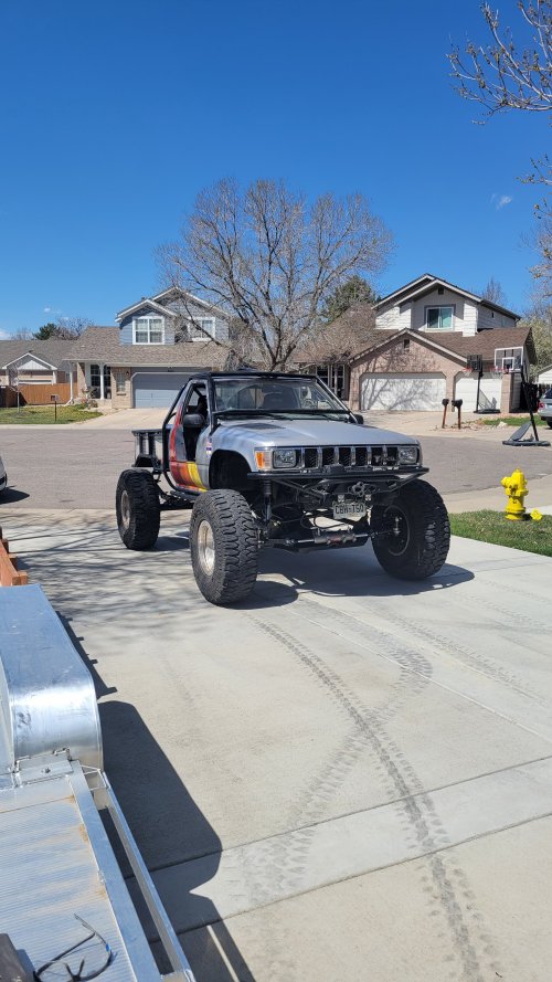

Well, I did it (I think). Brakes still need another bleed or two (we already did three rounds of it. Steering is a little weird - was only comfortable getting it up to about 30 mph. The truck "wanders" quite a bit. You correct one way and it sticks there and doesn't move until you correct the other way so you're constantly trying to keep it in the center of the lane. It's either alignment related (I'm gonna set up an appointment at a shop in Moab for wednesday) or they sent me the wrong orbital valve (I remember specifically asking for a "return to center" orbital).
But she drives otherwise just fine. No weird noises or anything. One of my front axle shafts self-clearanced the inner C weld but it wasn't too bad.
Plenty of things that I've already identified that I want to change or correct (notably the front ride height since it's pretty raked right now as well as the tower brace over the engine that i clobbered together and looks like a bag of smashed assholes) but that's for after moab. I'm unfortunately tied up for two days straight for a work event, including evenings so I'll be packing very late in the evening. Also need to put more miles on the ring and pinion gears for brake in. Only have about 15 miles so far.
