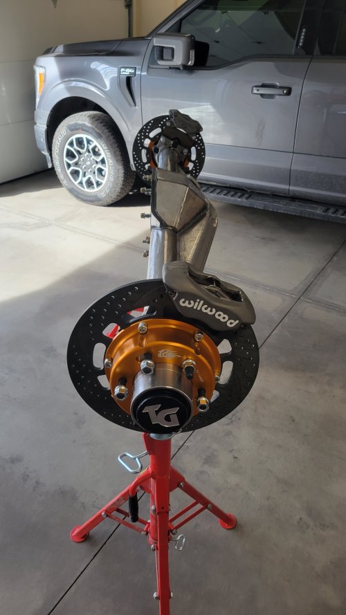

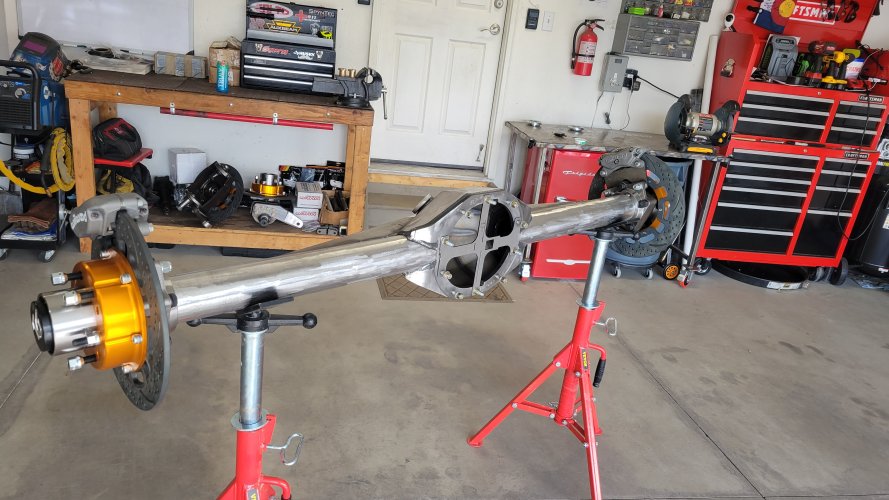

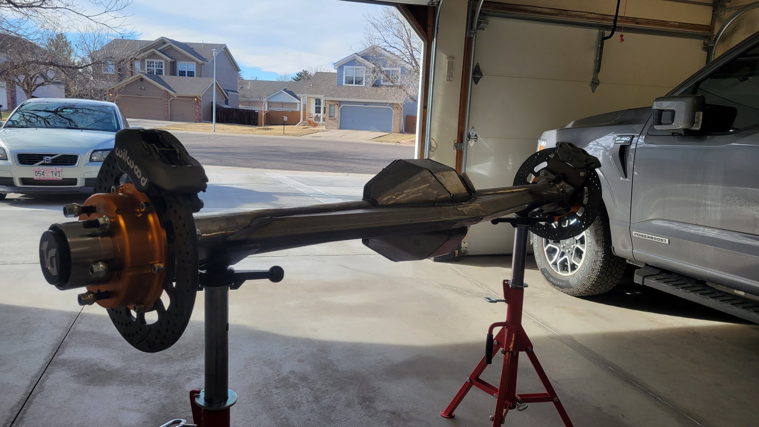

Got the rear "done" today. God I forgot how much I hate welding on backbones. Question, anyone familiar with Wilwood 4-pistpn calipers? I've heard mixed reviews about them. I might go 6 piston front 4 piston rear but I'm not sold on that yet.
I also made some simple zero protectors for the front lower ball joints.
Admittedly I started this build thread too early but I also didn't expect my third members to take this long. I'm still waiting for them but since I have everything cut to length, I can order axle shafts!
I'm also gonna be doing a quick disconnect steering wheel so I'll post that in a week or two (hey, gotta do at least one upgrade before cruise moab!).

Sorry, here are the pics.

Thank you sir. Correction above, ***zerk protectors. Any thoughts, feelings, concerns, snide remarks on Wilwood 4 piston, or frankly an 4 piston brakes? I'm low power and light vehicle but haven't ever run anything but stock calipers.

Nah, my setup is completely different but based on factory to what you’re going to I’d imagine a 4 piston is plenty. Mine are 4 piston wilwoods with 14” lightweight rotors but manual so who knows

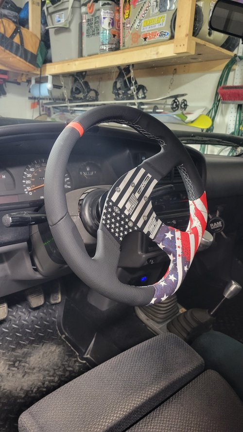

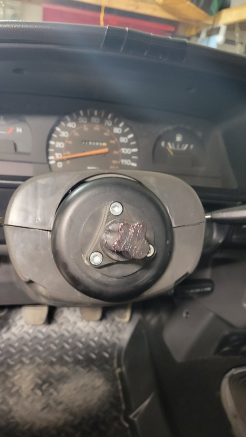

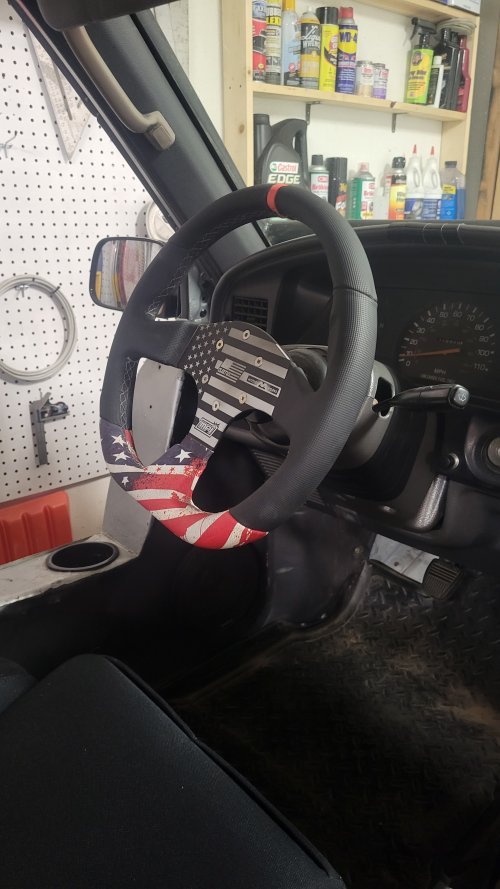

Totally unrelated to my axle upgrade but still fun. Installed a quick disconnect steering wheel today which should give me some serious mall-cred. Love this thing. Had to do at least one thing before Moab.

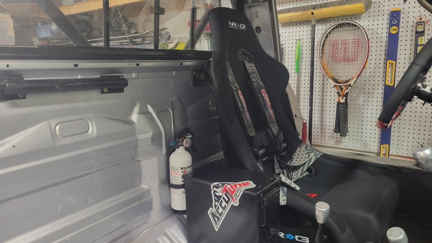

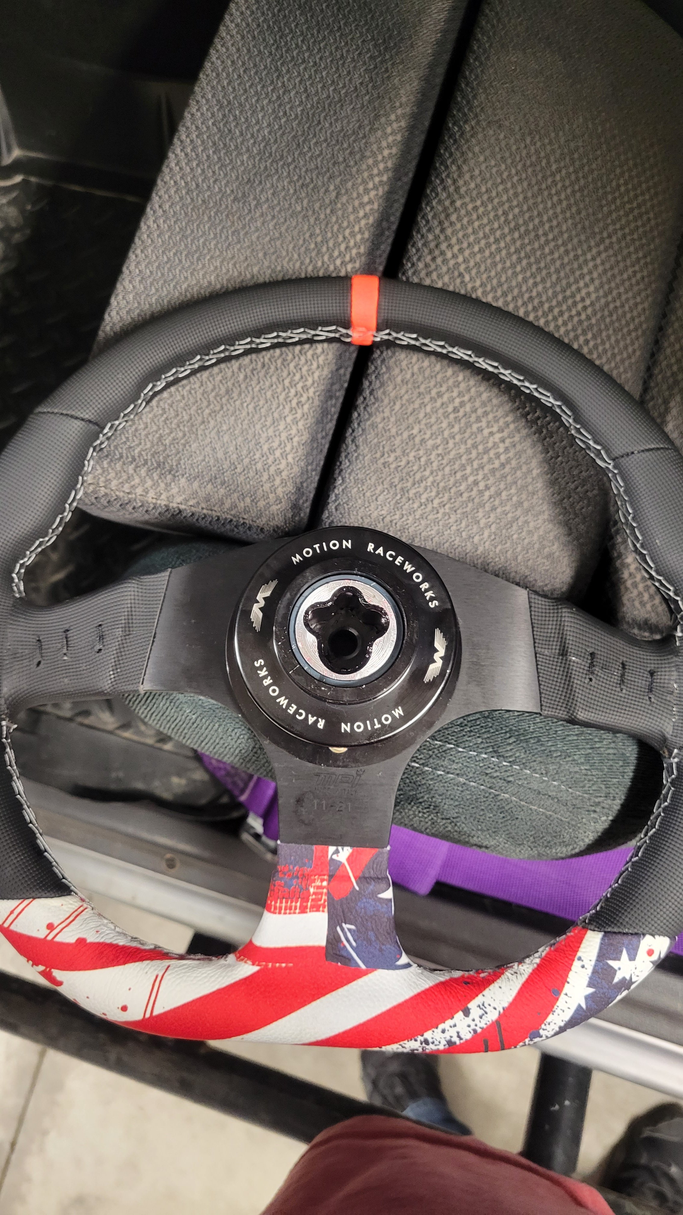

I have done a few upgrades that I have found much more worth it than I thought though (I have to do something). New quick disconnect steering wheel and new seats and harnesses (previously only had 2-point harnesses, now I have 4-point). Ripped out the carpet, cleaned up the interior, mounted a new center console, and made shoulder strap mounts with sandwich plates. I fully acknowledge that these are not as robust as being tied in with a cage, but it's better than I had and I ain't racing the thing. But one of the two seats I ordered showed up friggin purple so I sent it back and am waiting for the correct black one. Pics attached for entertainment. Seriouosly some underrated upgrades. And I have a fluid container holder from Artec that I also need to mount.

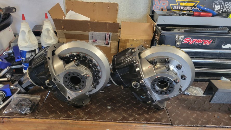

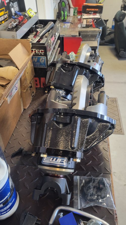

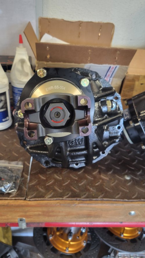

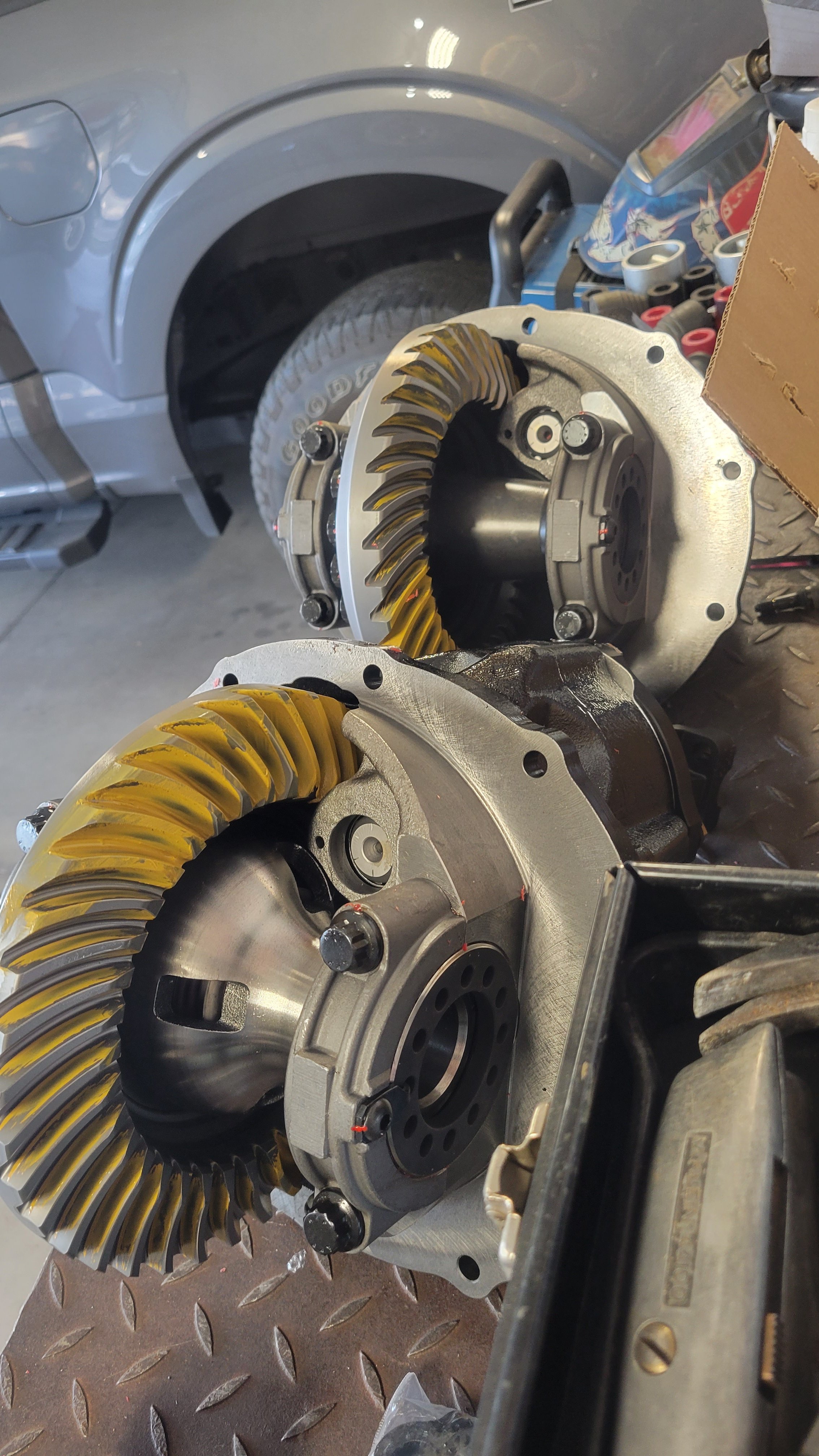

FINALLY. 11 months and 5 days but they're here. Time to get to work. I'm going to do the rear first since it'll be quick and dictate how much I need to stretch the front to get to my goal wheelbase of 112", depending on how much I can stretch the rear. Not sure when exactly I'll start it but I'll keep this thread updated. No later than Thanksgiving.
Then I'll get the rear axles and driveshaft ordered while I start on the front. My 4WheelUnderground components should be here very soon as well. Only ordered the coilover towers and brackets for the axle and frame for now - coilovers, links, and bumps will come later.
So relieved to see these damn thirds.
