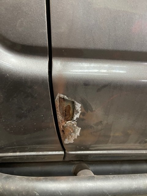

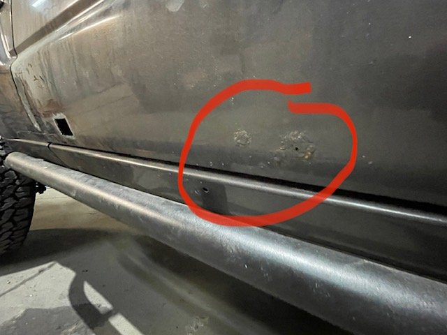

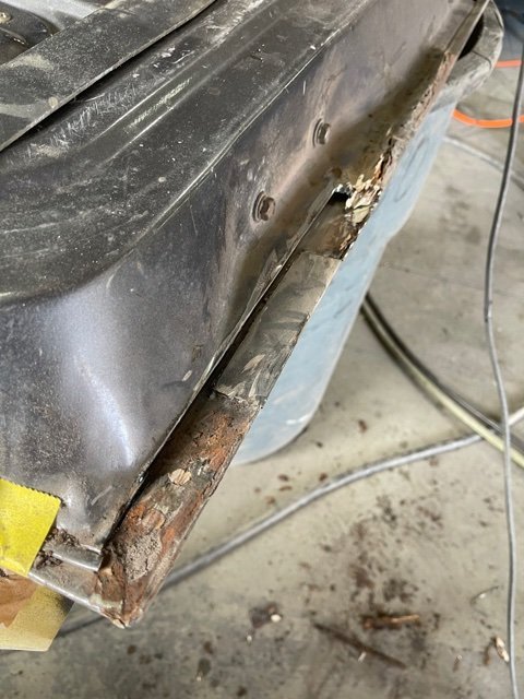

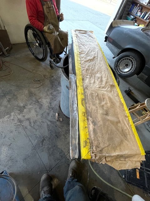

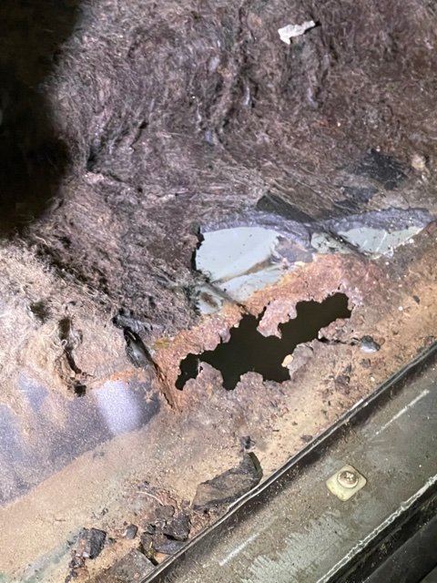

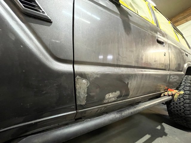

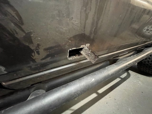

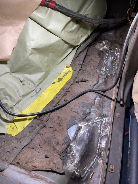

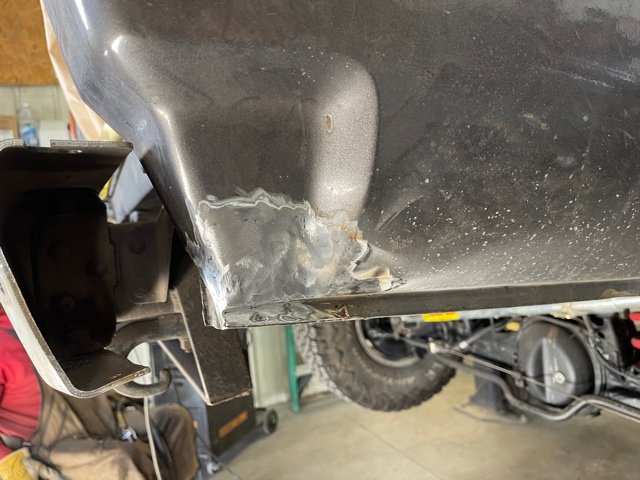

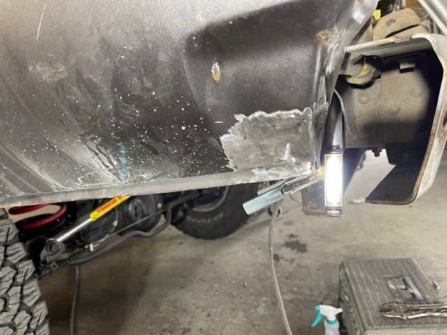

Took the truck up to Jason, the Rust Dr, in Grand Junction to get some rust mitigation and frame protection going on. Some of the new suspension items started self disassembly, but I'll get to that later.
Some shots of the work so far.

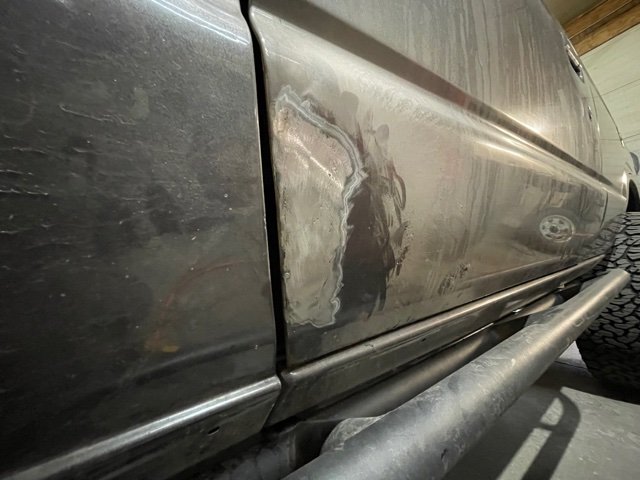

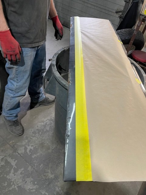

Repaint of the problematic rusty areas finished. This was done by Thompson Rod and Custom in GJ for a very reasonable rate.

Reassembly. So far I'm really happy with how well the lower paint job matches with the truck. Way better than I anticipated for the price I was charged. Hoping to have it back this weekend to start reworking the coil suspension.

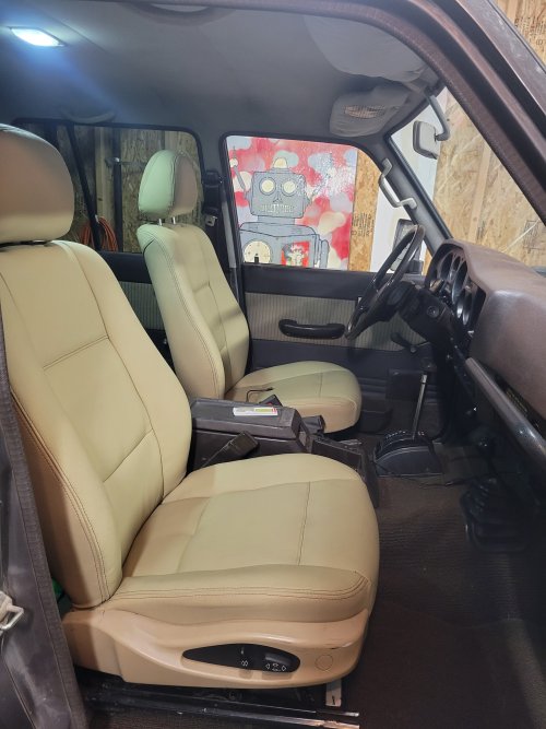

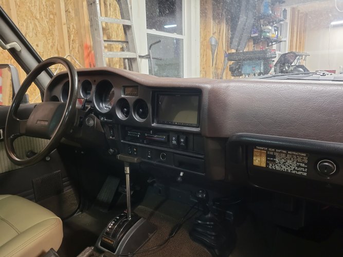

Got the seats that @rckhound recovered installed. So much better!
Radio crapped out on me so I threw in a new touchscreen setup with front and rear cameras.
And since I had to ditch my rear locker with the new axles I added a winch for a little extra off road security.
Seats are from an E38 BMW. I used the torfab mounts (60BMW is the code) to get them set in place, which also gives me much more leg room than before.
Headlights are JW speaker model 8800 heated lights. https://www.jwspeaker.com/products/heated-4x6-led-headlights-model-8800-evolution-2/
