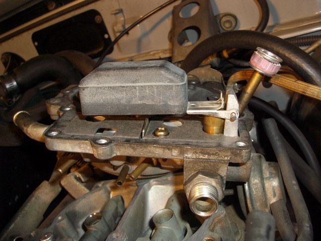

I took the carb apart again yesterday and checked the float adjustment. It was exactly 7mm if you include the gasket. Since the instructions said 7mm to the casting, I bumped it one mm, but when I put everything back together it didn't make a lick of difference. The fuel level is still well below the bottom of the sight glass. Not to mention I seem to have lost a rubber washer. :rant: :mad:

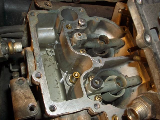

Here's a good look inside the bowl. You can see the fuel level is way too low. You can also see how clean it is. The specks you see in the bowl are discolorations on the surface, they are not loose objects.

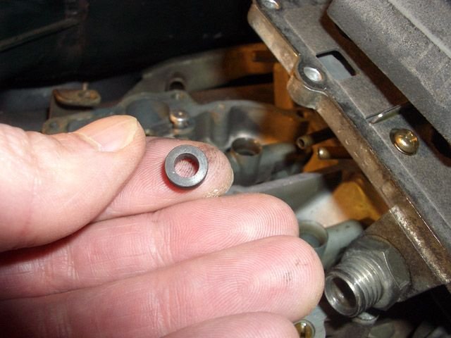

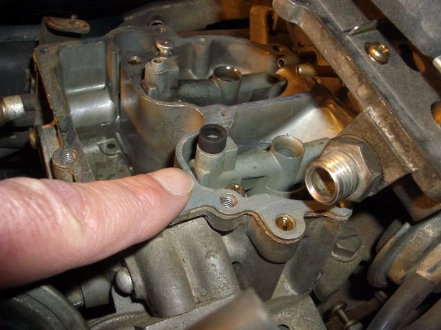

Here's the rubber washer I lost one of, and where (I think) it goes. Notice the missing one over there on the other barrel. What does this do? What are those passages for?

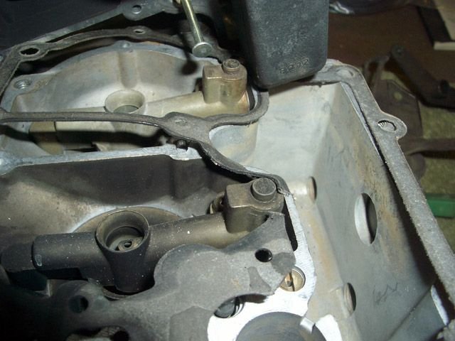

Here is my spare carb I have on my bench I use for practice and understanding stuff. Even though it came off a 60, it does not have those two passages, they are closed off.

Update: Jim C. says on Mud that the rubber washers are for the HAC system, and since the HAC should always be on at our elevation, missing one won't make any difference.
