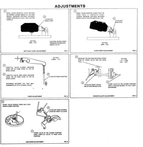

Martin and Marco are correct, there are side adjusting tabs and a center. All three are used to set the full range of motion for the float. Here is a picture, the side tabs controls how "low" the float drops and the center tab controls how "hight" the float rises.

I don't have anything to add, but I am posting this diagram to the RS website just in case photobucket goes kaput someday in the future.
