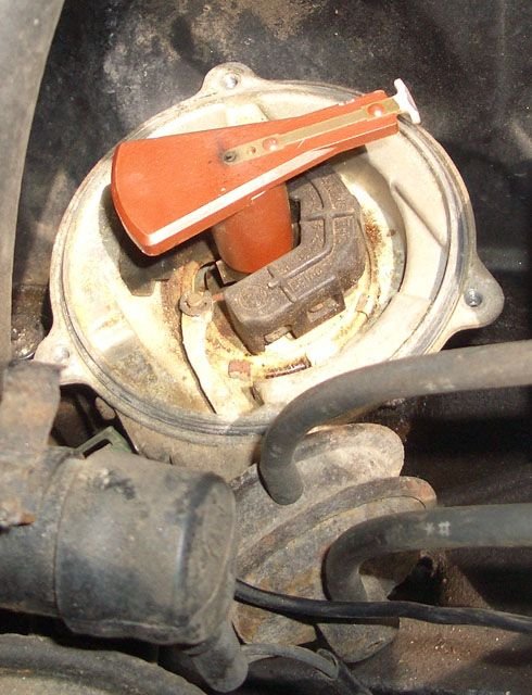

Well I am still dealing with this issue, but keep working through potential causes and eliminating things one by one. One of the things that occurred to me is that 60s have two vacuum advance diaphragms, one for the spark control and the other for the High Altitude Compensation (HAC) system. The latter is supposed to simply give an extra 7° whenever you are over approximately 4,000 feet elevation, which is everywhere around here. The former is supposed to kick in here and there and is more an emissions thing (the manual says it is a retard).
Anyway, my thinking was that maybe one of these was kicking in when it wasn't supposed to, or not kicking in when it was supposed to. When I smogged this rig I discovered the static advance was set at 17°, which is really far for a 60. Robbie thought that maybe the distributor had been installed off by a tooth, but the advance reading I got was from a dial back light, so it really doesn't matter which teeth are engaged with the cam.
When I took the cap off, this is what it looked like - pretty corroded!

60wag
2,625
There is a bearing below the stuff shown in the pic for the mechanical advance. It is likely corroded and not moving as it should.
8,757
Okay, so that looks pretty corroded. But remember, this rig runs GREAT at all throttle positions above idle.
So to see what's going on with the diaphragms, I got out my Mity-Vac. Normally I use it for one man brake bleeding, but I made a tube adapter out of two different diameter tubes to go from the Mity-Vac to the little vacuum ports on the diaphragms.
First I hooked it to the inside spark control diaphragm. I squeezed the trigger and nothing happened. I disconnected and thought maybe my tubing had a leak. Nope, one pump up to 10" on the gauge, two pumps up to 20" and holding on the gauge when I put my finger over the hole at the end of the tubing. Try again, same result.
So the spark control diaphragm has a leak and is inoperative.
Next I tried the outside (HAC) diaphragm. This time it held vacuum, but didn't budge the distributor. Not really surprising seeing how corroded the inside of the distributor body is.
So neither vacuum diaphragms are doing anything. Good or bad.
Basically all I have is static and (hopefully) centrifugal advance. I think the centrifugal advance is working because I remember that when I was dorking around with the timing for emissions that it changed with RPMs.
At the end of the day, I don't think the timing is causing my intermittent stalling at idle issue. It will be good to get that working again though, and fortunately I do have a spare used 60 distributor. I just need to give it a good work over to make sure I am not wasting my time if I put it in.

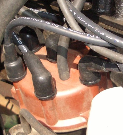

While I was at it, I replace the plug wires with new OEM from Stevinson. We had a horrible stumbling problem at highway speed when driving through a torrential downpour on a road trip and it went away when we got out of the rain and things dried out. I figured the old, aftermarket wires were old and likely leaky. Odd thing about the new OEM wires is that number 2 and number 5 are straight and all the rest are right angles. Note the Yazaki OEM wires are even numbered!

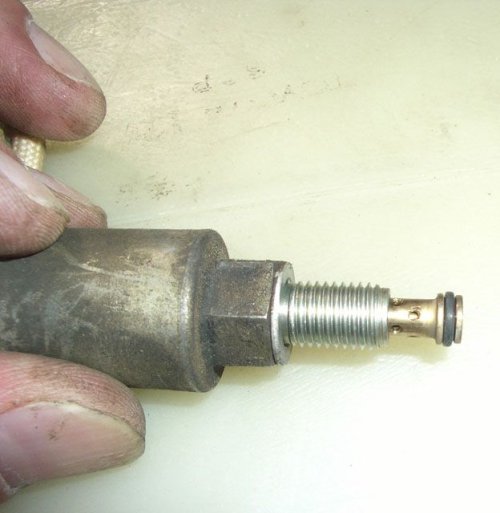

So at this point, I am pretty sure I have some kind of obstruction in the idle fuel circuit. When I was up at Joe Callejas, his tech suggested that what he would try is to remove the idle solenoid and the idle mixture screw and spray carb cleaner through that passage. That makes total sense.
Further, when I was at the meeting earlier this month I pulled Robbie aside and asked him and he suggested that he had seen where in some cases, the o-ring on the idle solenoid deteriorated and little pieces of it could clog up that passage. He said he would check for that.
So that's what I did.
I took the idle solenoid out and inspected it. The o-ring was fine. Then I hooked it up and visually observed the operation of the plunger inside. It was working correctly. I sprayed carb cleaner through the port and observed it gushing out where I had removed the idle mixture screw. Then it occurred to me that the passage between the idle mixture screw and the throttle body might be obstructed. So I reamed it out.
Then I put everything back together and went for a test drive.
The good news is, I didn't bugger anything up, she drove great.
The bad news is, the intermittent stall at idle is unchanged.

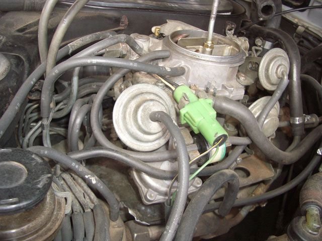

Taking advantage of the long weekend and nice weather, I worked some more on my 60. One of the things that a couple of people and I discussed at the Rally was the possibility that there was some kind of intermittent open in the power wiring to the idle fuel cut solenoid.
So I built a couple of pigtails with .250 female disconnects on one end and stripped copper at the other end. I plugged them in to the solenoid connector and then connected the other ends to the battery + terminal and ground respectively. A little risky I know without any fusing but this was just for a quick diagnostic.
When I connected the ground I heard the solenoid clicking it's little head off.
I drove around, and there was no change. Sometimes she'd idle when you roll to a stop, other times she'd stall.

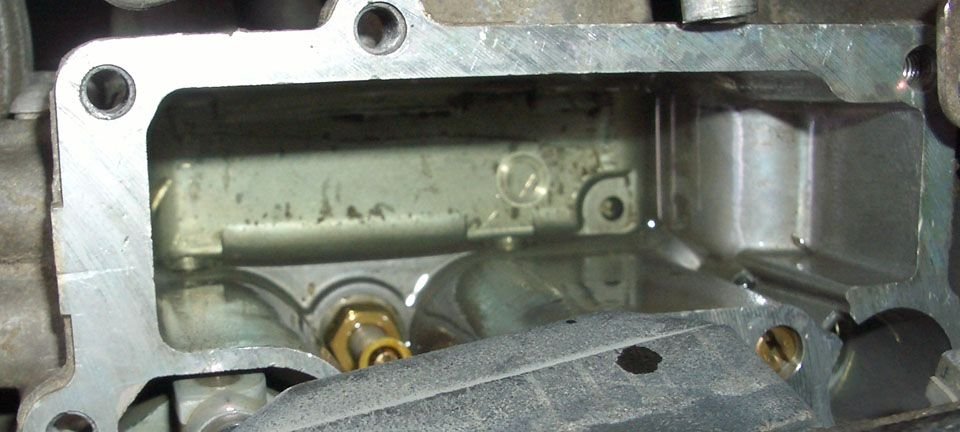

So the only thing that I haven't checked, out of all the various suggestions I have gotten is to actually take the top of the carb off and see what's going on in the float bowl.
Before I started I snapped a picture in case I couldn't remember how the spaghetti is supposed to reconnect.

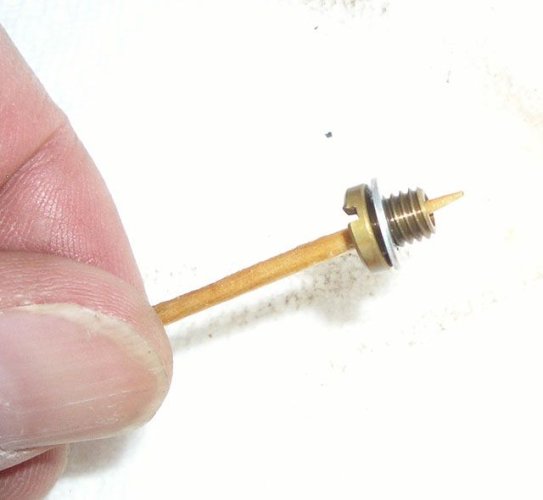

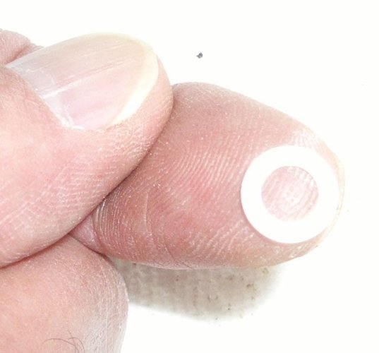

Once I got the top off and looked inside I found a washer from when I reinstalled the old jet after passing emissions! Eureka I think I found the problem! I took the jet out and put the washer on and then reinstalled it.

After I put everything back together and went for a test drive, I had good news and bad news.
The good news was that I didn't bugger anything up. :)
The bad news was that I didn't fix the problem. :(
I think I am going to pay Robbie to check it out, I am at wits end!
Again, everything was fine until I failed emissions. To pass emissions, I put in a leaner jet, put the timing back to factory 7° static, changed the air cleaner element and added some methanol to the fuel. She ran like crap but passed with flying colors.
