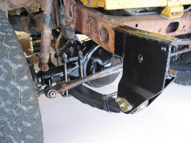

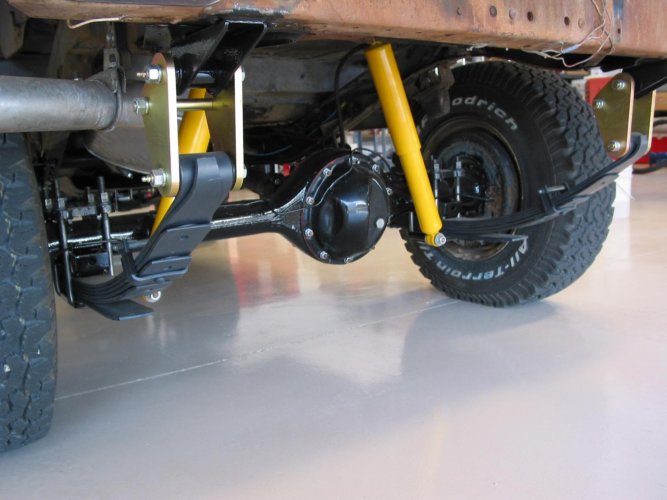

I went with the OME 2.5 springs and shocks with shackle reversal, which gave me about 4 inches of lift. U-Bolt flip kit but no SOA. Ride is very nice with good flex. Even my wife says it rides nice! :p: Terry

Nice Terry! From experience I recommend you gusset the inside of the frame at the back of the SR. It doesn't take much and a simple piece of 1 x.25 strap is sufficient to distribute the loading on the bottom of the frame to the whole frame.
Not sure I know where you mean - SR? t:confused:
14,144
Northside
Shackle Reverse = SR
ASCII art is not working for me....
At the rear-ward vertical plane of the front Shackle Reverse bracket you need to add a gusset inside the frame channel so the loading of the spring on the non boxed frame can be shared top and bottom

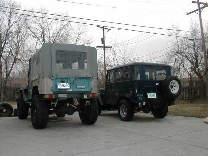

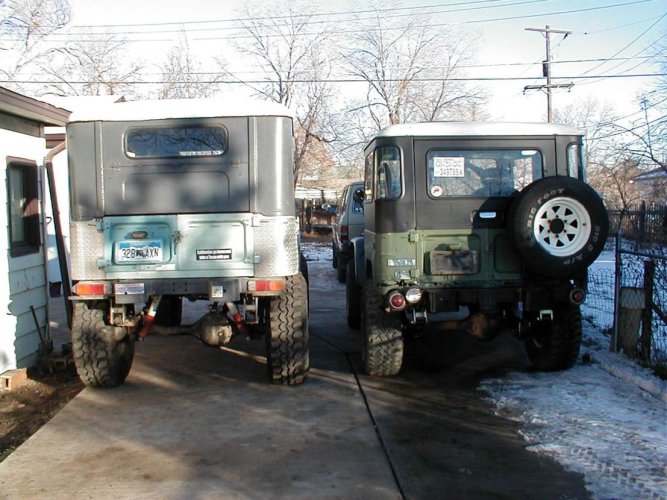

mo, i ran skyjacker 4" springs for years. i got one of the first few sets. loved them and they rode better than stock. their shocks worked well with the lift, but i had issues with the eyes ripping off two of them.
if i had another 40, i would go to them again. i wouldn't bother with another soa40 just because i don't hard core wheel enough. soa, you don't run anything smaller than a 36 or you'll look like a dork. so now figure on the lift, plus the larger tire...soa is huge.
pics of various lifts for comparison. soa with 36s vs. stock 235s & soa 36s vs. 4" downey and 33s (granted, my early top is a touch taller than the roofline of the 66 and later tops). btw, same two cruisers.
Got it, good point, thanks Kevin. t:thumb:

Thanks Ige that is very helpful. I always like comparisons. I do like the looks of the 4" downy. I assume the fenders had been cut???? I am planing on cutting the rear fenders, and adding Bushwhackers.
