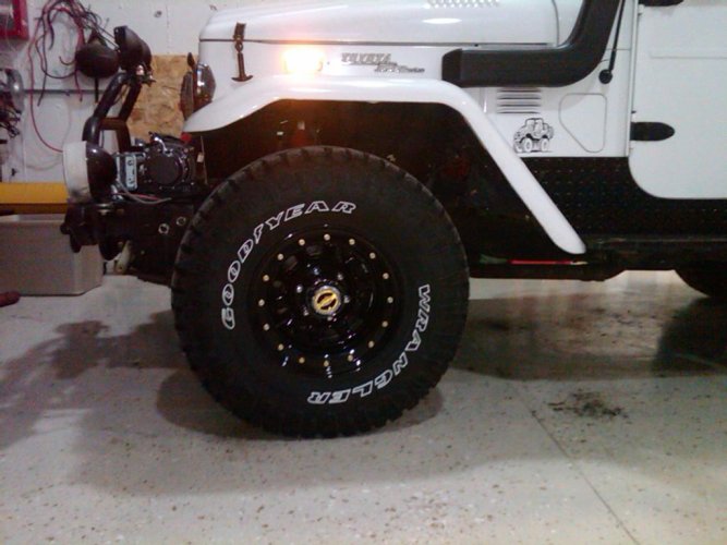

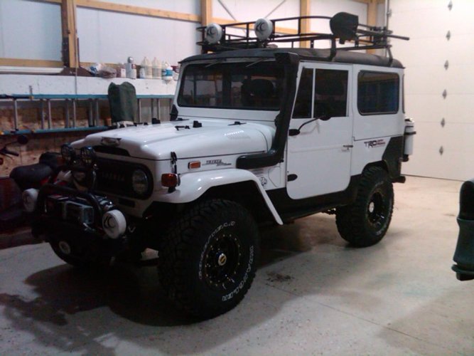

I have added a couple of pics. have an OME 2 1/2" with 15" Pro Comp Wheels with a 3 1/2" back space. I just put on the 33x12.50x15 and have plenty of room for full turns. I do have power steering, so that makes the turning easier. I could fit in a 7' garage if I didn't have my rack on top. Good luck.
Thanks alot! BTW...Beautiful looking '40 You don't rub in the rear at all? I do like the stance that the OME gave you.
