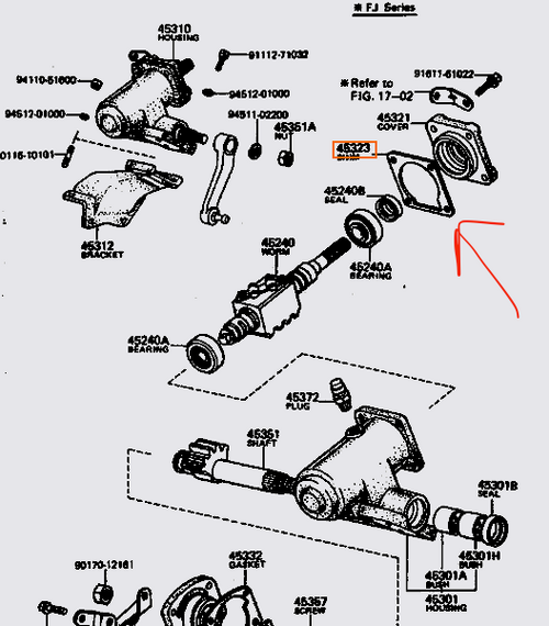

Corbet Moderator Staff member Joined Oct 24, 2006 Messages 9,990 Location Durango, Colorado Mar 11, 2026 #21 Pretty sure that is all one assembly with the sector shaft.
Jacket Moderator Staff member Joined Feb 3, 2006 Messages 5,462 Location Lafayette Mar 11, 2026 #22 As mentioned, you can also try changing/removing shims at the plate above the worm gear shaft. Might help find a less worn contact patch with the sector shaft.

Jacket Moderator Staff member Joined Feb 3, 2006 Messages 5,462 Location Lafayette Mar 11, 2026 #23 This guy
60wag Rising Sun Member Joined Aug 23, 2005 Messages 2,673 Mar 11, 2026 #24 Isn’t that shim for the preload on the bearings on the ball screw (worm gear)?
CardinalFJ60 Rising Sun Member Joined Aug 23, 2005 Messages 2,848 Location Lafayette Mar 11, 2026 #25 Aaah that worm gear wear maybe not so much that other one.
Jacket Moderator Staff member Joined Feb 3, 2006 Messages 5,462 Location Lafayette Mar 12, 2026 #26 60wag said: Isn’t that shim for the preload on the bearings on the ball screw (worm gear)? Click to expand... For sure. But I think it also impacts the way the gear teeth mesh and align so you might find a different pattern that reduces some of the slop.

60wag Rising Sun Member Joined Aug 23, 2005 Messages 2,673 Mar 13, 2026 #27 Can you flip the ball nut over 180 deg? That might change how the sector shaft and the ball nut mate.
