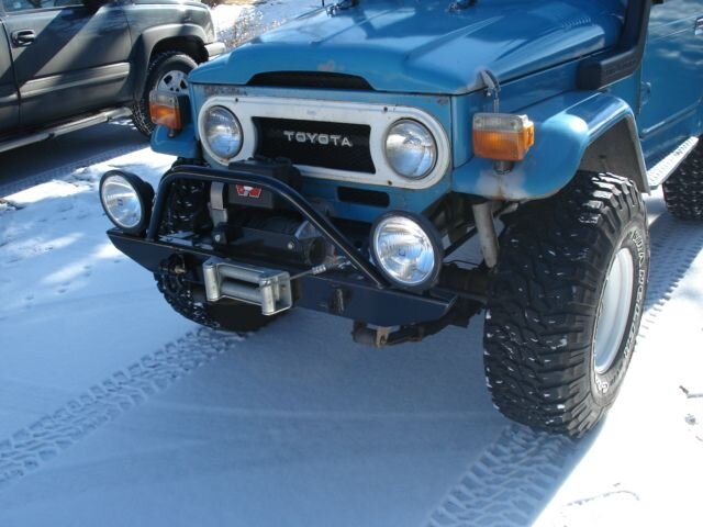

Here is how to improve a 40's headlights... :D
135w bulbs in each one, but I did have to create an entirely new wiring setup from the battery to make it happen.
Talk about high beams! :D:hill:

Drew, my bumper doesn't really have a place to mount lights like that, but I can believe that when you go to high beams you go to HIGH BEAMS! :D
