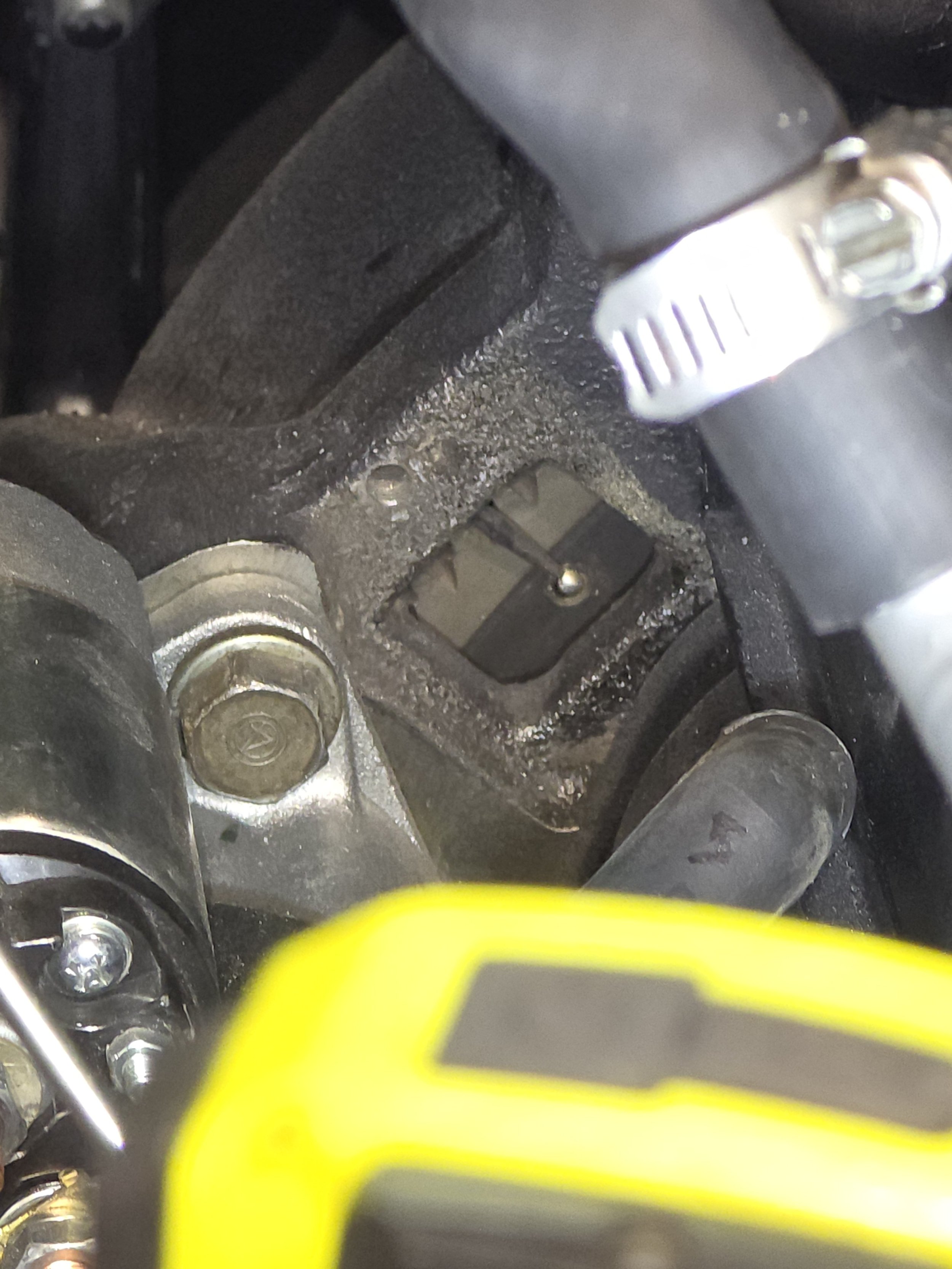

Are you sure you are not 180 out on the distributor, I have had engines act like this when they are 180 out? You can check by rotating the engine until you are on the timing mark on the flywheel and if the first and second rockers are not in contact with the valve and the rotor is roughly pointing at the #4 plug you are at TDC.
@Capriblue45, I am not certain of anything at this point. lol. Here are the photos I took when I set the distributor right before this video was taken. Looks right to me, but maybe the first valve is not quite right?
