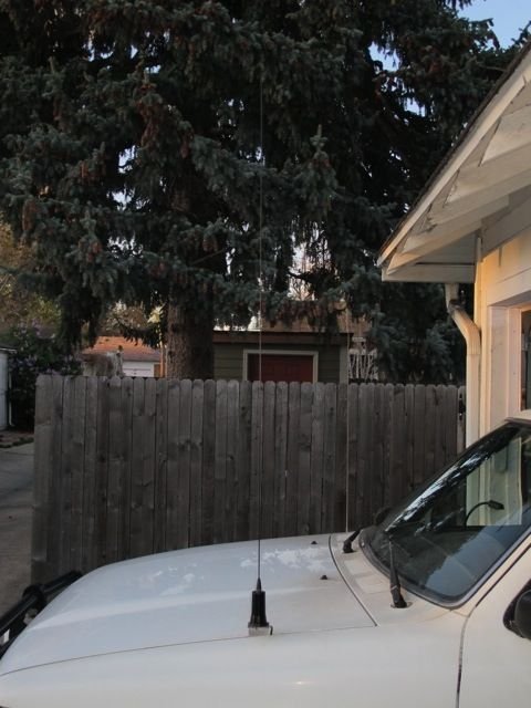

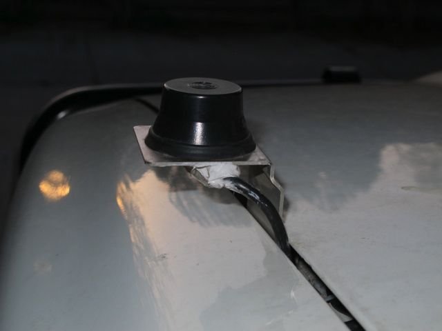

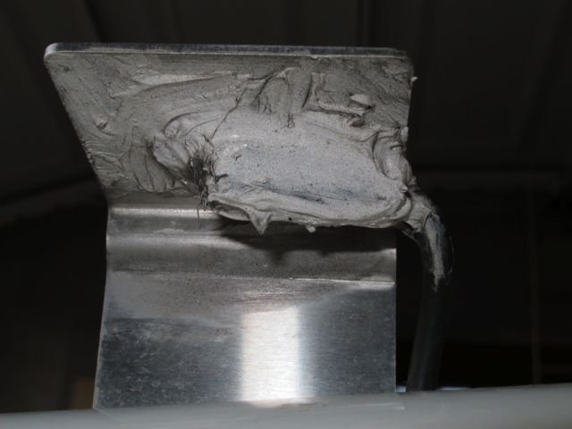

The Nak fender mount works well with NMO mounts, so I would suggest you get a Larsen NMO-K mount and Larsen NMO27. This is the combination I run, I goop silicone on the under side to seal it. They have them at HRO if want and I'll snap some photos tomorrow.

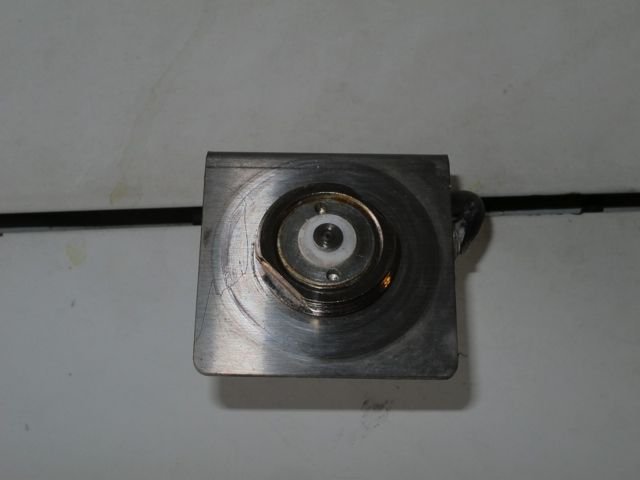

Looks like that antenna is 53" long? I was looking at a 36" Friestik. I like the shorter length better personally. But I do see that HRO hole size looks better for Nakman's bracket. The firestik needs a 16mm hole rather than 20mm I working with.

Yeah, Larsen is commercial type stuff and isn't particularly cheap. I've had this antenna for about 8 years and it's holding up so far. Knock wood... I have a second whip that I cut for 10m, so it can be pressed into service for ham use, although I don't have a mobile HF rig in the truck anymore.
BTW, the hole in Nak's mount is 3/4", which is designed for an NMO and they fit perfect. If you do use a different mount, it's fairly oversized. What I did for the ATAS-120 (which mounts on a SO239) was to drill a 1" disc from thin aluminum plate and then drill a 5/8" hole in the center to use as a washer. This works fine for most types of mounts that have plenty of threads but does make everything pretty thick.

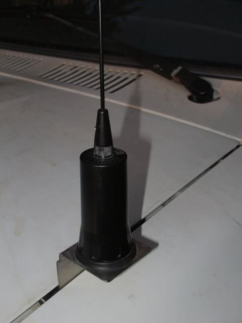

The mount, NMO base and Larsen NMO27B.
that's what I have on my rig. I like the setup a lot. Especially since it easy to remove the antenna when not in use

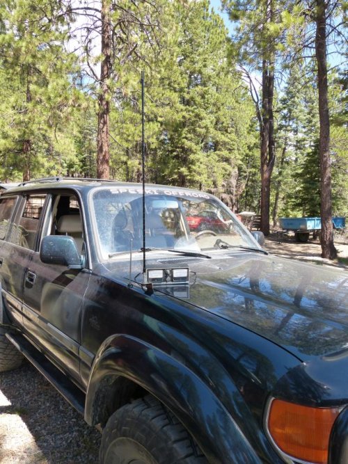

FireFly 3' installed

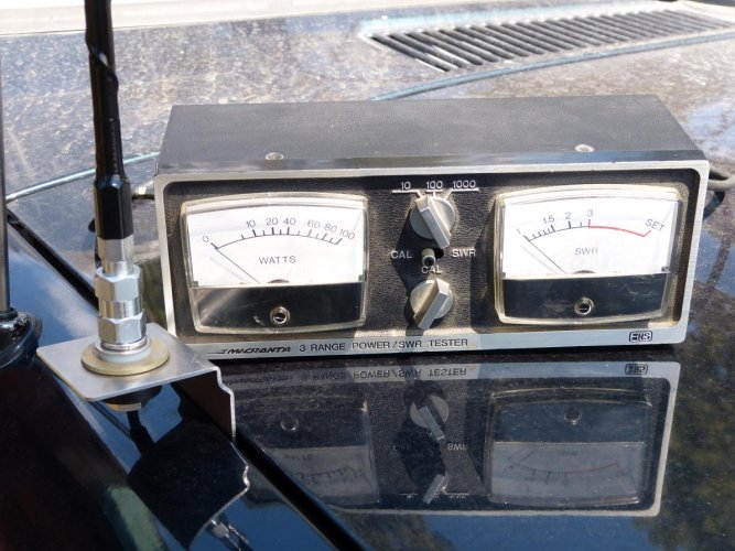

Installed the FireStik FireFly 3' antenna and tuned the SWR today.
For the record, part numbers:
FL3-B - Black 3' FireStik FireFly
MU-8R9 - coax with "RireRing"
K-4R - mounting stud for "FireRing"
Gamiviti fender mount.
I had to use a pair of large washers on the mount as Tim's mount is drilled for NMO. On the radio end of the coax there is a removable fitting so you don't have to pull the standard CB 3/4" fitting through a grommet. I liked that as I was able to use an OEM grommet on the passenger side of my 80.
Everything is working good so far. I might look for some stainless steel washers to replace the cadmium ones I had laying around. SWR measures out about 2.4 (little high) on the far ends of the cb channels and about .1 on channel 19. Should be all set for CM12.
