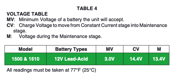

Note that the 1510 is intended for plain lead acid, the stage voltages:
Also, the model 1500 is the same charger as the 1510 but comes with fewer accessories so will be a few Dollars cheaper. If you cut off connectors and use PowerPoles the ring adapter and alligator clips may be unnecessary.

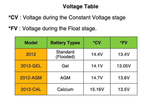

The next up charger BatteryMindr sells is the model 2012. It is IP65 rated so can handle a little bit more environmental stuff if you might use it outside or somewhere like that. These are around $100, give or take. It's a similar class of charger otherwise, just slightly more current and adds a battery test. Neither of those are worth the extra money so you'd have to need the IP65 rating to justify it.
However, the main electrical feature difference is you can get a model 2012 specific to your battery type. So if you have an X2 or Odyssey you get the option of one with a higher voltage. Unfortunately to get one selectable for type you have to step up yet again to a 128CEC.
Getting the AGM one would probably be worth the extra money if you've gone with one of the high end batteries. Not absolutely critical if you're just floating to have the slightly higher voltage. More important to have the absorption (CV) voltage right during charging, if you're doing that routinely.
