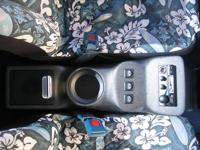

Hey, if you want to take a look at what I ended up with on the Chili for a center console, give a gander sometime. It turned out to be the easiest center console solution (my driveline is 3"+ forward, so there were not as many options for me). It is my third design, so I suppose I worked the bugs out. :D
Plasma rules when cutting sheet steel, you are welcome to come over if you need.

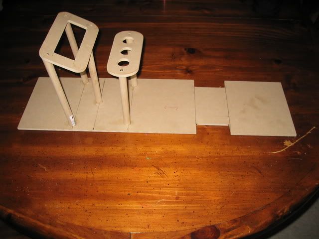

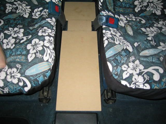

I'm actually going to try to build one using the tricks that the tuner kids use to build sub boxes.
However, if that doesn't work out, I'll be over to see your stuff for sure.

Holy cow, that's slick.

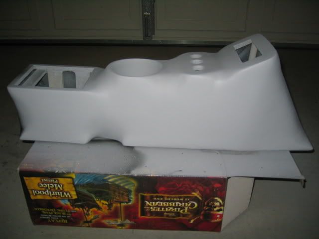

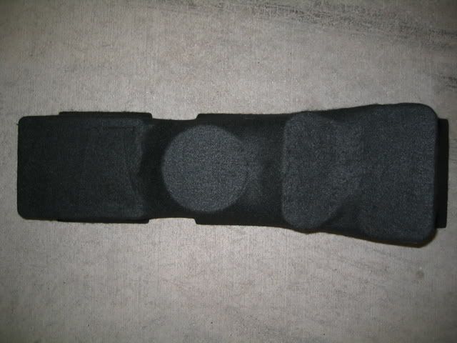

Aparantly not hard either. Just takes patience and sanding.
Essentially, you build the frame, then stretch fabric (usually felt) over it. Staple down the felt. Coat it in fiberglass resin, then fiber glass. Sand until your desired texture is achieved.
Mostly done for custom trunk sub enclosures for show cars.
