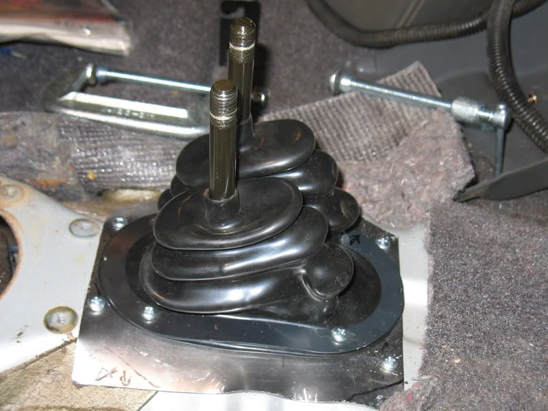

Got my cover plate built and installed.
I will be painting the silver part of the shift knobs silver again, to cover the current markings, and then getting my brother, who is quite an artist, to draw on my new shift patterns, then cover with a clear coat. I like the factory knobs a lot better than the crappy marlin ones.
