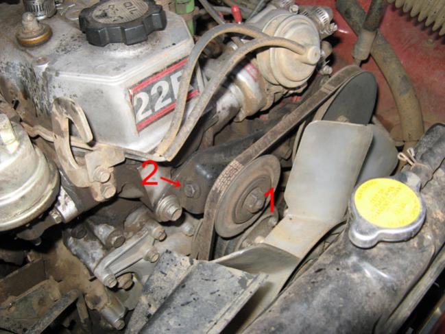

At 4000 RPM I get a horrible belt squeal at the moment (I think related to the probably shot power steering pump pulley). Going up the steep hills on the way to Boulder from Golden, I can't get it to 4000 RPM in 3rd gear. Usually I end up at 3500 RPM. Probably my compression is a bit low or maybe it's the original engine with no over-boring.

Your squeal is might be the belt tensioner/idler. Mine starts making noise once in a while.
Top, middle of the engine directly above the water pump there's a pulley with a bolt coming out towards the intake. Spray behind the front washer on the bearing in the middle with WD40 and see if the noise goes away. Try not to spray too much on the belt so it doesn't slip. If it quiets down it's very easy to rebuilt and NAPA has the bearing. Loosen nut 1 just a little, and turn bolt 2 anticlockwise to remove tension from the belt. Then remove the pulley completely, the bearing is retained IIRC with a snap ring.
My PS pump is also making noise, but it's not a squeal. It also goes away after about 30 seconds once the pump starts warming up.

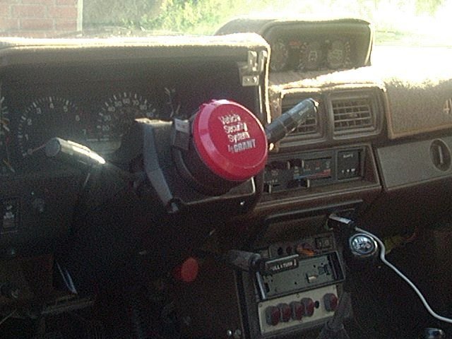

Also, which anti theft device did you go with? I'm looking into one for my truck due to the fact that I've spent more on this truck than I would ever get from the insurance company.

There are many ways to keep your truck where you left it, but I think this is one of the best because it's brain dead easy for the jackass to see. This along with your clever ignition or fuel cut makes 90% of the thefts unlikely. They might still take it on a flatbed but that's more when your truck become high profile and targeted. Most of the time Toyota trucks are stolen because they are easy (there's not many different key cuts across 1979 to 1995, so your keys probably work in a lot of other trucks) and valuable for spares.
Thanks! Once I have time in the garage (can't be in the garage if the weather is threatening because my girlfriend's car takes precedence in the event of hail), I'll check out that belt tensioner/idler.
There are some convenient places in the harness both in the engine bay and in the dash that you can interrupt to prevent the truck from starting. Mad Max Fury Road is a good source of inspiration for interesting switch patterns to immobilize the vehicle. I'd rather not publicly disclose my specific scheme for immobilization on a public forum. :thumb: However I can show you in the wiring diagrams some convenient places to dig into.
