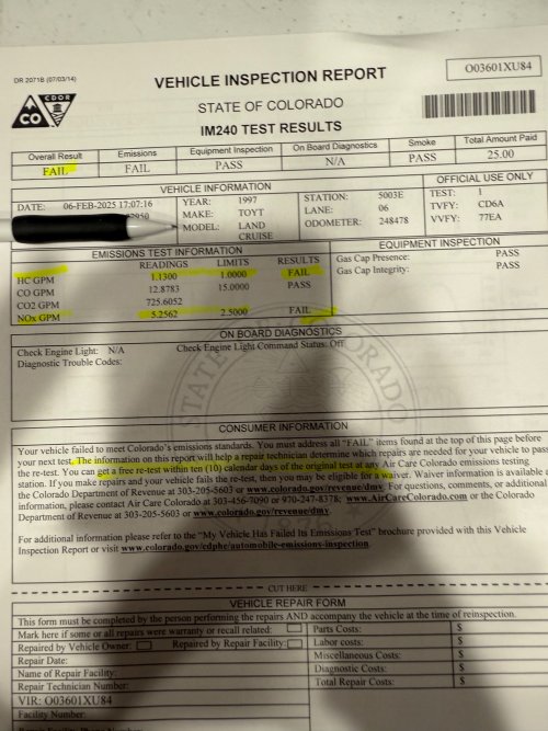

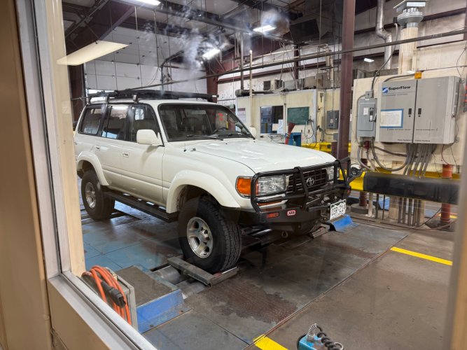

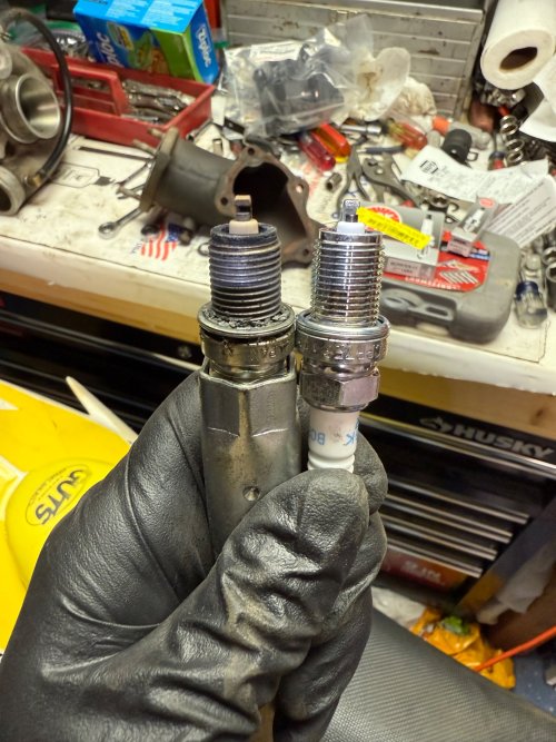

So while the green 80 is still down, the white 80 failed to pass emissions for the first time ever. New exhaust and cats two years ago at last emissions test, cleanest report I think I ever saw.
Now high on HC and NOx. Going to replace air filter, spark plugs, cap, rotor to start. I think the guy had it in 2nd gear the whole test, not sure if that makes a difference so might try retesting just for grins. I hope the cats aren’t toast already.

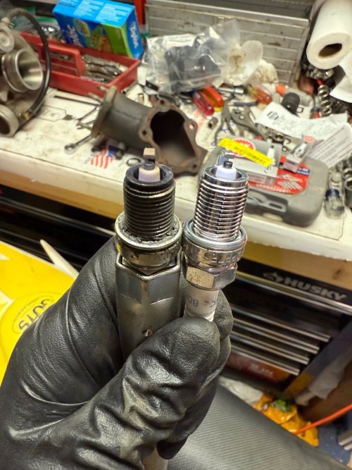

Spark plugs, cap and rotor looked perfect so doubt that will change much.

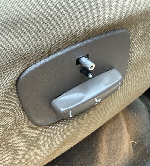

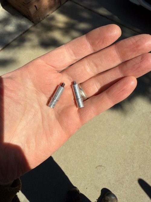

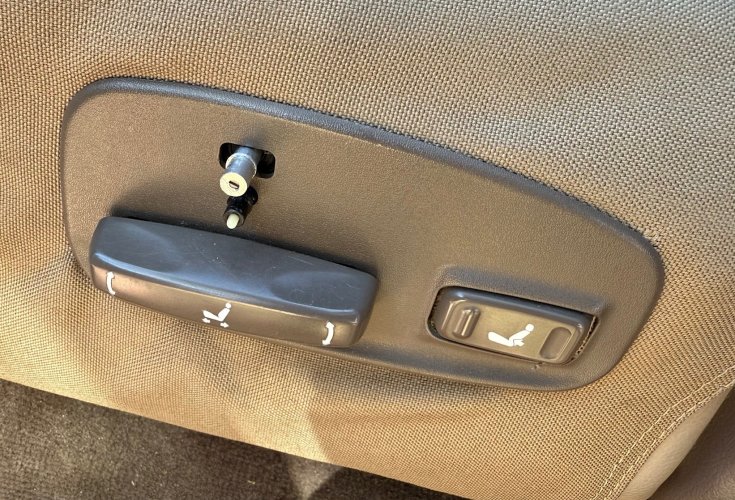

Something from the PO that I have never yet fixed: broken recline switch knobs.
I watched the texasknowhow YouTube video on fixing this a few years ago but never got up the gumption until this week.
Went to Ace hardware, built a couple studs, drilled and tapped the switch, glued and hoping they will work and not break again. We don't slide our butts out of the seats but use the sliders to step up and out of the seats. Hopefully that will help.
Outer stud is 1/4” dia. Aluminum spacer, threaded inside 6-32, 0.30” long
Washer is aluminum, 0.29” diameter
Inner stud is same as outer, but cut so total assembly length is 0.885”. Held together with two set screws 6-32 x 1/2” long.

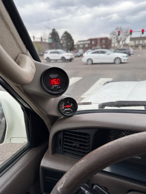

On the white 80, the wide band digital readout was not working when I bought it, so I could never determine my actual AFR. Recently the boost gauge stopped working too. I sent them both back to Autometer and they checked them out.
They rebuilt the wide band for me, and replaced the boost gauge. It was so old they couldn’t rebuilt it.
Got them back today and they are both installed and working great!

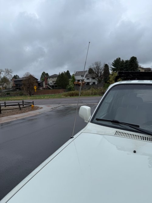

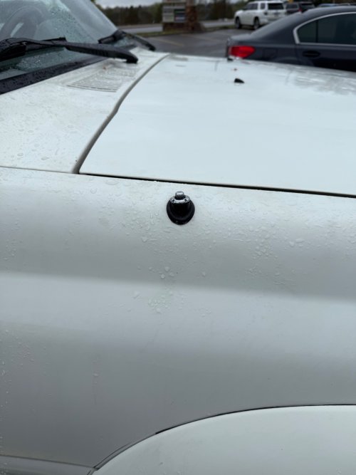

The white 80’s antenna broke within days of purchase back in 2019. When it broke something was preventing it from fully retracting so it was always sticking up about 5 or 6”.
The 1997 design is different than what I was used to with the green 1996, in that when the radio is turned on the 1997 auto-raises the antenna a minimum of about 3”, or to the last-used height position. And then when the radio is turned off it auto-retracts all the way down. By contrast, the 96 is fully manual.
My theory is that the 97 antenna gets a lot more use due to the auto up/down, and therefore might have a tendency to wear out faster.
Anyway today was new antenna day, and now it works perfect. Took about 3 hours, and I never was able to pull the motor out of the fender. Not enough slack in the antenna cable from the radio. I had to take the screws off the motor while the thing was still inside the fender.

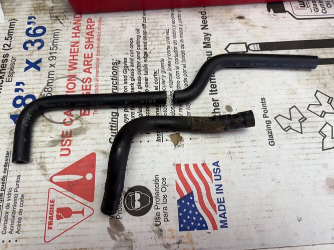

In Dec. 2022 the low pressure power steering hose from the gear to the cooler on my white 80 blew at 235,000 miles. This weekend the hose on the green 80 blew at about 232,000 miles. We were at Browns Lake off Mt. Antero Road, so had to drive home about 4 hours before parking it. I poured a little fluid into the reservoir periodically on the drive home, but initial test showed that from full to empty reservoir took about 4 minutes. So couldn't realistically stop that often to keep it topped up. It got us home, but will have to see about long-term consequences of running "dry."
44412-28160 from the Previa is the MUD recommended replacement, but I believe is discontinued.
On the white 80, I found the generic 3/8” TOC hose inadequate-too tight to fit:
eb48b733-68e6-4152-95aa-04c650f2c717-jpeg.110152
Thankfully I had bought two Previa hoses when the white 80 blew, so I could cut it up to fit on the green 80. However I noticed that the busted hoses on the two vehicles were different. So in the end I came up with two different solutions for how to cut the Previa hose. Here is the hose that blew, and how I cut the Previa hose for the white 80 (I used the middle portion with the 45 degree bend):
b42efb6c-d41a-4995-8242-a5a690847eb2-jpeg.110430
Here is what I came up with for the green 80: original hose on bottom (note it doesn’t look like the white 80 original hose), cut Previa hose on top (I used the left half):
For future alternatives, I found 44412-60280 from a 100 series which might have the right bends to work. 44412-60430 from a 2009-2013 1GR 4Runner may also be a possibility. A couple others that also look promising - 44412-35091 from 1989-1995 4runner/Pickup and 44412-35100 from 1988-2004 Hilux. I think I also saw something from a 2002-ish Corolla that would be worth researching. Just taking notes for future.
