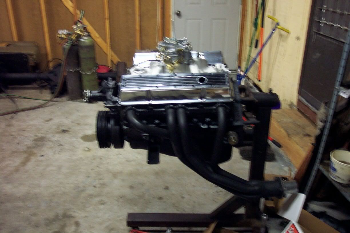

Have you spotted this?
Looks like a few upgrades you could use. Hope the wife doesn't hate me now..... ;)
the engine is tempting :) the links are gone :(
Sill working for me...Were you looking for a pic of the engine? Here you go...
No purple on it though :hill:
