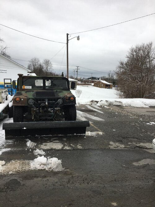

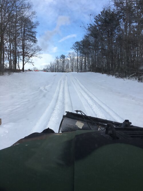

Abe you don’t want the HMMWV Goodyear Wrangler MT’s for snow plowing…ask me how I know. Especially not where you live! While they might be ok for on the road as they are a hard tread and wear well they need to be siped at a minimum. Also I found that their width will work against you for traction as it reduces your PSI on the ground. Chains might help? I have a set of chains for them but never put them on. Again…this is just my humble opinion. But to be fair I did use the MT’s to plow with on my M1097A2 while the M1028A2 was getting LS swapped.
If you’re going to get HMMWV tires…I would go after either the Wrangler Enforcer MT’s (they used to be called the MTR’s) or the BFG Baja’s. Just be sure to look at the DOT date code!!!
