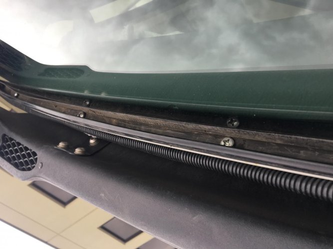

He told me technically he's supposed to stop and send me to a body shop. But agreed to just slather on the primer and glue and put a new window on. I guess to really do this right I should have him come pull it in my garage, then return in a week after I have cleaned it up a little better. Not that I'd likely cut out and weld, but I could see at least wire wheeling it then skimming it with bondo. Is the much better than what I have though?
Here are my screws

15,725
Sure is clean though. And substantially less cracked! Total bill $283.42.

Not normal. Should not make any sound. Would have probably also insisted he use rivets and not screws. I understand someone did it incorrectly prior and used screws but not sure why that means he had to do it incorrectly again. If the holes were drilled out you just use a slightly bigger rivet, this was done on my old 100. Your also missing the plastic strips that go into the channel to cover up the rivet or in this case screw heads.

I don't think the side trims will sit flush over the screw heads, I think that's why mine were loose an one blew away.
15,725
Those strips that cover the screw heads are in there, that pic was just before they were reinstalled. But those side channels aren't holding the window down, they are really just cosmetic, in my case they are holding my wire loom in place.. bigger rivets would be just as tight as the screws, the squeaks are all around the perimeter of the window. This was squeaking on my way home, 3 hours after install-
