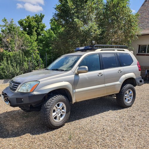

Just got the roof rack installed..
Does this thing have the adjustable hight control? It's looking great! Also curious if having the bumpers so close to the body will cause rubbing while the frame flexes.
No, I removed all the stock suspension when I installed the lift. I have the Metaltech bumpers on my other GX and although the clearances on this one are a bit tighter I don't think it will be a problem. We'll see 🙂.. the good thing, if it is an issue, I can change it..
