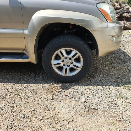

So, I ended up installing new Icon stage 5 on the silver GX, removed and rebuilt the Boss 2.5 coilovers shocks and UCA's to install on this rig.

Looks friggin amazing man. How'd you lay out the bumper parts?

Thanks Marco! Yeah this was a real learning event for me. Normally this would have been impossible without some sort of jig. Fortunately I had the same rig and bumper for comparison. I started the layout with that piece in the middle that has the 4 bolts (this piece alone was very difficult to get all the angles right), then just started adding and trimming as needed. There was lots of room for error as you can imagine but building it on the rig was the only way to go. It is turning out better than I expected. 😂
