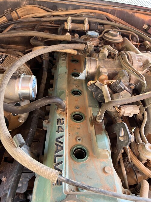

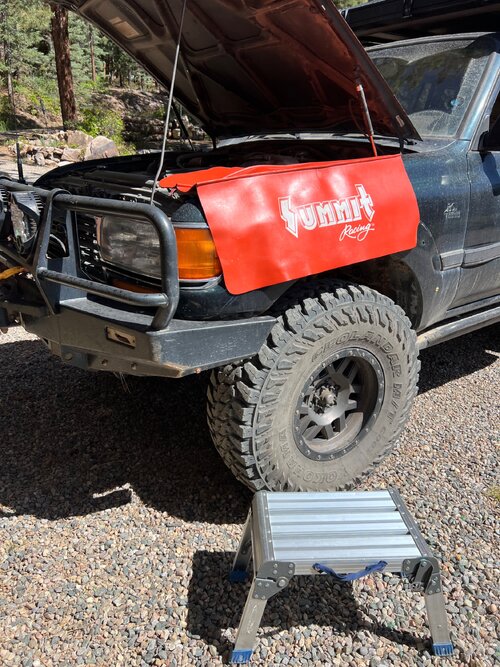

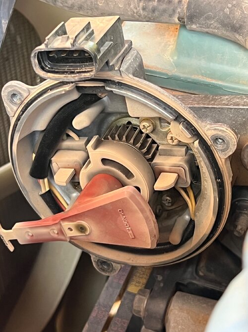

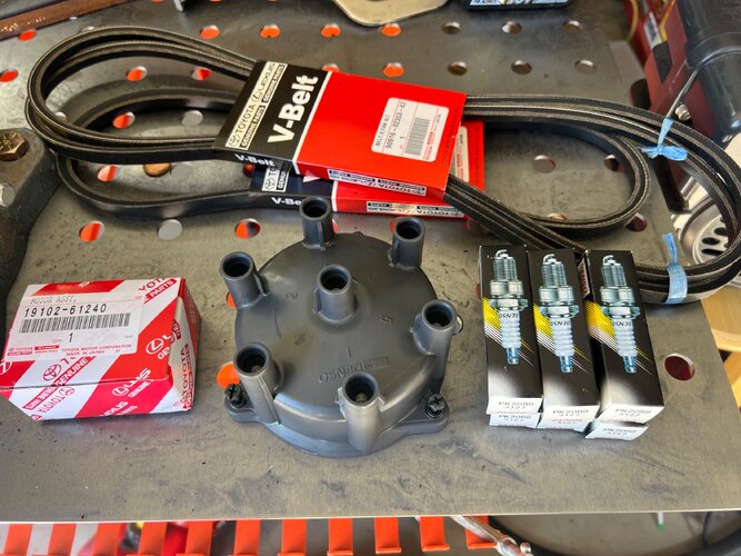

This is just PM at 291,137 miles but saving here for my records as well as your entertainment.
Belts, plugs, cap and rotor. I have not done these since the turbo got installed.
Even with the step stool it’s hard to reach stuff on my truck.
#3 looks a little oil fouled

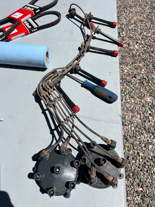

I like to lay out the cap and plugs wires on a table to swap in the new cap. No chance of connecting a plug wire in the wrong place if you don’t one at a time.

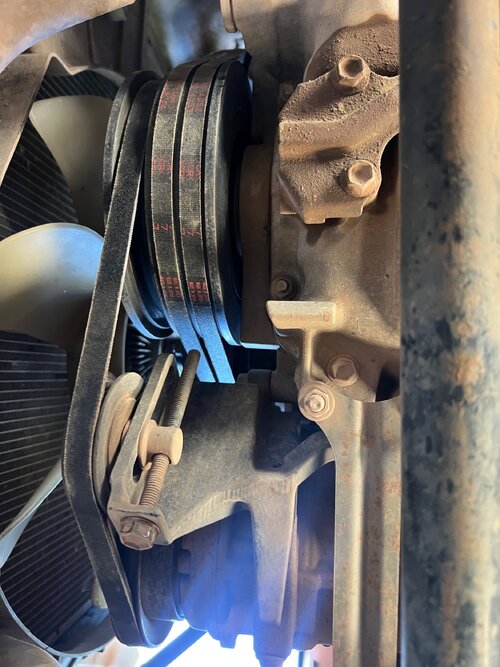

Belts installed. Much quieter now at idle. Old belts were stretched out and the AC belt was really noisy as a result.
