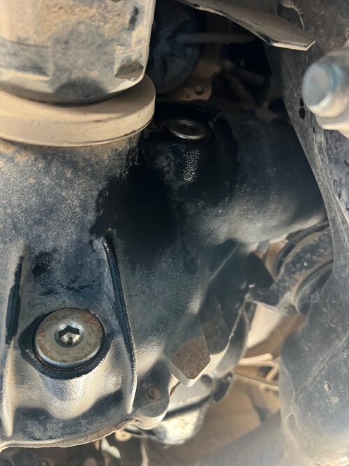

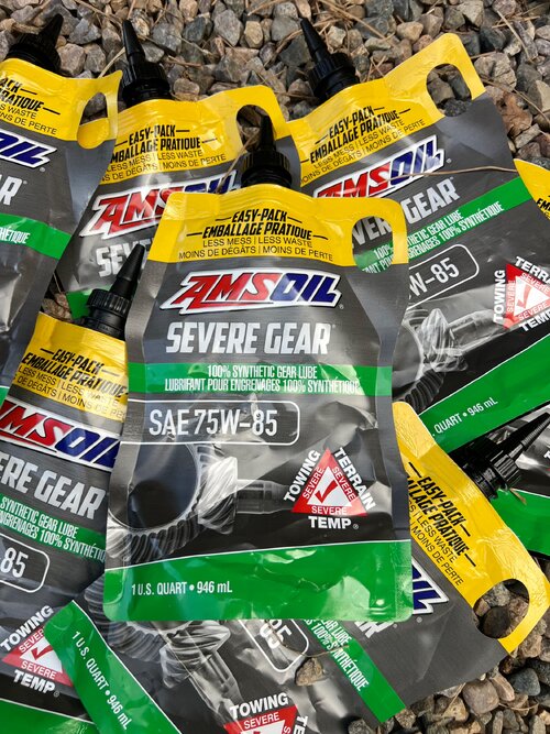

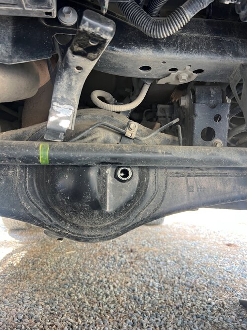

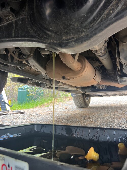

31,922 miles. More of a personal record than anything build related. Did the first differential services today. 8 quarts total needed for the job.
Feeding it the good stuff. First time I’ve ever used the oil in a bag. Happy I did, No space for the old style plastic bottles. The front there is definitely room for a “J” tube if you have a 5gallon bucket and pump. The panhard bar blocks the rear fill hole but pretty sure you’d still snake a J tube in there. Had to drop the spare to make room to work. The rear oil looked pretty clean, front was discolored. I’ll be doing this every 30K moving forward. The book prescribes it at this interval for severe duty.
My pro-tip is to do front first as it’s much harder to squeeze all the oil out of bag with clearances there in front. In the back you can kind of roll the bag to force all the oil out. So you can completely empty the bags you used up front.
One final note. It still baffles me why auto manufactures can’t use the same drain plug style or at least ones that use the same tool front and back. 10mm Allen front, 24mm socket and box wrench rear. The panard wouldn’t allow a standard 1/2” drive to fit on the rear fill plug so I just went straight to a big closed end box wrench. Maybe I’ll look for some Allen key style rear plugs. I sourced them for my 80 years ago.
