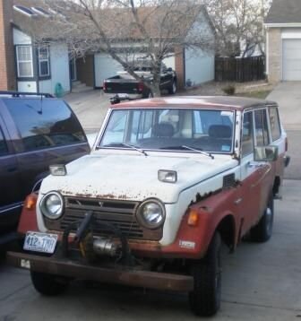

So here's the long awaited pic....in all of its rusty glory. Drum roll please!!!:rant:

:cool: Nice ride! :thumb:

Yep! Working Meyers 6.5' plow included.
The PO used it for plowing his drive in Evergreen for many years. The clutch master cylinder was bad and he thought there was a problem with the transmission. So he wanted to get it out of the drive before winter and now its Zach's. New clutch master cylinder and its fine. :lmao:
