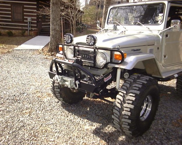

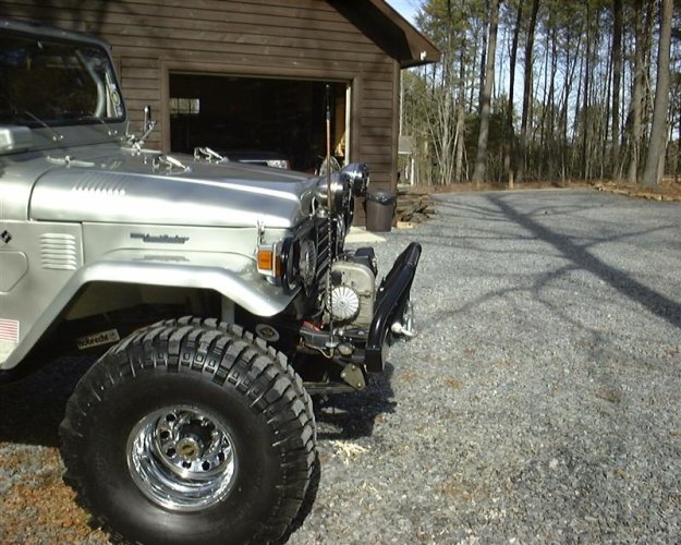

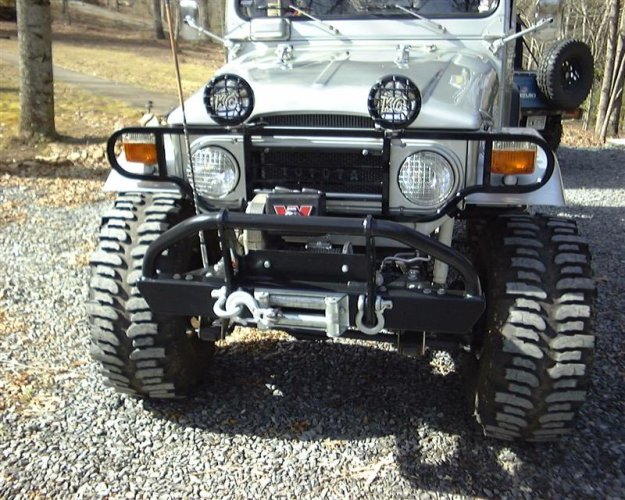

I'll have to find the pictures of the Cruiser that I "borrowed" my front end design from and post some up.
PM on the way as well

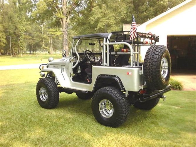

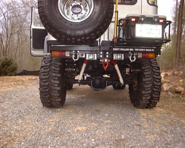

Edit: Added pics of the rig I patterned some of my 40 build up stuff after
