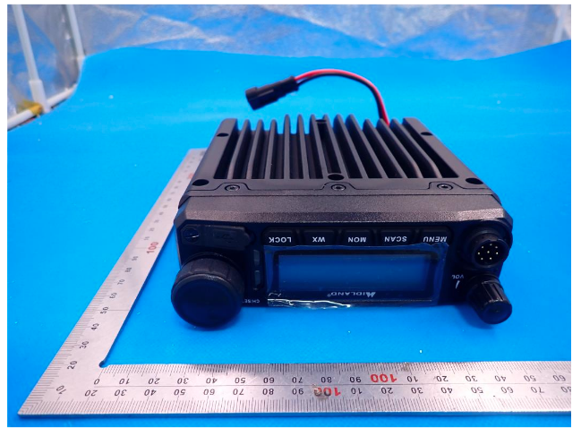

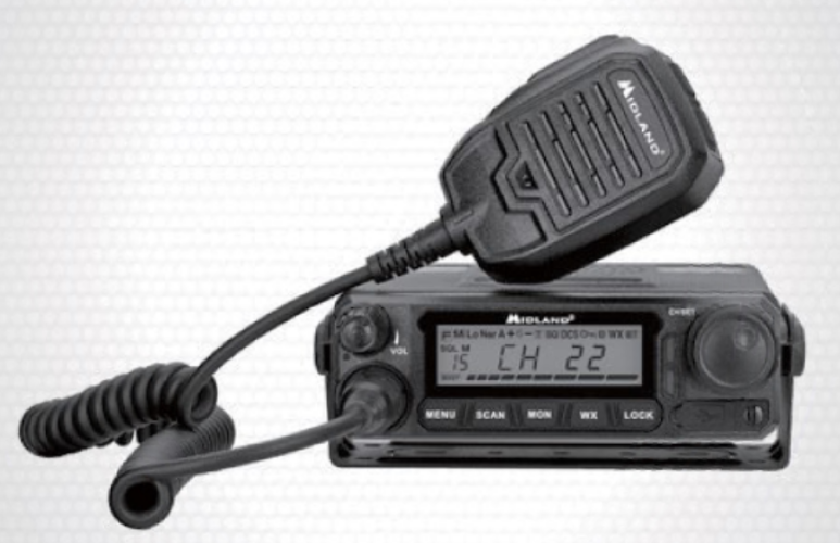

There's a few new mobiles radios coming.
Midland MXT500 - 50 watt traditional mobile. Notice the radio is upside down in this photo. Attention to detail by the test lab.

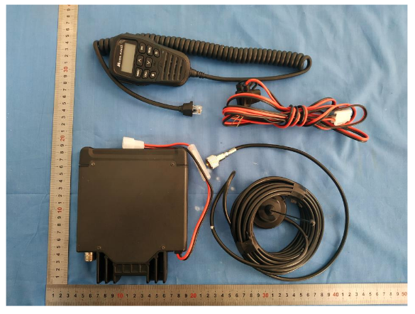

Midland MXT575 - Looks to be a remote mic/head like the MXT275 but 50 watts instead of 15.
Both are FCC listed now but I don't see them for sale yet. According to the test reports they are both wideband (16K0F3E, 20KHz) listed but it appears bandwidth may be selectable between narrow and wide.

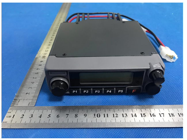

And Rugged has a couple of mobiles, the GMR25 and GMR45. I can't really recommend them at this point. Not really a problem performance-wise (they're cheap Chinese radios like any other) but their prices are pretty high compared to the original radio they rebadge.
They are rebadged TYT (looks like in the FCC database the TYT TH-8600 is GMR25 and TYT TH-9000D = GMR45).
TYT-9000 - There's some chatter that this radio is capable of separating the face from the body.
TYT-8600 - This is interesting because it's IP67, e.g. waterproof and 25 watts

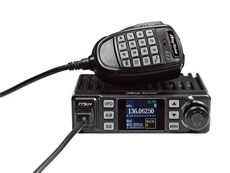

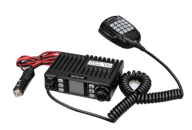

I saw this one reviewed on YouTube last night...Radioddity DB20-G, listed as 20W, but reviewer only got 15W on high power. Seems brand new.
Radioddity DB20-G
This appears to be a variant (or vice versa, this is a DB20G rebadged) of the Anytone AT779-UV: http://anytone.net/pro_info100.html
Another listed under the original FCC Anytone ID is the Retevis RA25: https://www.retevis.com/RA25-20W-GMRS-Mobile-Radio#A9198BX1
I'm only just become aware of this radio so can't yet say much about it feature-wise or technically.
But one thing generally is the size and heat sink are small for a 20W radio so I would expect this radio will get very hot, very quickly.

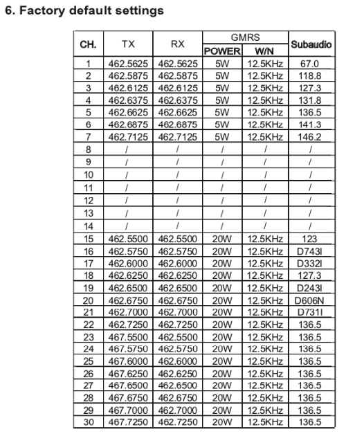

It also may be programmable, which could be important because the default channel assignments appear to have tones added which might need to be changed or removed. More investigation is required here. Pretty sure the radio has the option to turn on/off tones on both transmit and receive. Everyone will want to - turn off subtones - at this point.
This is what the Retevis RA25 shows in its user manual.
