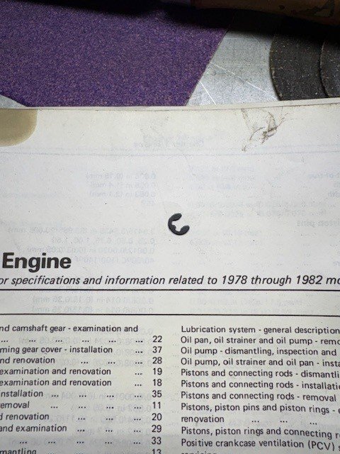

I have been chasing a gremlin in the AFI fuel injection on the 40 for the past 6 months. I have the same kit in the 60 and it runs like a dream. Went down the rabbit hole replacing a bunch of parts, the last being another GM ECM with the same results of random power shutdown. Yesterday I decided to pull the HEI distributor and give it one last test with the meter and to my surprise I found a tiny e-clip hanging around in the base of the dizzy. There are 4 small posts on the top of the advance mechanism that appear to be there for weights in the case of a vacuum advance setup. All I can figure is the e-clip must have been shorting between pickup points or the base from time to time and shutting down the ECM. When it died I just needed to pull the power lead to the ECM and the truck would fire right back up. Took her for a half hour drive this afternoon and no issues. Actually a bit of luck that I even spotted this little sucker.

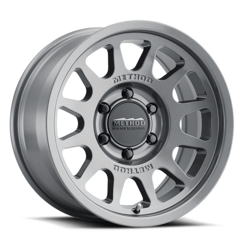

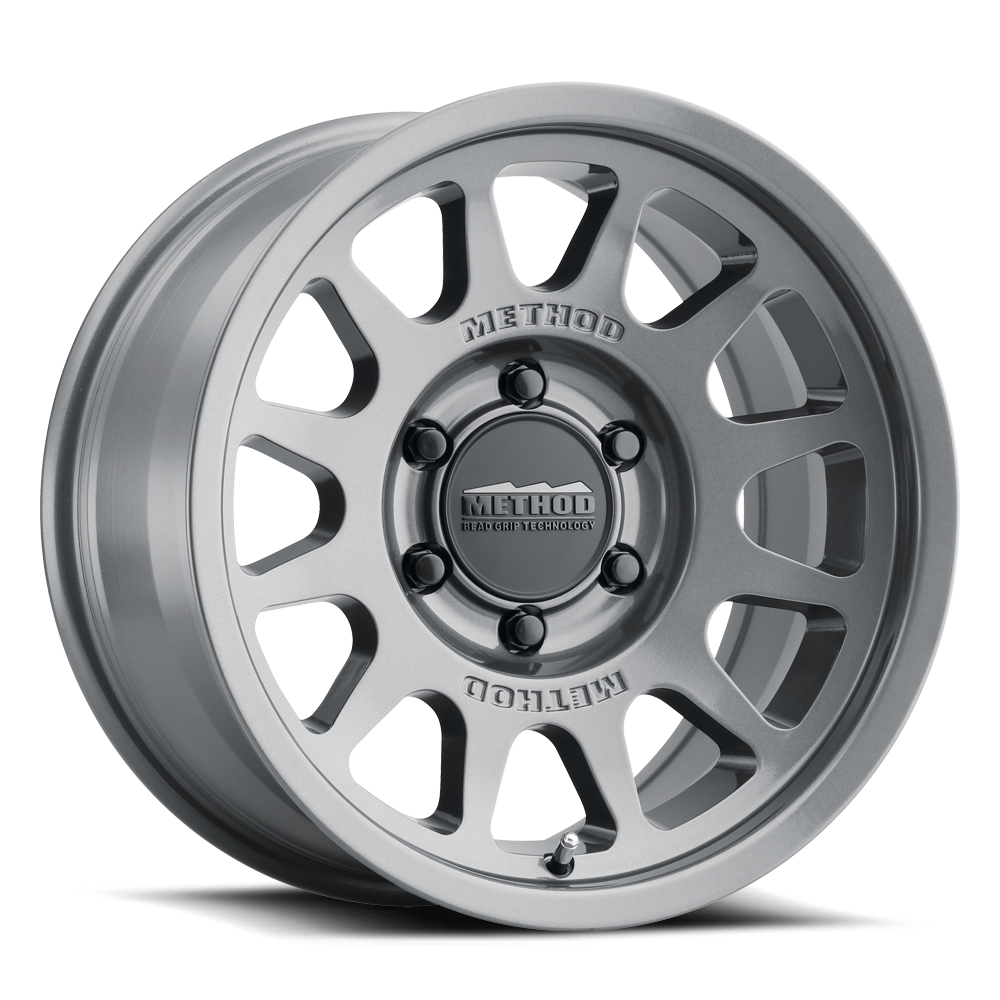

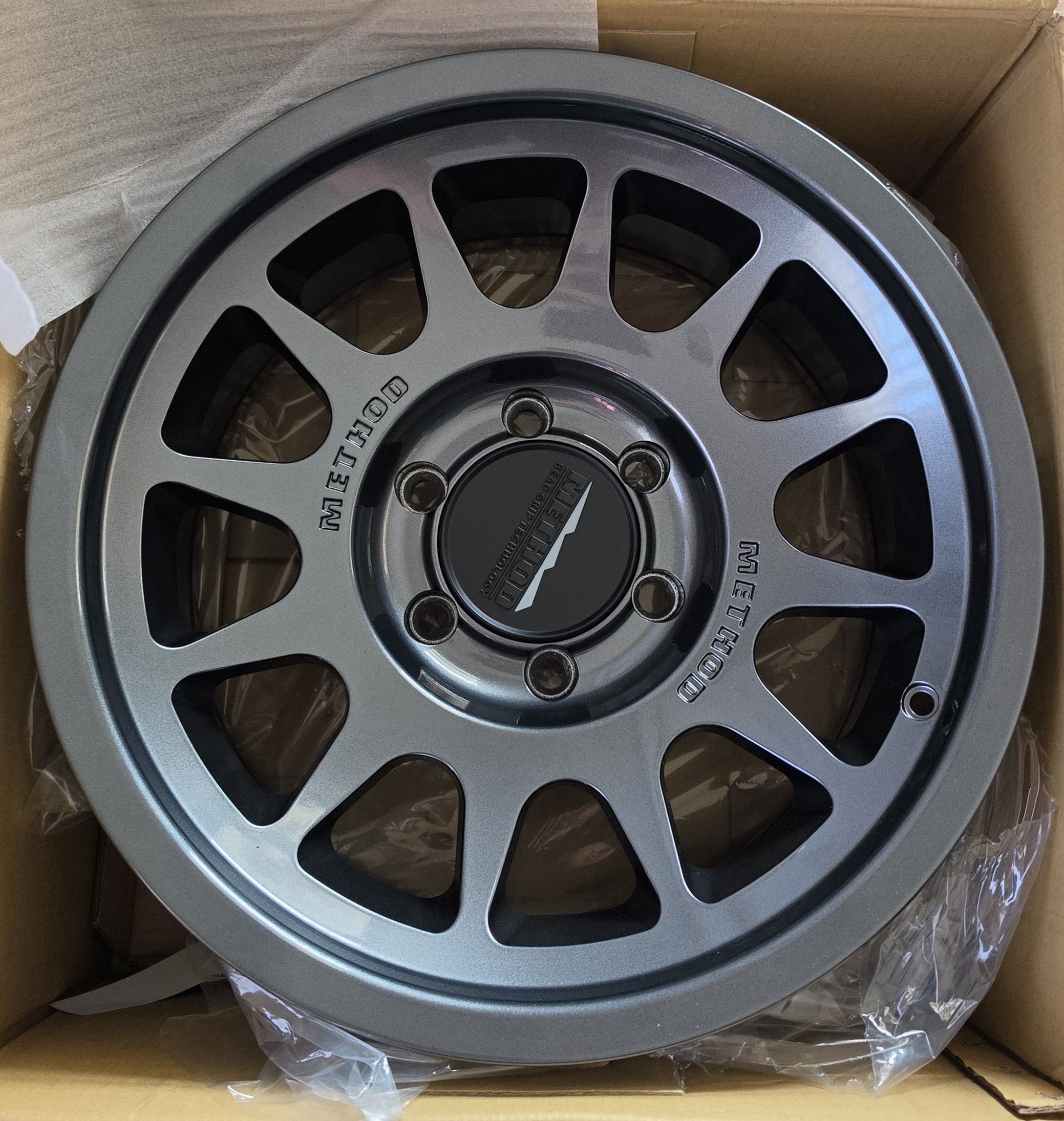

Haven't done anything yet, but these will be going on the 81 soonish (like in a few months) method 703's in a 17x9.
They're bluer than I'd like and what was shown in pictures online. Hopefully they'll look decent enough on the 81.
Their photo on their site

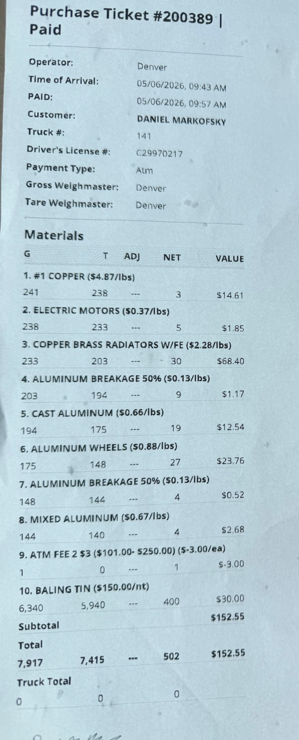

If your spring cleaning includes scrap metal, here’s what it’s going for today over at Atlas.
Those old aluminum rims and brass radiators are money! The copper was about 12 feet of three-quarter inch pipe. Money.

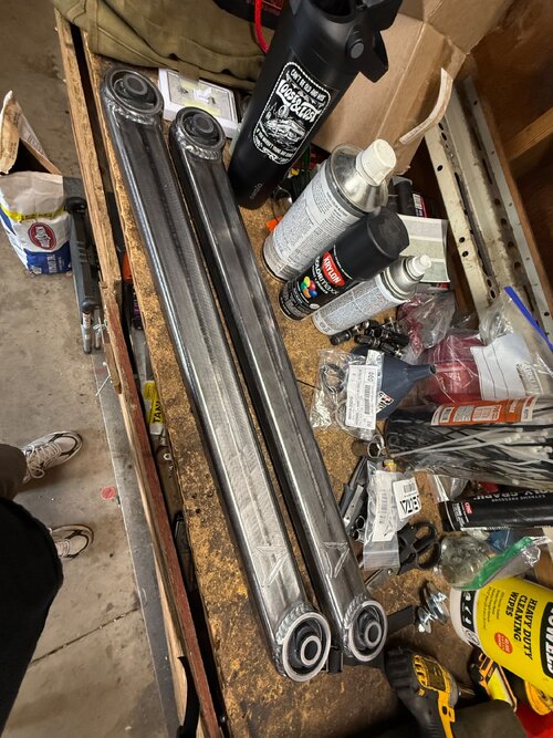

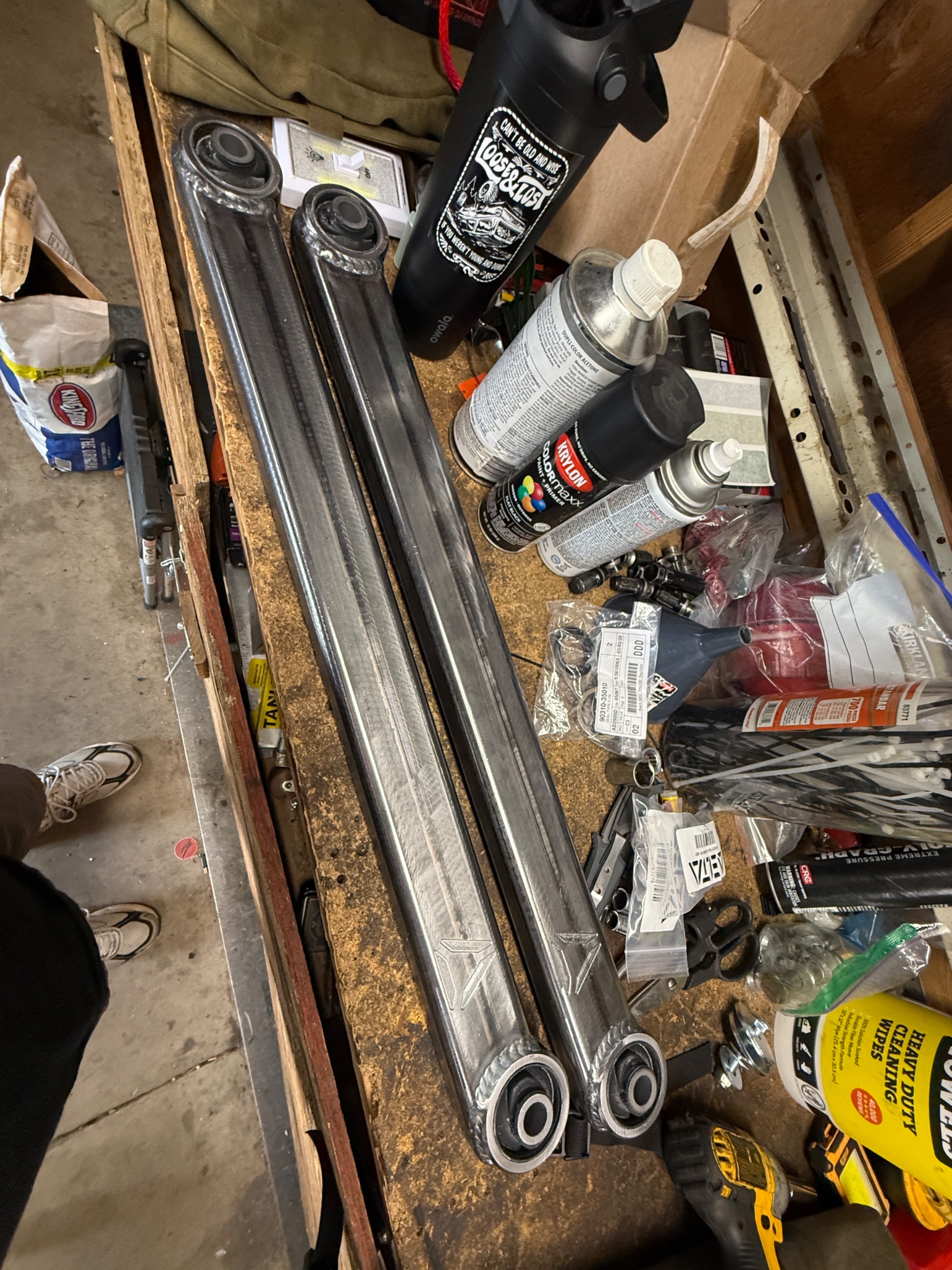

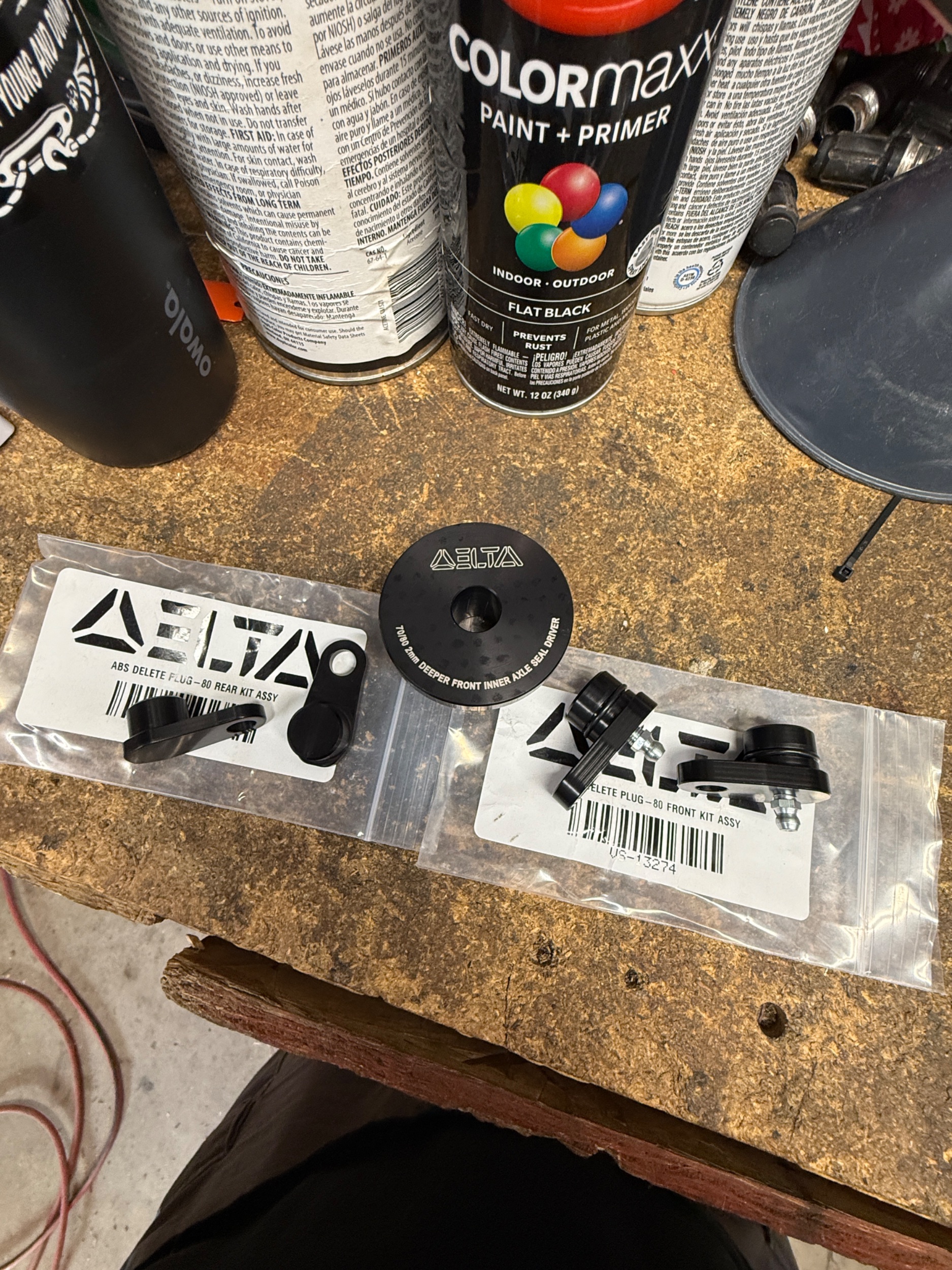

Got my Cruise Moab raffle prizes in from Delta!
Some serious beef on these rear lower control arms! Hope these will hold up better than others have.
I also got a few of those things that I’ve always wanted but never pulled the trigger on till now.
My brother actually won the 1500 dollar gift certificate, but gave it to me since he has no 80 or 100.

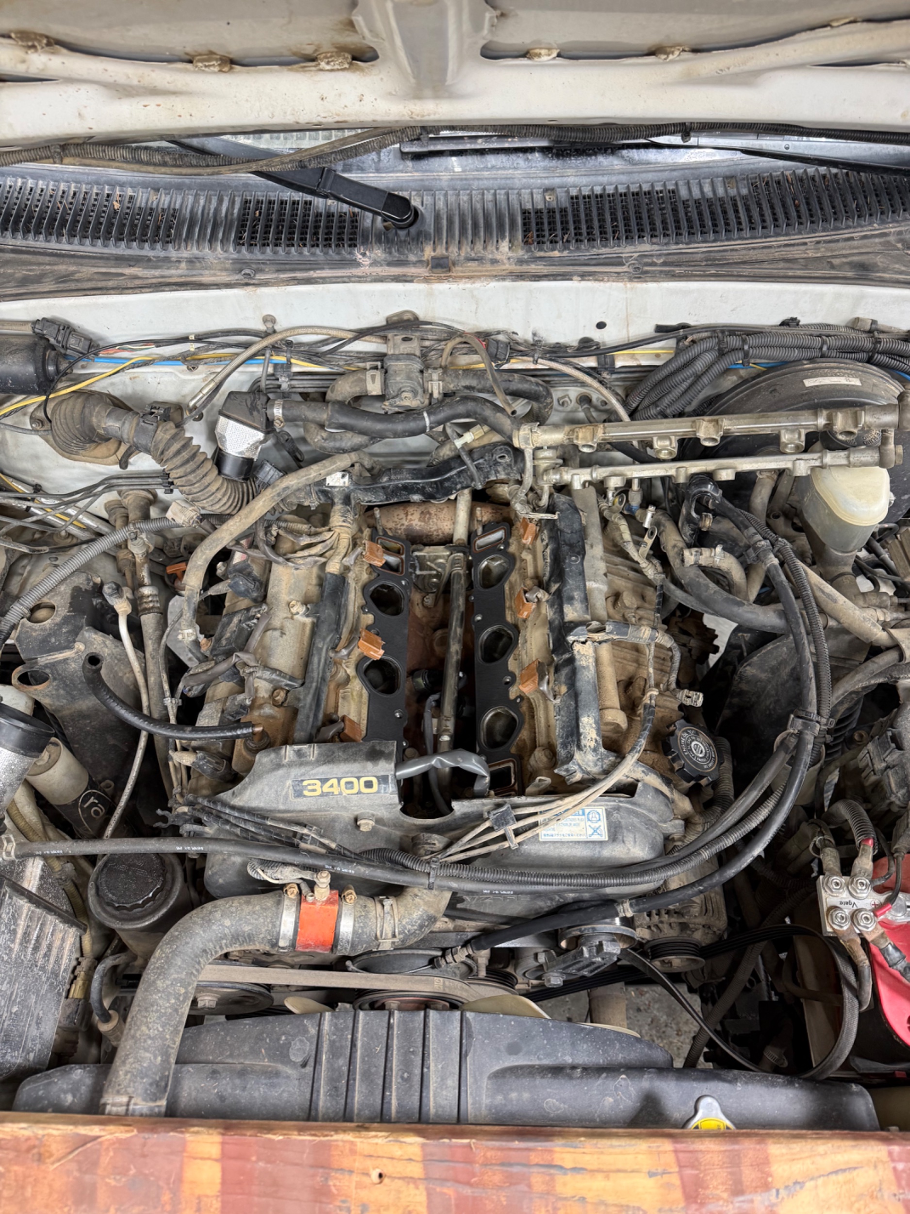

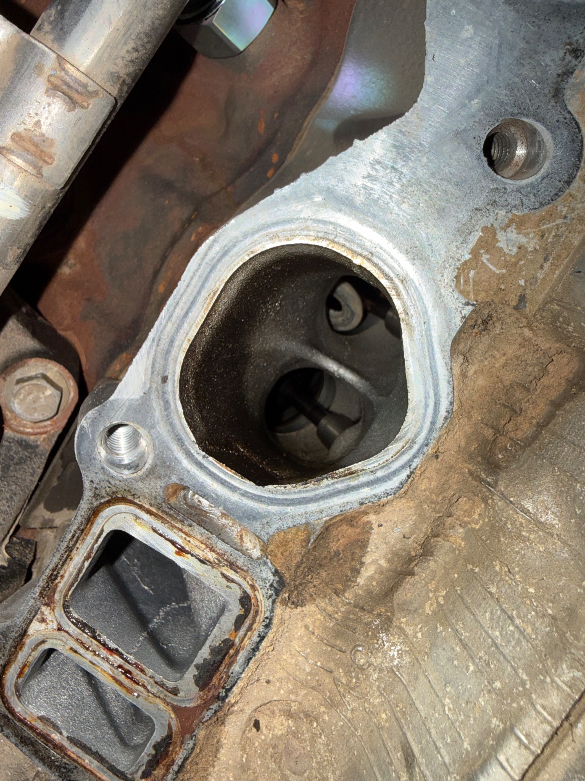

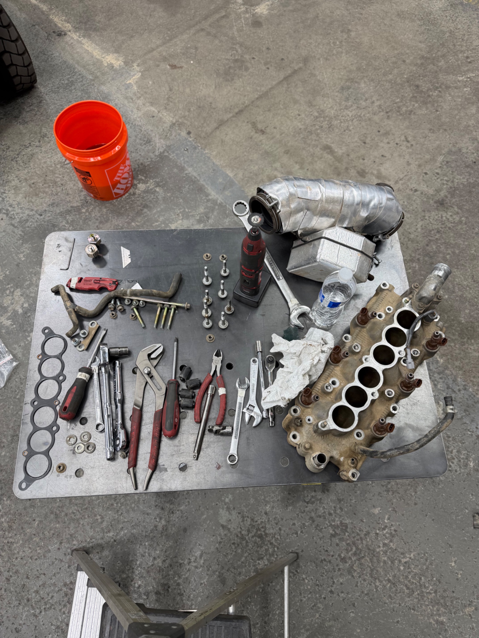

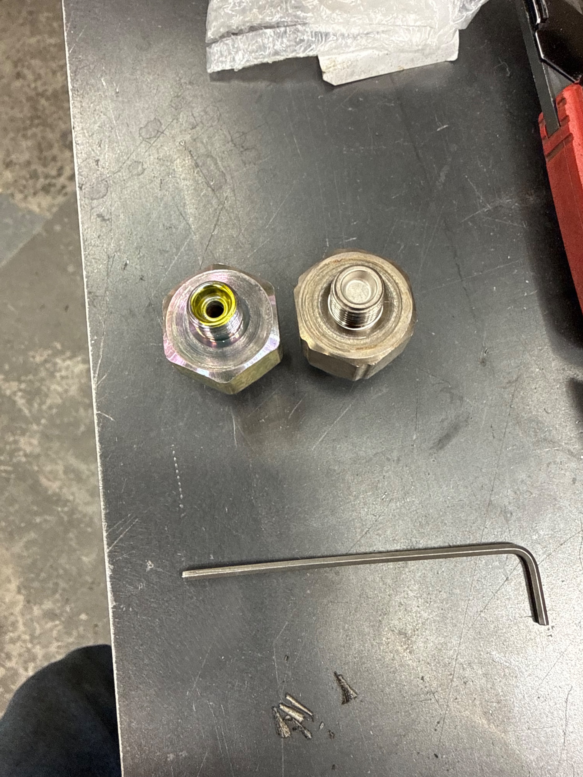

I ended up spending all weekend doing maintenance and repairs.
What started out as a plan to change the oil and relocate the steering stabilizer, ended up including a transmission flush and tearing the top off the engine to replace the knock sensors… again. This of course involves draining the coolant and removing the fuel rail to get to the lower intake manifold. Because heaven forbid we put knock sensors on the outside of the block. :rolleyes:
But I guess it was a bit of a blessing in disguise, as the lower intake manifold gaskets were apparently cooked.
I also had a VERY close call with a washer almost making it into cylinder 1.
Fun times.

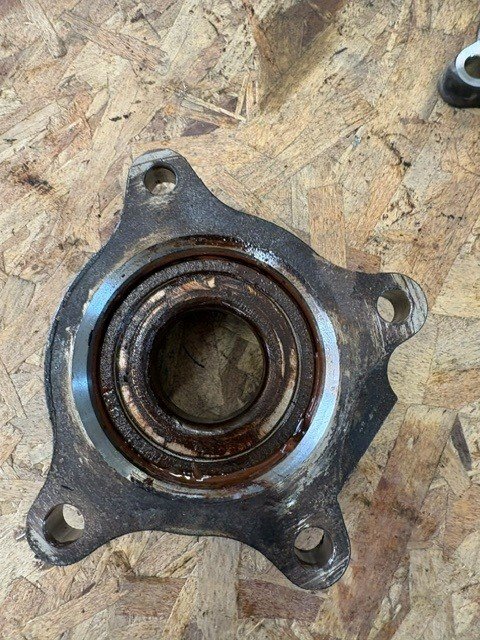

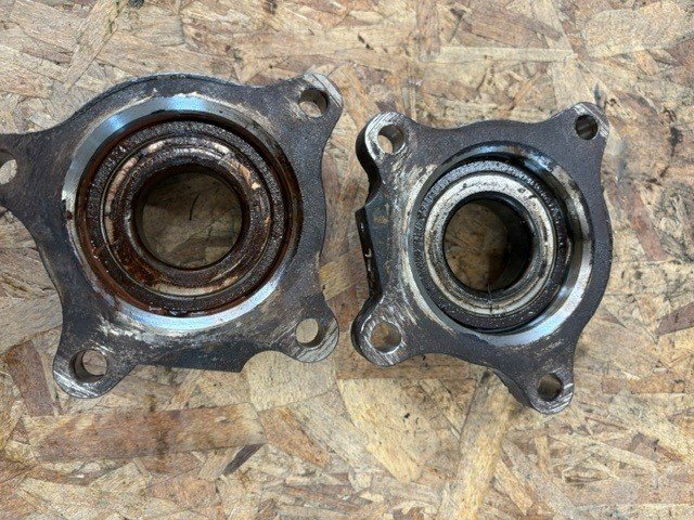

Spent Wednesday doing the rear wheel bearings on the FJ Cruiser at 170K. Not a fan of the limited space that the Toyota engineers give you to remove and reinstall the parking brake shoes on the inside of the rotor hat. The seals had definitely failed on the factory bearings so it is much quieter in the cab with the new bearings.

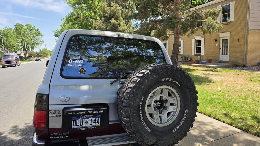

got the rear glass in the 81 today. Huge shout out to @LARGEONE for the glass!
It's kind of funny because the tint in the window has the cut out for the 3rd brake light and my 80 doesn't have it a 3rd brake light. It's truly only noticeable when looking in the rear view mirror
