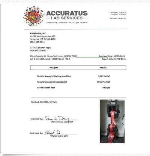

I have asked companies for their certifications and received a mixed bag of responses. I have called the testing agency on two to verify its real. Only forgery so far was Rhino USA
Forgery Certificate-2018-6-19 RHINO USA Soft Loop Straps - Black Ice 646437408493 eBay.jpg
Amazing they thought they could get away with that and with the Internet the risk to your business sales. But I bet it hasn't made any difference. It's all about the lowest price and color matching to your bumper.

Rhino never responded. I tried a few times.
The lab they falsified the test from specialized in medical disinfectant testing and tested zero straps and rigging products.
The new lab Rhino uses also never repolied to me, but at least their website says they test straps and rigging products.
