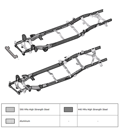

I don't know if anyone knows the actual alloys or done XRF but I've seen this picture floating around that I believe is the 3rd gen Tacoma frame. Maybe you M.E. types can tell from the tensile strength values what they might be?
IoN6
Sep 2, 2019
1,454
Not really enough for a definitive answer, but metals in those MPa’s are not hard by any means. Which is not surprising really.
You need ductility, or the ability to deflect and deform in a frame. A frame of carbide for example would be very rigid but it would likely crack after a few pothole encounters. Plus it would be heavy AF.
