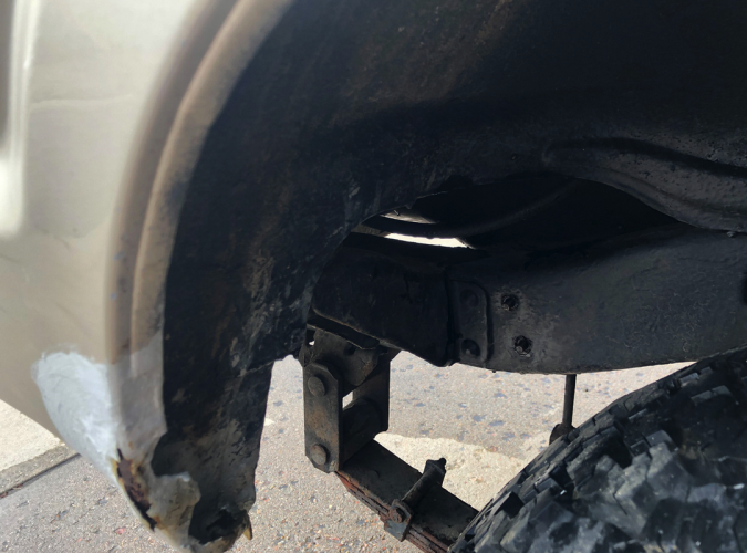

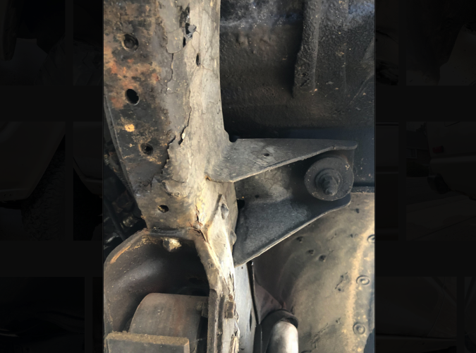

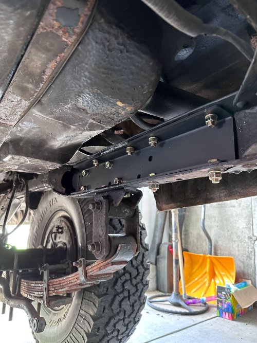

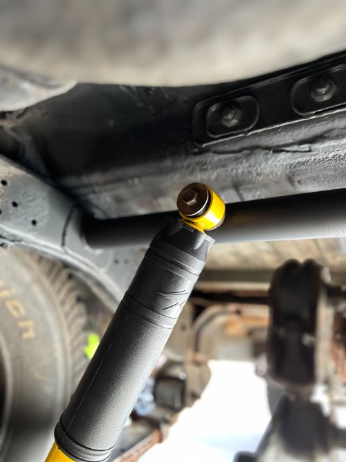

Am I drunk or does it look like the rear shock support tube broke off and was welded onto the muffler? I can't tell whats going on.

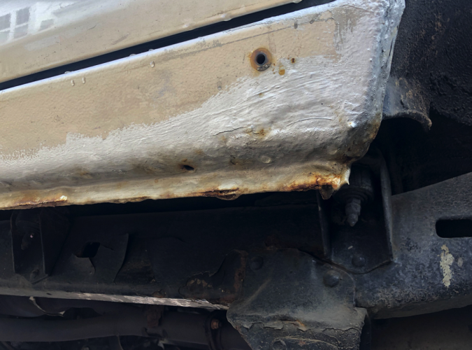

scary with all the undercoating sprayed everywhere. you can see the rust was pretty bad in some areas on the frame. enough that they jerry rigged a c channel in and replaced the shock tube. and why isn't the sway bar hooked up? i'd look that one over very carefully before purchase. at least he's not asking 25k

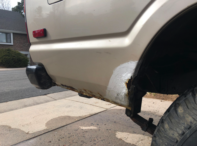

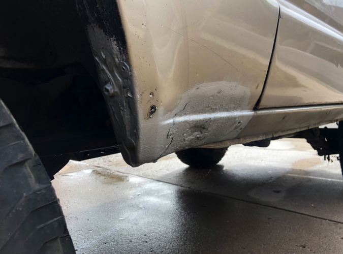

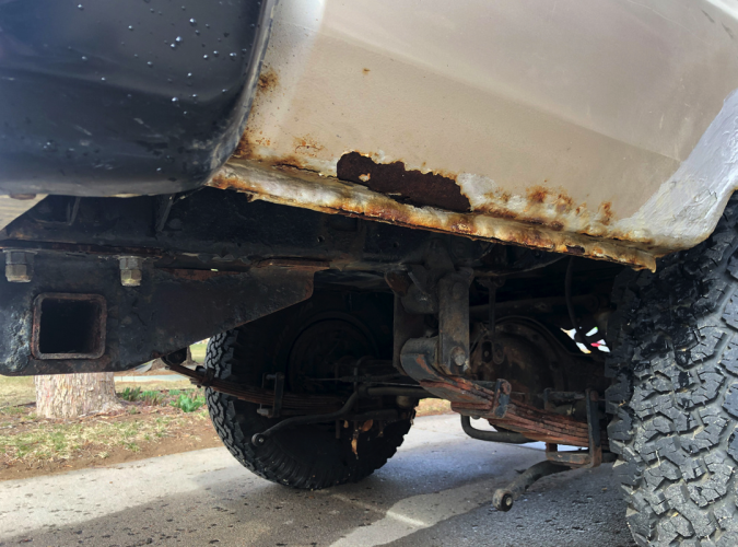

Yeah I just went through the full gallery and its a 4k truck. Lots of funk underneath and bondo spread like cream cheese on the rockers.
On 2nd look it appears the rear shock support tube is disconnected and the shocks are so shot they are sitting at full compression.
The C channel is a trail tailor product for extra support there on crustier frames. Those are also installed on my 60.

I considered this when it was listed by the same guy last year. He said he wanted to get it fixed first before he sold it. The photo link he shared is from last year before the work started. The two photos embedded in the add look like the work in progress. I would assume the framework will look better when it comes back on March 8th like he says. I wonder who is doing to the work though.

Before shock tube and frame pieces.
After

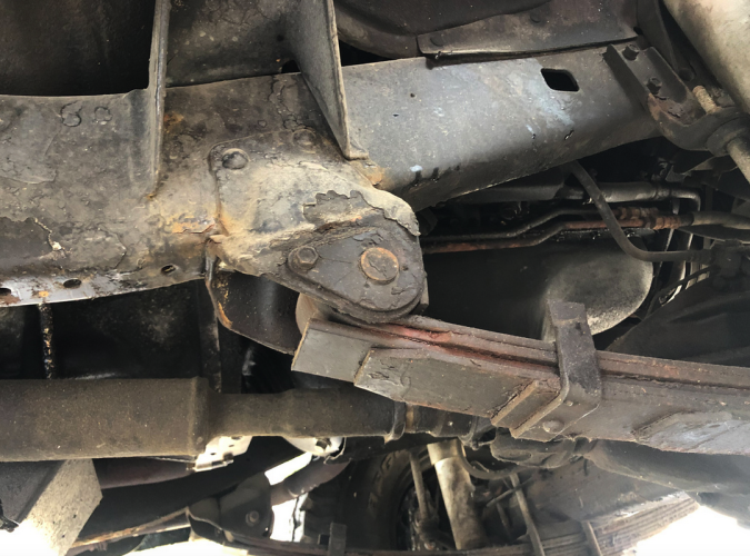

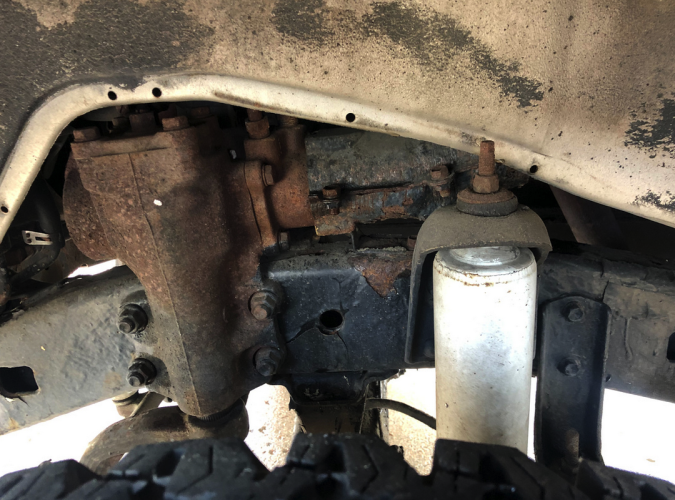

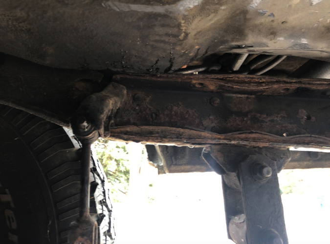

More photos. It's more than superficial. These things happen, it's an old truck and it's not so far gone that it's can't be saved.
What bugs me is trying to gloss over it but saying it's surface rust and always garaged implying it's an old granny's Sunday car.
It is what it is, no need to fib.
