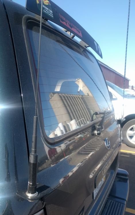

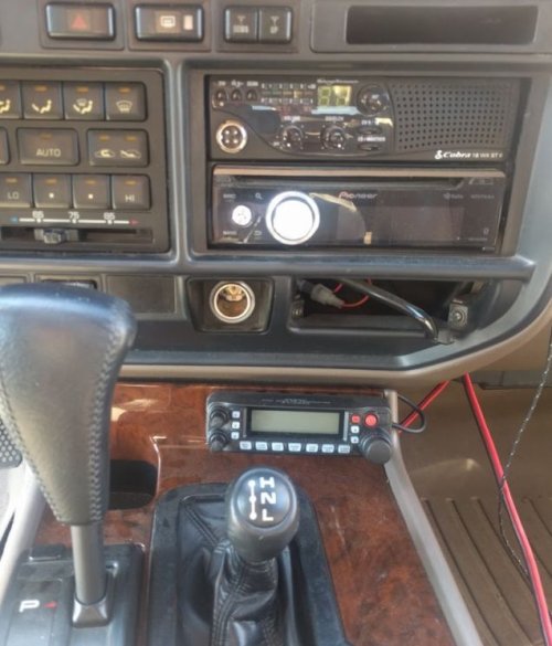

I run both a Cobra 18WX ST2 and a Yaesu Ft-7900R because I drive trails with lots of friends and groups with varying communications. I don't want to be the black sheep in a field of white sheep or vise versa. A properly installed antenna makes a world of difference on CB, but it's still not great. If given a choice, I'm 100% ham and I make sure to express my misery when we have to revert to CB.
