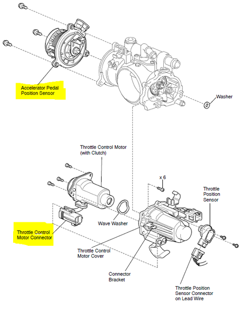

Hey all. Working on a project with a T100 and a 2uz. I've got a snag and I hope someone can give suggestions, input and more!
I have everything figured out except the electronics. The truck is drive by cable and the motor is drive by wire. I'd like to keep this project drive by cable if possible.
For further context, the T100 is a 95 with a 5vz and R150. The donor vehicle is a 2008 4runner auto.
The way I see it I have two options.
1: adapt a throttle body from a 1998 to 2002 2uz to my motor. The problem here is I'd have to bypass the motor power for the butterfly and another sensor and tell that to the ecu. The problem with this is I don't know how to work with the ecu.
2: I can keep the drive by wire but I'd need to run an electric gas pedal. I don't know what harness I'd need for that and basically everything for that.
What are all your thoughts? Are there more options I'm not thinking of?
