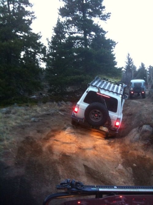

Nice IFS flex! :lmao::lmao::lmao: ;)
Oh, THAT'S the 'wheel stand spot' they were talking about coming down. I came up the hill late, just before you came up Kevin, and I don't remember doing anything like that. Maybe I took a different line being that it was dark. Or it's possible that IFS without sway bars flexes some place between a solid axle with and without. Shrug.
10,771
you took a different line Dave, you went up the right side and most everybody else went up this (left) side (you weren't avoiding the left side as far as I could tell, it mostly had to do with the fact that you were shedding/reorganizing passengers with another truck that was sitting on the right hand side).
Hole.... :eek:
