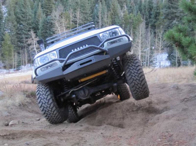

I wish I had brought the Prius Nak said could make it because it only got worse from here. When your spotter says to stop posing and drive out out it....then comes running down the hill to grab the bumper.... that's funny :hill:

WOW wish i had a shot of mine when i did it. All i remember was the passenger fender reaching the sky.
Nice IFS flex! :lmao::lmao::lmao: ;)
