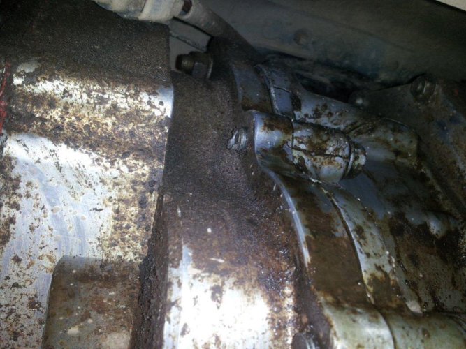

The JadeRunner let me down on the trail for the first time in a big way Thursday night. My mini truck gear driver tcase that mates with the Marlin split open. I was shifting it out of low when it happened. You can see the crack afgter Dan and I unbolted it and pryed it back together the best we could.

We dropped the rear drive shaft. I had just begun to drop down the more difficult section of the road when the breakage occurred. So up one little ledge and it was smooth sailing all the way up to the car dolly with Marco’s 60 pulling me. Once at the dolly, Steve (Rckhound) fortunately noticed Marcos front leaf spring was broke. Marco had thrown in some welding rod and with his dual battery and two set of jumper cables he was able to weld it up. Add some bailing wire and my gorilla duct to be sure and we were on our way. His 60 pulled my runner just fine. Steve had his wife Amy and friend Phil with them. They stuck with us all the way to Dillon where they were from. They were lots of fun and we all had dinner and went on our way. Marco’s V8 was straining up the hills but soon had the JadeRunner put to bed in my garage.

Thanks. I need to call Marlin and see just what kind of tcase I need. I thought mine just was a mini truck gear driven case. I see the tacoboxes they sell now use a hilux gear driven case. So I need some schooling on this since mine is an older tacobox adapter of theirs.

Hilux is the same as the early trucks for all intents and purposes. However, you almost certainly have a 23 spline input into the reduction case: IF the input gear got screwed up, you will need a new one of those, and they are difficult to find at a yard, but can be had from Marlin or others for a few hundred dollars. They only came in the turbocharged trucks from the late 80s, behind the 5 speed R151 transmission, if you decide to go to a junk yard looking for one.
If your internals are okay, then all you need is a new case, which are a dime a dozen. I've got a couple you can have, gratis, and it sounds like Travis does as well.
You will need to pull the cases and count your input splines to make sure of what you have. If you have a 21 spline input, those are super easy to find. I doubt it though. Most everyone puts 23 behind the 3.4.
I'm curious: how is your set up mounted? Do you have 2 mounts (one on the trans, and one on the reduction box?) or are you just using the factory mount? I'm trying to put duals in my truck, but that breakage is kinda scary.
