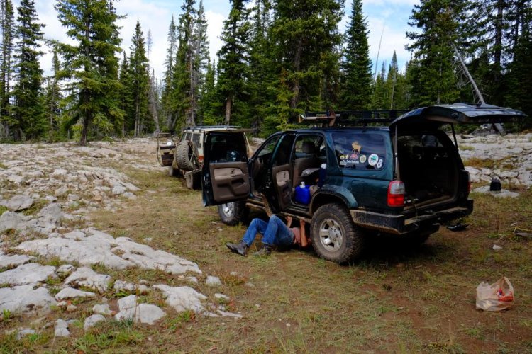

I'll let Marco give the story, here are some pics that I wanted to get up because I'll be on the road tomorrow.
The trail was pretty technical the last 4 miles (for me), so all pics are from the mellow areas. We were all anxious to get Scott's rig to the road, and athough there were lots of great potential photo/video op places we didn't take any. There was work to be done.
It was an adventure, and my first time actually meeting members of the Rising Sun club. Seems like a great group, you all are lucky for the camaraderie!
From the Flattops today, back to the Flatlands tomorrow for me ;)
John

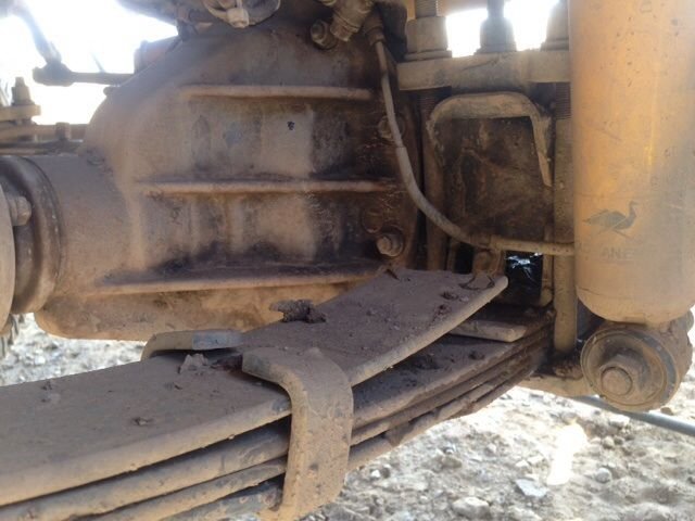

Fixing Marco's truck after rescuing Scott
Found this after we pulled the jaderunner on the tow dolly.

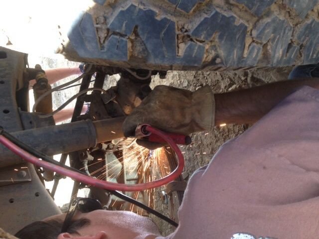

Main leaf weld
It was the main leaf so we needed to repair it to keep the axle lined up and in place so we did a little trail welding and repair.

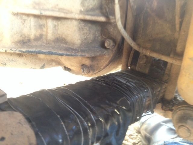

And for good measure.
We wrapped the welded leaf in several rounds of bailing wire and topped it off with some duct tape. Made it down a 25 mile bumpy road and is currently on its way to Denver with no problems!
