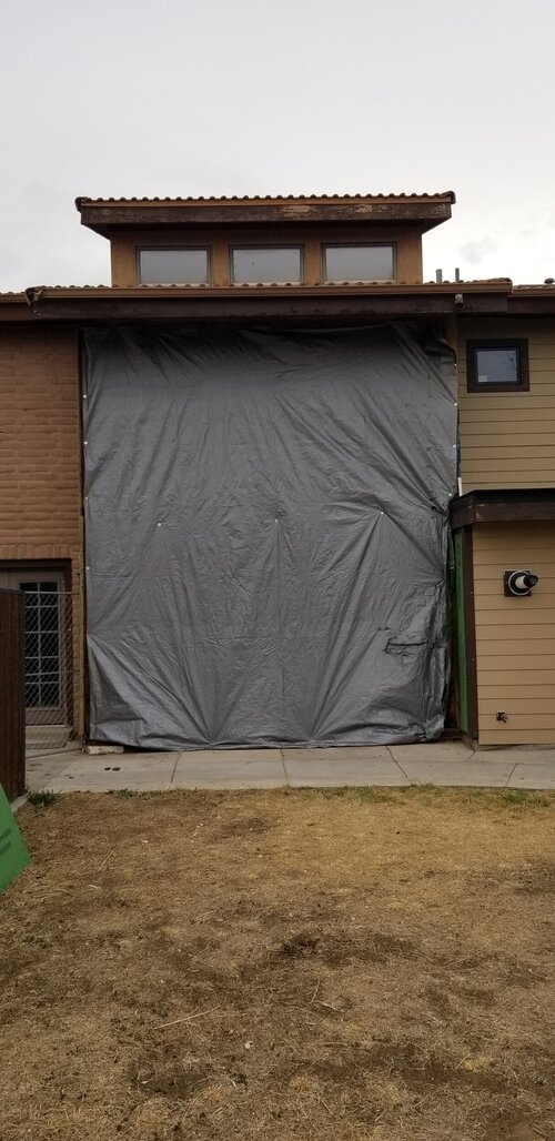

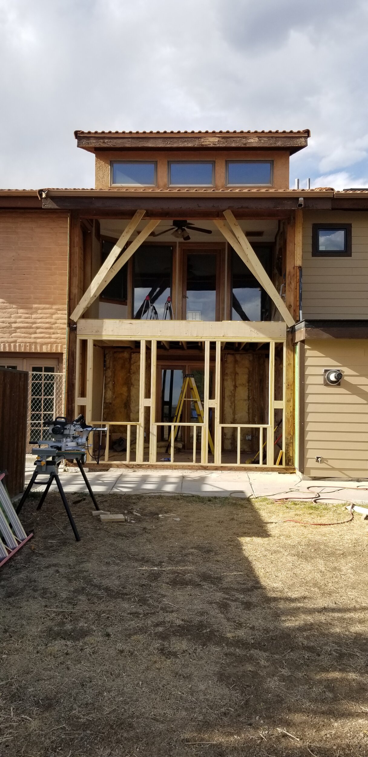

My back is acting up again, so progress is slower than I'd like. But since Tuesday morning, got majority of the structure demoed. Then went and picked out the needed lumber (that took a half a day alone 🤬). Took the new 7 windows and one new door out of storage. And then added some corner gussets to support the main header beam. I need to remove the 2 middle posts and their lateral supports. Then install the lower/basement 2x6 wall I built. But am done for the day, and it's supposed to rain tonight...

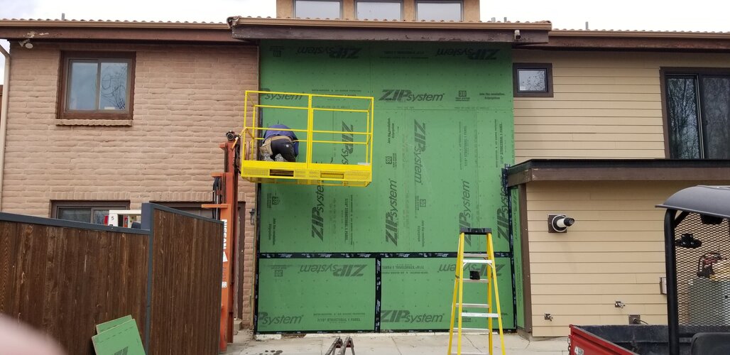

Took the weekend mostly off to help the back recover some. But got right back at it this morning.

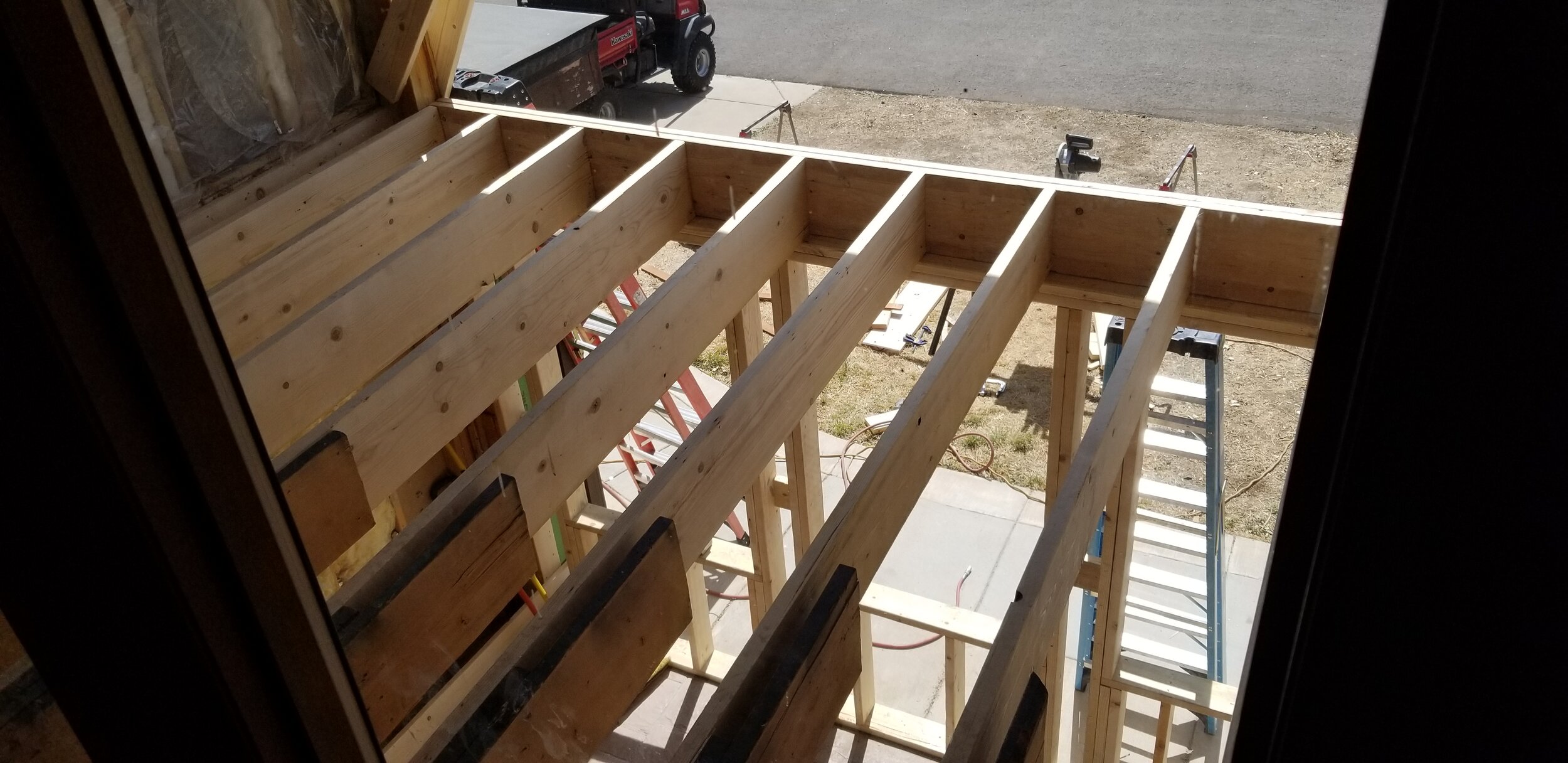

Got the rest of the posts removed. Stood the basement wall up and fastened it in place. Figured out joist placement. Then ripped all the floor and rim joists down to 11" as that is what the existing were. Threw those up and fastened them into place.
Ran to the store to get subflooring and sheathing materials. Then started laying the subfloor by gluing and screwing it into postion. No future squeaking to be had!
Tomorrow we should finish the subflooring and at least start on the upper wall.

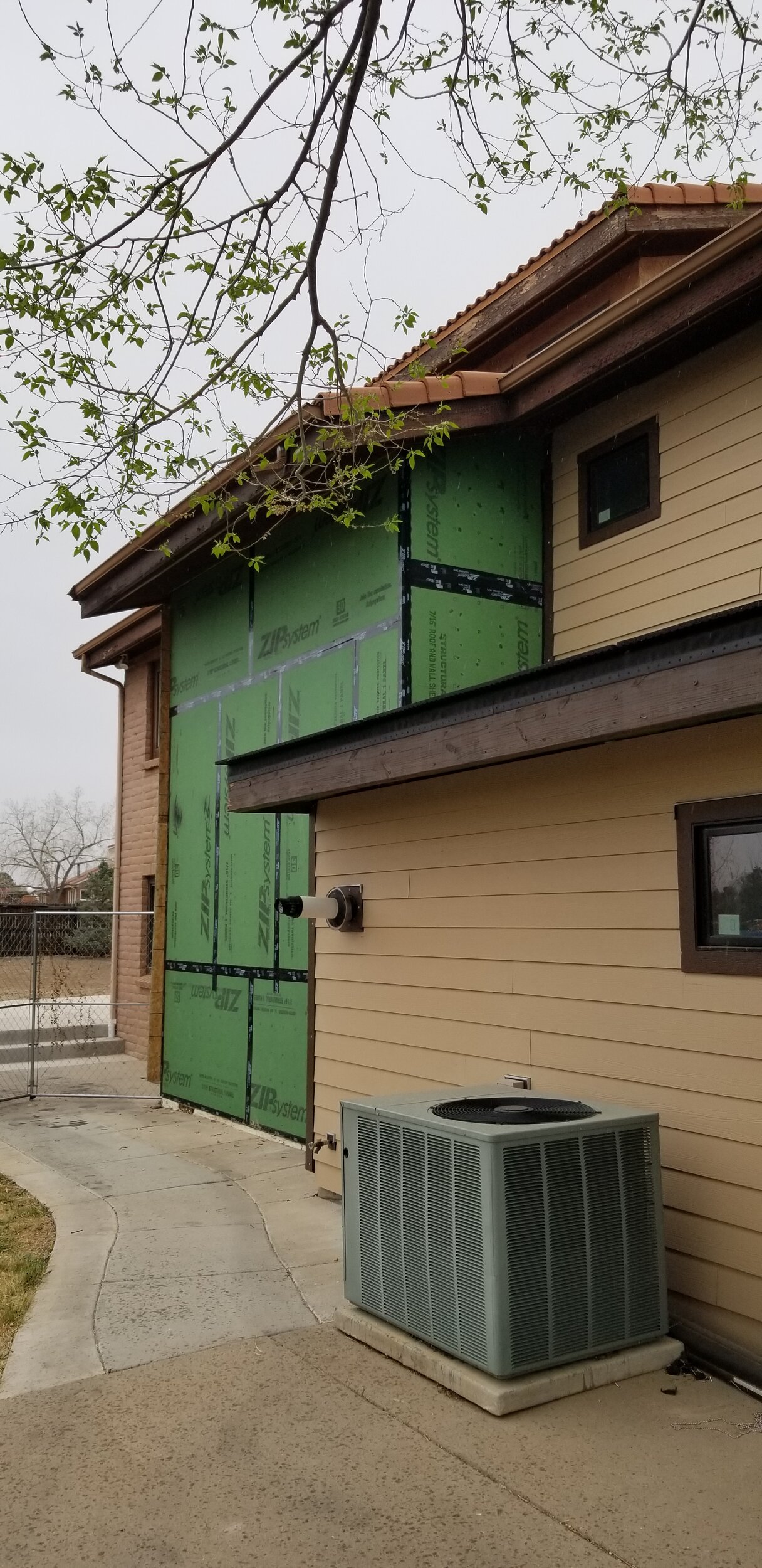

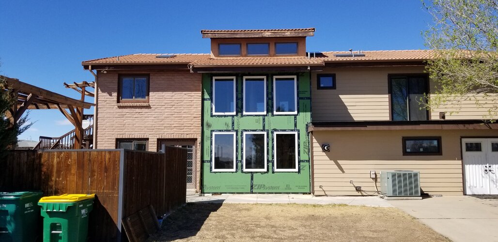

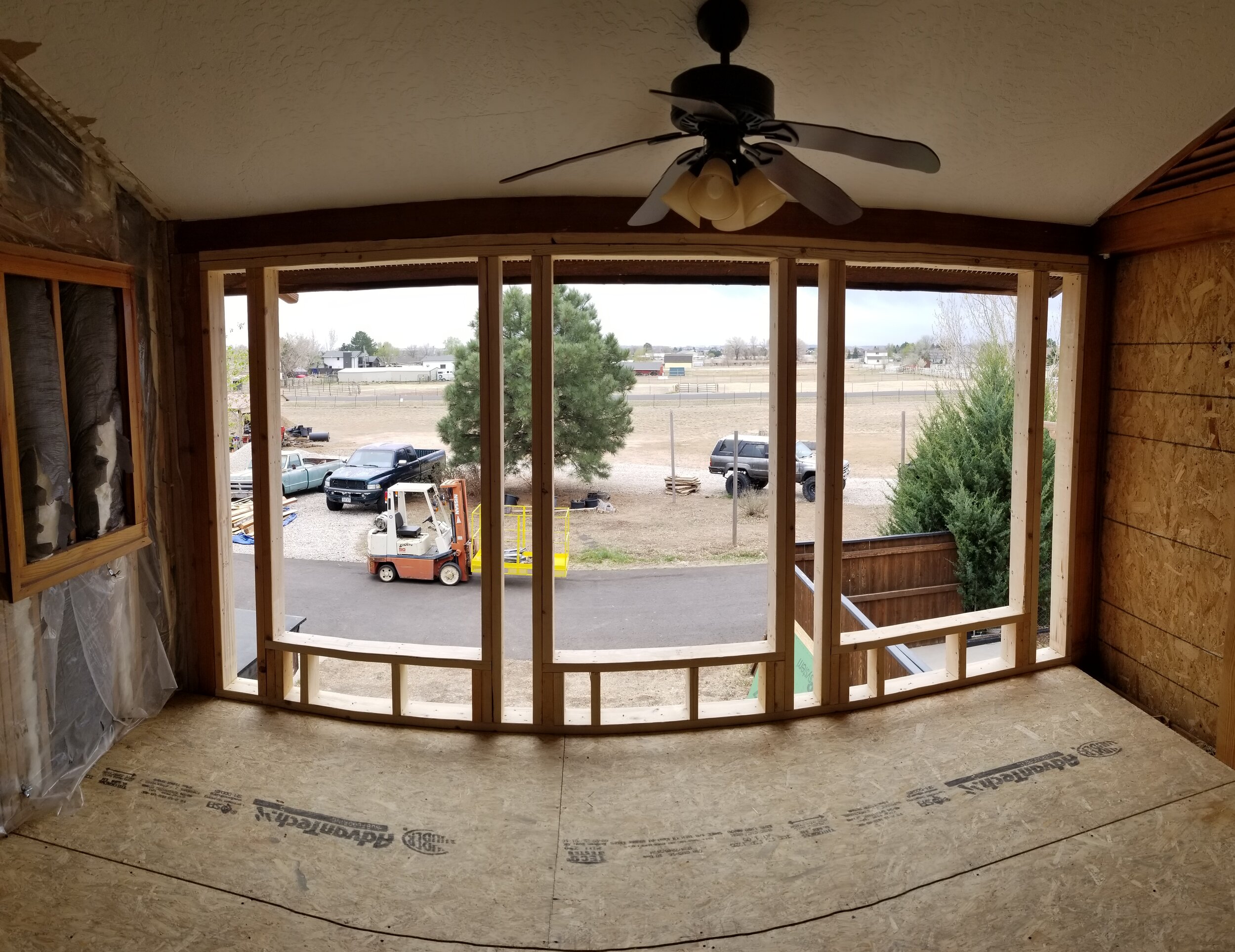

Got the holes for the windows cut out. Waterproofed the windows sills. Installed 6 of the new windows. Then sealed them up with flashing tape. Just need to trim them out and add siding and the exterior section of this wall will be finished.
Next week we start on the small section of the west wall in the same area that needs the same treatment.
